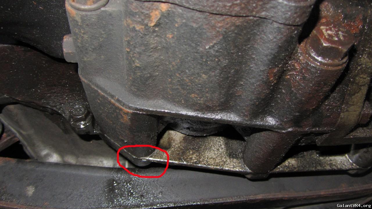

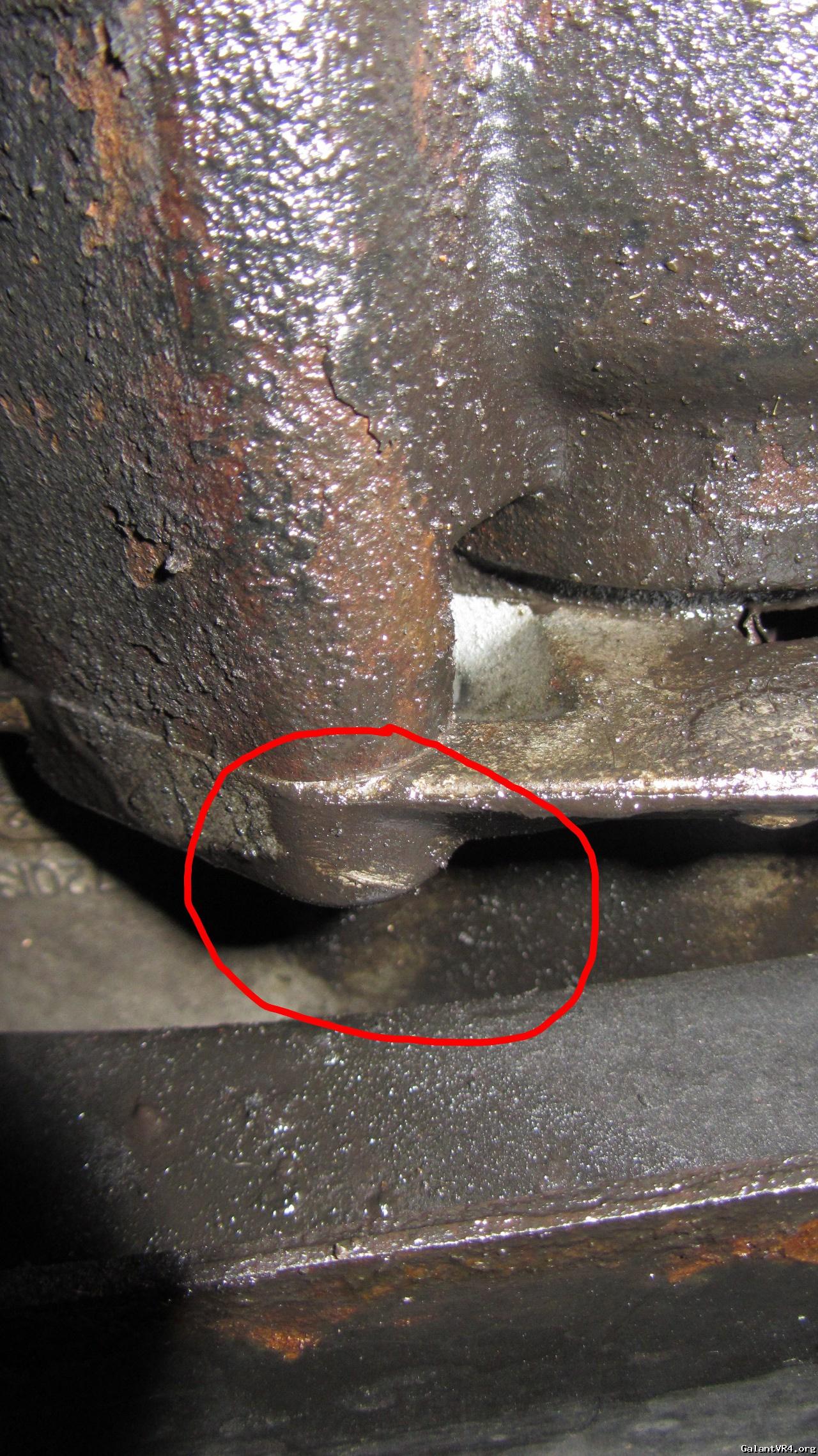

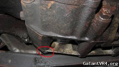

I think I found a missing one from the rear of the trans to the t-case. Here are some pics. Is this where PNC 20999Q - MD706012 is suppose to go? The diagram just kind of shows the bolt floating, so it's hard to know where it's suppose to go. I haven't had the transmission down for a few years and I feel like I've forgotten everything.

Nope, all 5 bolts that hold the transfer case to the trans are coming from the driver (left) side of the car to the right side.

The one you're looking for will be near the tail of the T-case. Near the axle shaft.
Might be better off just dropping the exhaust and Tcase. It does go the way the tcase bolts go, but it's a small 12mm head.

The rear transmission bolt was missing. I got it back together, but tomorrow I'm going to change the t-case and rear diff fluid, fuel filter, and give it a oil change before I take it out for a spin.
