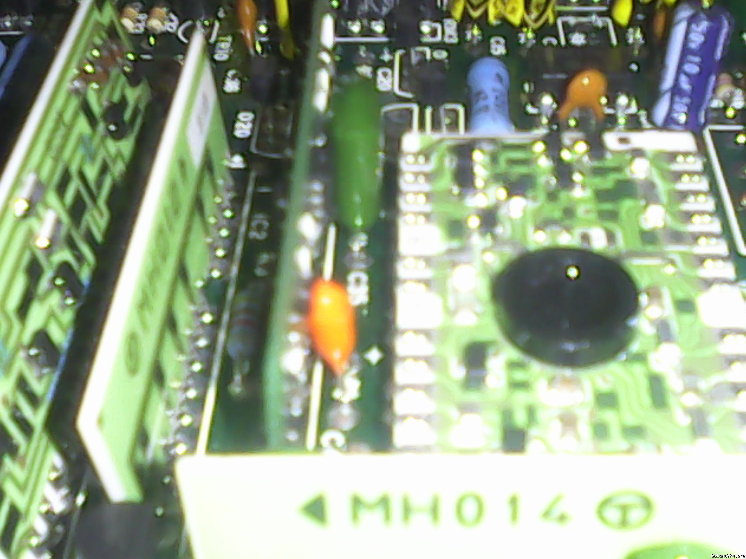

Let's start with some information about your car. Year, original market? Also, post pics of both ecu's with and without covers so we can see part numbers and the boards. Also, cases can easily be swapped so the part number might not mean much.

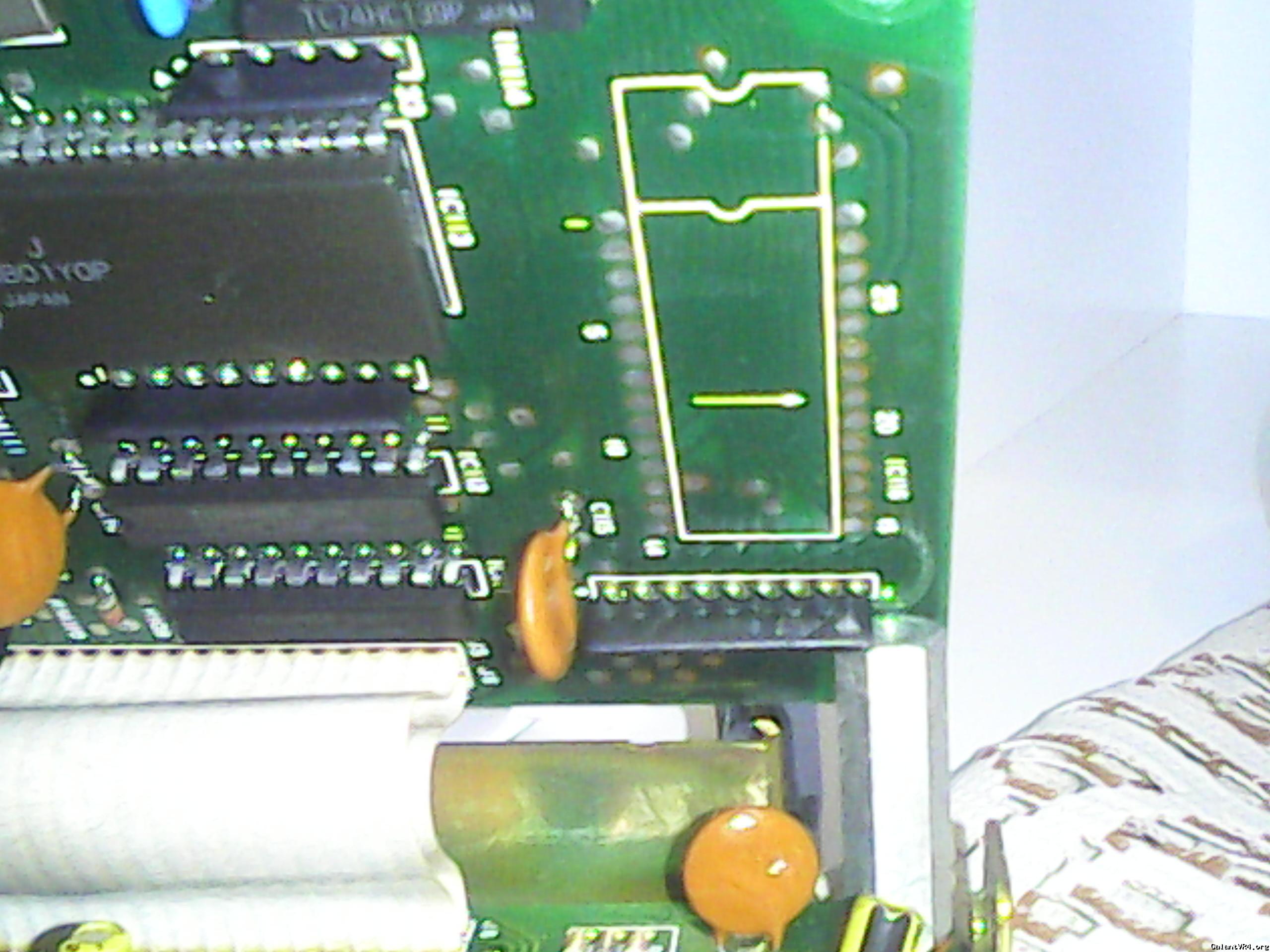

Pics of the 1g cover off shows the ECU side white connector and motherboard serial number. One is 0878M and the other is 6576E, letter E = EPROM and 6576 = last four digits of the ECU model type.
And here is the link for determining which ECU the four digit number equates to: click
Use the E2T* number. It also has the FWD/AWD/CA/Federal resistor configuration ( R129 and R130 ).

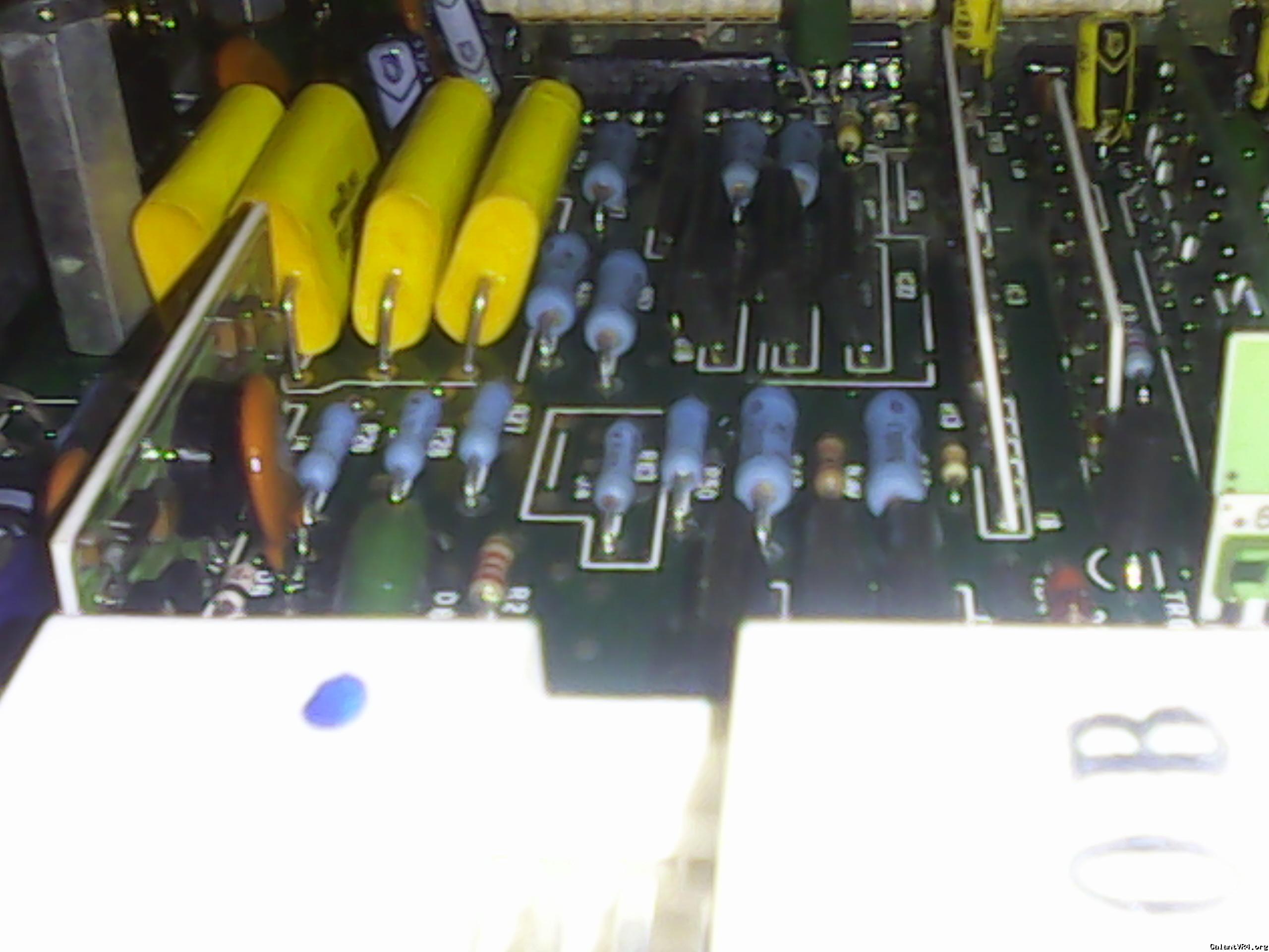

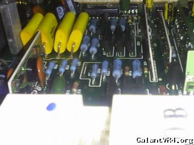

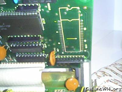

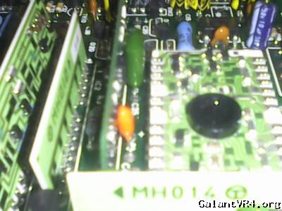

these are a few pics of the ecu,its the older version dual board,this is the replacement i bought,it has md 128618 on the cover but is not identical to the other i have on the car.
Like i said ,this one wont turn off when you shut the ignition off

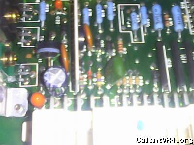

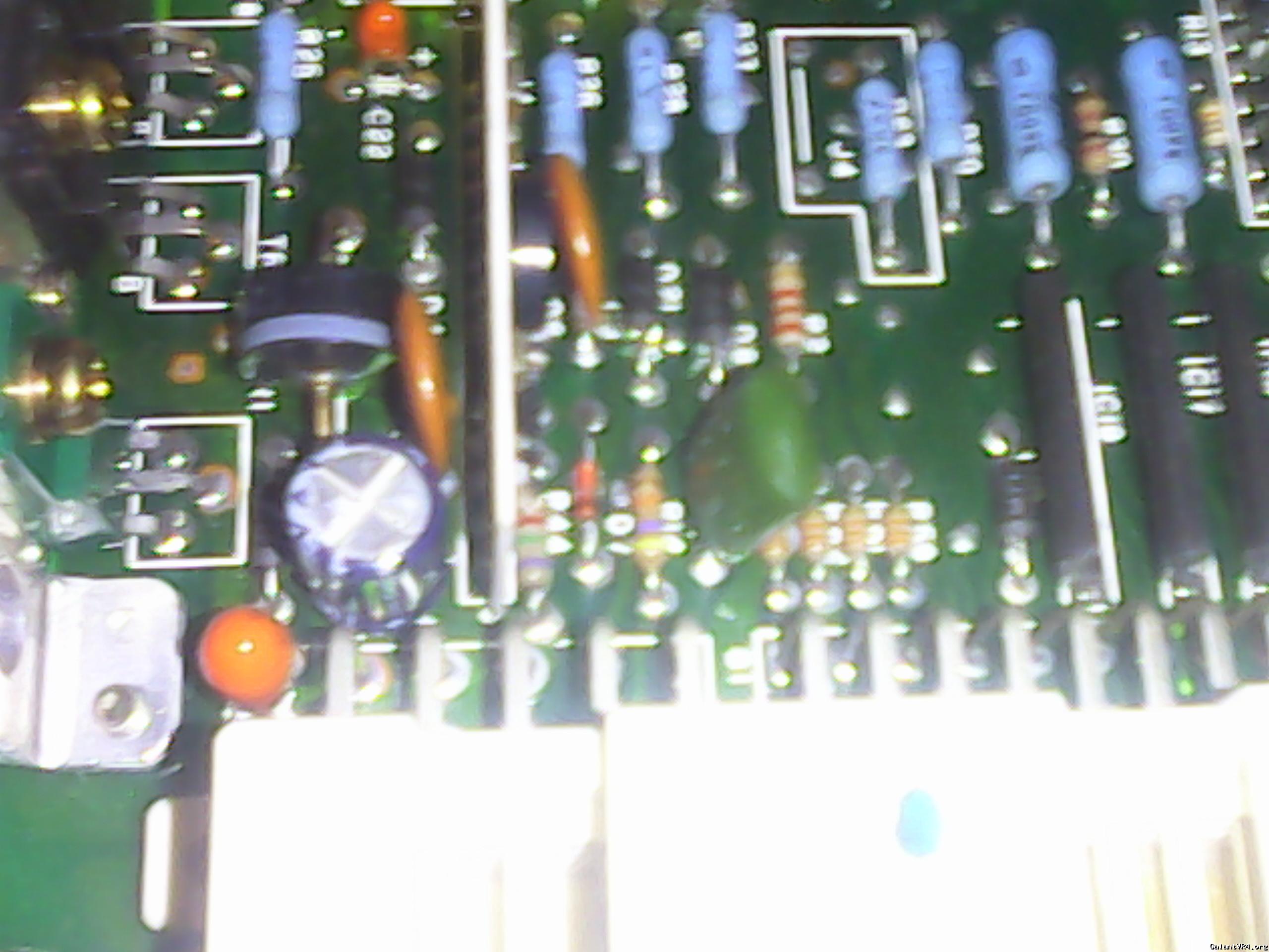

the second pic is the ecu that came with engine...the replacement doesnt have the sort of chip or whatever it is that has e 657 on it.
i know the dual boards cant be chipped,...all i want is a running ecu to see if the stall is caused by a faulty ecu.i dont want to swap my maf before i swap the ecu just in case the ecu is making it go bad.........please if anyone has any ideas i would really appreciate it /ubbthreads/images/graemlins/bawling.gif /ubbthreads/images/graemlins/bawling.gif /ubbthreads/images/graemlins/confused.gif

MD128618 shows up from my listings as this:
MD128618 1988 GVR4 JDM MT E39A E2T33372 E657 J-Spec Dual Board Eprom/Non Eprom - 195hp
Confirmed in ASA as being an early E39A option for an ECU.
