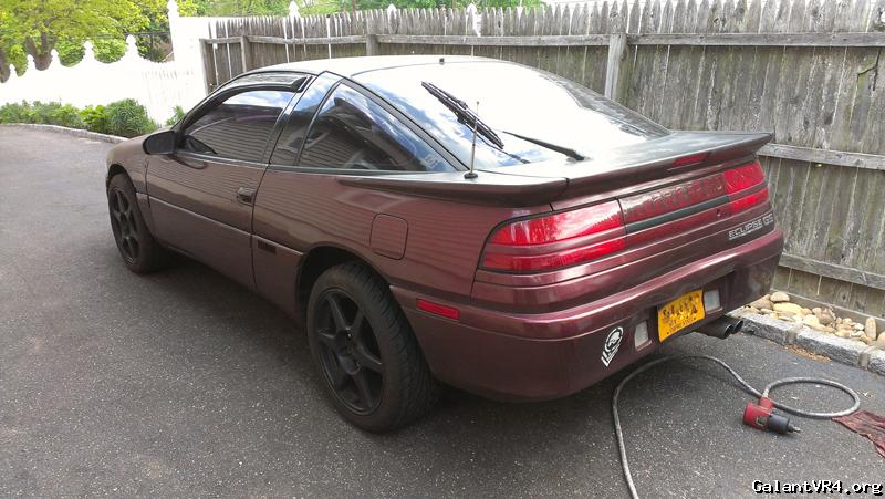

I currently have awd tel gr2s and stock uncut Gsx springs on the front of my daily driven 1991 fwd nt eclipse, with fwd rear gr2 shocks and gsx springs. Ride is good over all but The front sits higher than it should. I guess its because the fwd rear shocks in the back are holding down the Gsx springs. I'm going to use the ground controls in the front of that eclipse and put the gr2 tel spring on the Galant. and the gc coil in the rear of the Galant to hopefully get everything level.
or maybe full set of gc's on galant if part numbers are close enough. Ten cut the ggsx springs in lower the front of my eclipse.
I have never tried to cut a spring before. What happens if you cut from the top and from bottom of a spring? Can you preserve where the beginning and the end align with the spring perches this way? Another question I had was it possible to cut a spring horizontally? My thinking behind this is it will lower it a little more but overall length will stay longer and it would be less likely to move if the load was taken off of that corner.

Yeah it's not a good idea. I put the front gc's in my eclipse to even out the ride height. I don't really like them too much. I don't want to use them on my galant for a few reasons. There's an allen nut stuck in one of them so its at a fixed height. They make more noise than I would like. They are just a used set i had lying around. I may swap in the rears gc's I may not. Either way the one on the driver side had to be set way higher than the one on the passenger side to even out the drop, and that was without my ass in the driver seat.
I agree about the cutting of springs, thats why I have never done it. I figured if i started with a bigger than stock spring it might be different.
