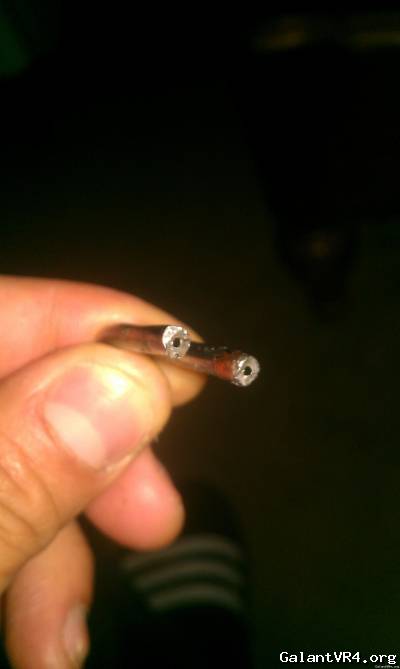

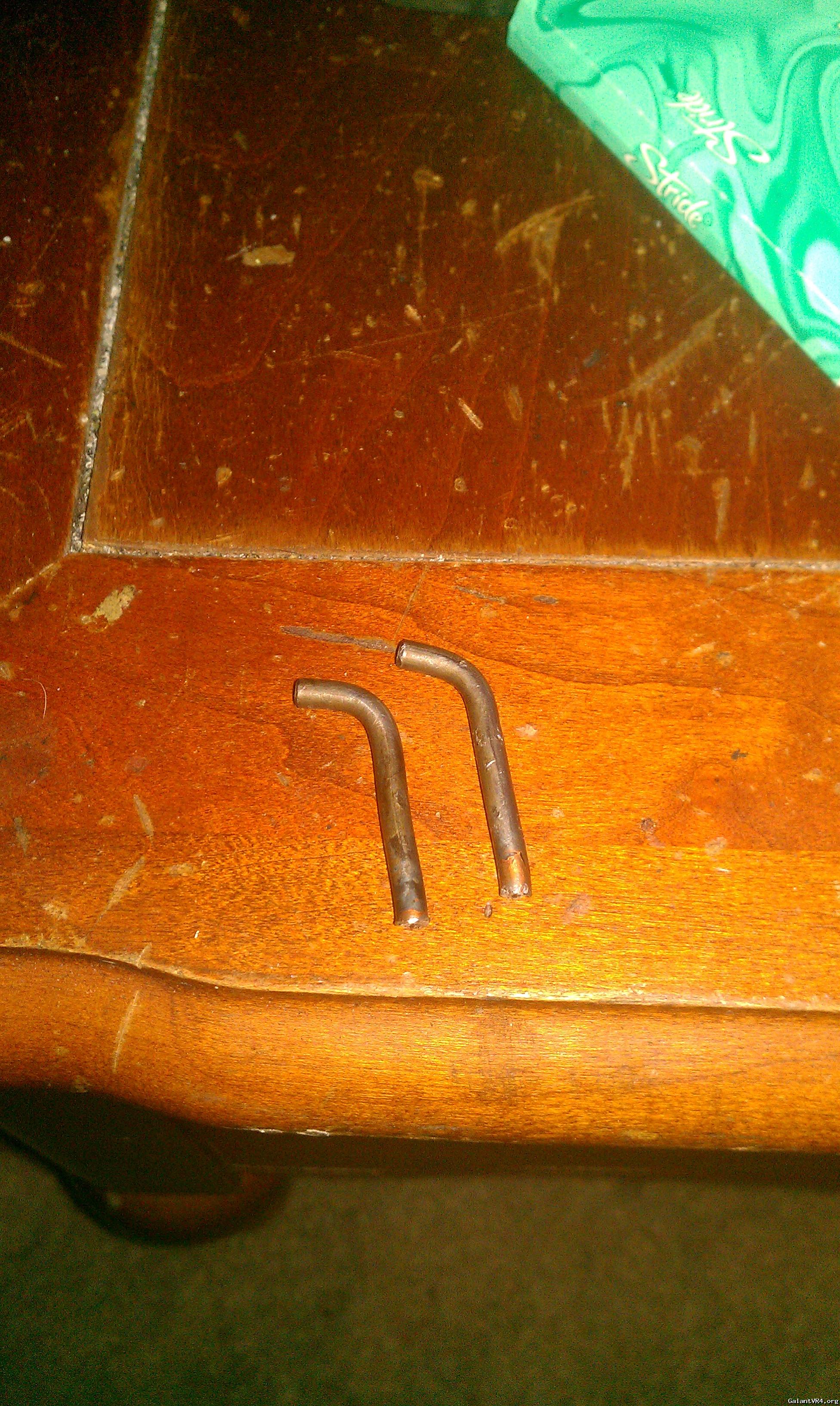

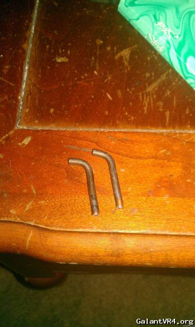

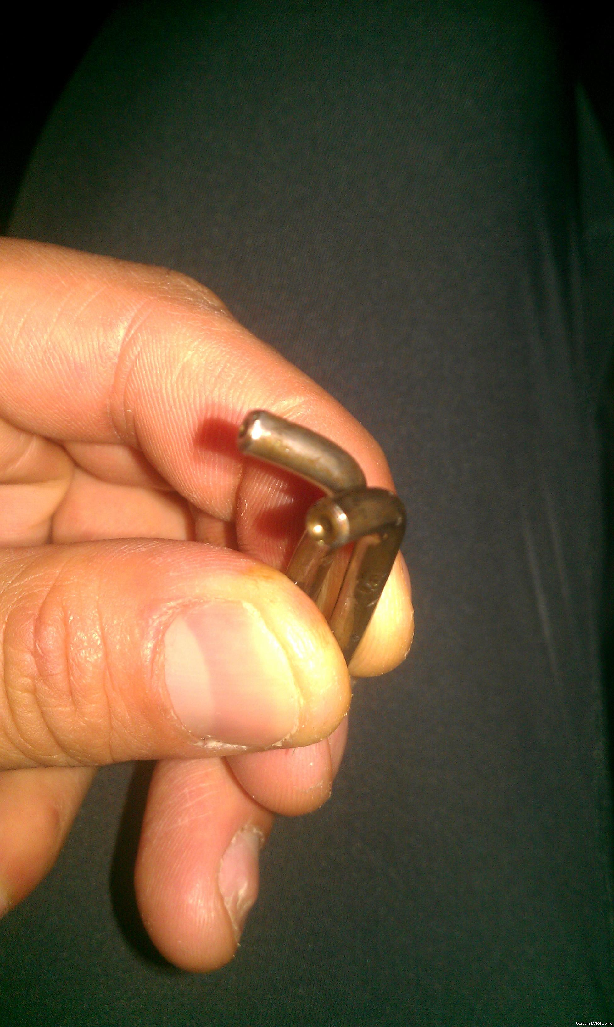

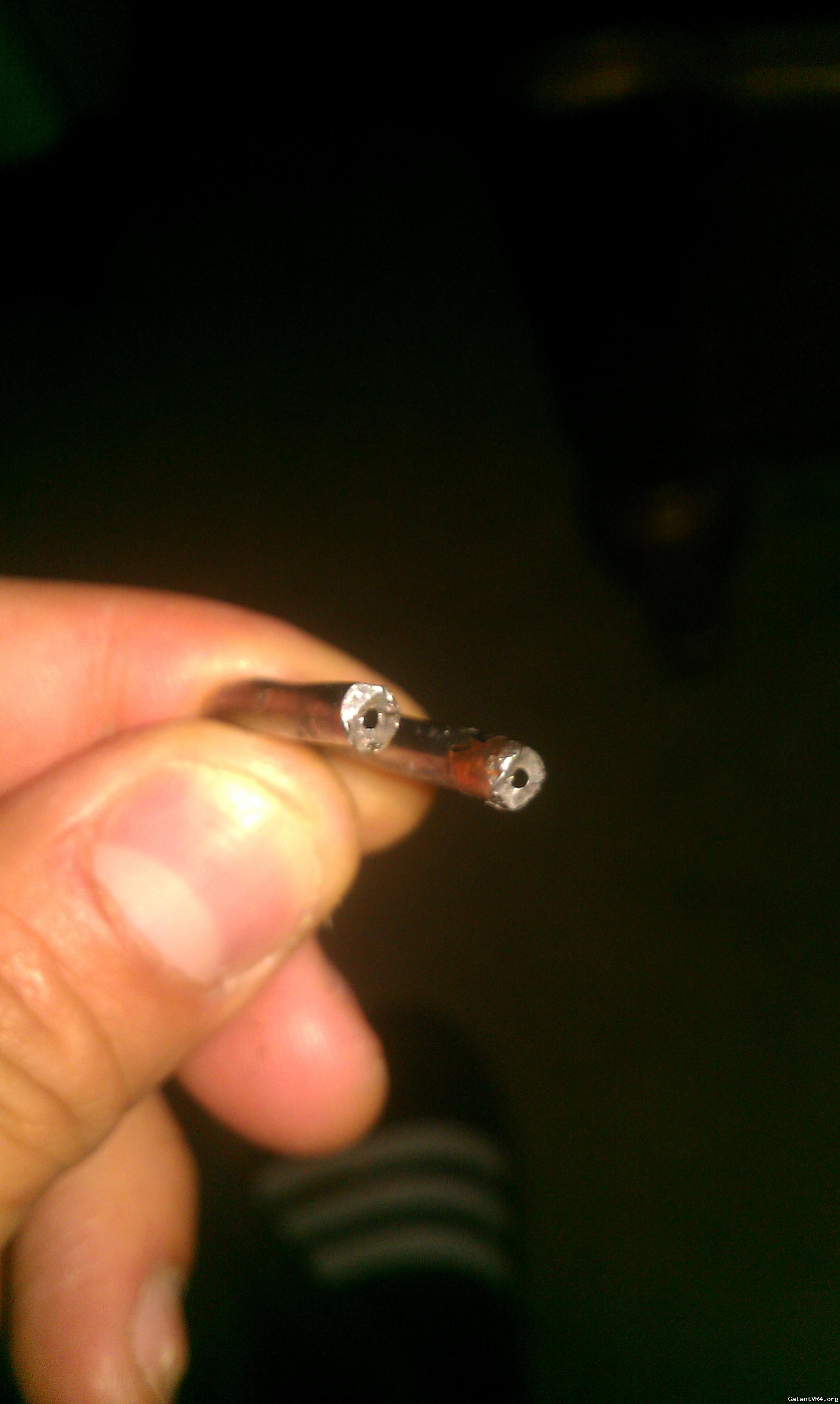

So I took my oil pan off to replace the leaky oil pan gasket with some ultra grey. Once I took it off, I found two oil squirter tips inside. Number 4 and 2 cylinders are the ones that broke off. I dont have a oil pressure gauge so im not sure when exactly this occured, but i never heard anything or noticed anything wrong. Not sure What would cause this, Maybe some knock? not sure at the moment. Can anybody put down their thoughts on this issue? Has this happend to any of you guys? Please let me know. Here are some pics of the pieces.

Most often this occurs after they were removed and reinstalled for some reason, like a rebuild. The clearances are quite tight between the squirter and piston skirt. I noticed after my first rebuild ever that I had broken a squirter. When I went to reinstall another, I noticed that when I rotated the crank, the piston would just lightly scrape the squirter. And i'm sure this gets slightly closer as things warm up and the metal expands. But loosening the squirter, I noticed I could move the squirter tip clear a little more. And I never had the issue again.
You won't see any oil pressure change when the tip breaks since the oil restriction has not changed, just where the oil is going.
