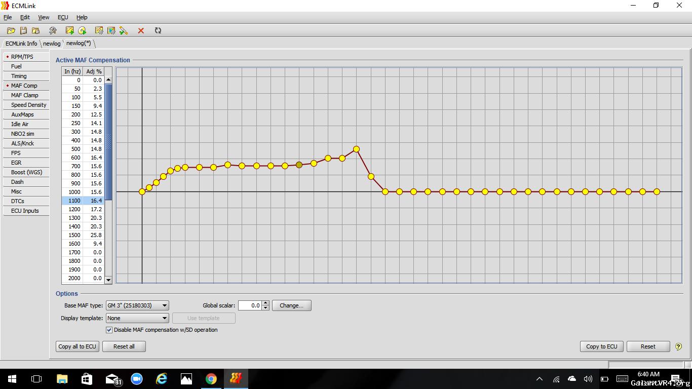

1) Adjust your TPS. @ 15 offset on a 101% scale, you TPS is way out of whack: click
2) MAFcomp table needs work. Those peaks you have in your MAFcomp table should be rounded off to make a nice smooth curve. That spike at 1,500hz is definitely f***ing things up. If you have to adjust large peaks in, you probably have an underlying issue with the car. You have to remember, large changes in the values from cell to cell will throw off the WBfactor. Depending on what I'm seeing in my logs, I will generally take the WBfactor and cut it in half, and then adjust the MAFcomp slider. Afterwards, I'll do another pull or 2 and see where that leaves me. If you make large changes all at one time, it's going to be hard to see how the car actually responds during say, a 3rd gear pull.
Your MAFcomp table looks like most I've seen from people using a GM MAF. For the most part, they are more of an ass pain than they are worth. I've never seen one tuned consistently across the board that worked great all around (cruise, idle and WOT). In contrast, I've tuned multiple cars on Evo MAFs that ran like stock.
If you could, point me to a log where you've collected good data and want feedback on how to dial in the MAFcomp.

Thank you Shane and Brett. I made the changes Shane mentioned. Brett, I truly apologize for all the logs in there. That folder was supposed to only have one in it. I will remove the others and leave two. Once will be called oldlog (the one where you saw some of the crazy settings. The other (new log) is after making the TPS changes and doing a WOT pull in 2nd and 3rd (to around 5300 - 5900rpm in each gear). I believe there may be a MAF Comp adjustment there too. It still has that 1500 spike in there.

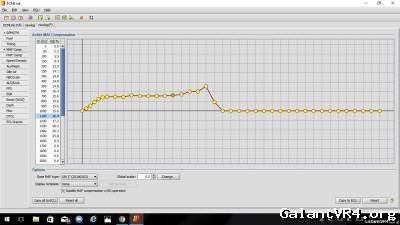

so i looked at your new log and i think your MAFcomp should look a little more like this.please dont use this as i have no idea if its right, but i did what i though was needed to get the A/F estimate and actuals to line up. looking at your MAFcomp it goes up and down all the way to 1500 Hz then drops down at 1600 hz and as you watch it go low it pulls the actual A/F away from the estimate dramatically.

Thanks Shane,
I have smoothed out the MAFComp. Hopefully i can get a pull in this week.

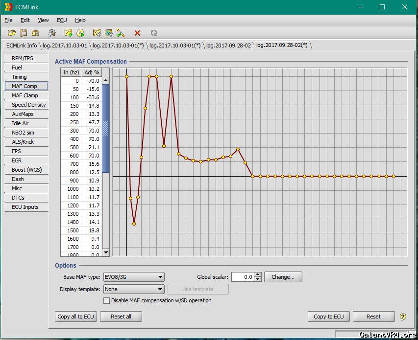

A wiring issue, perhaps. How do you have the Evo MAF wired in?
The MAF Comp table should be zeroed out. You'll need to completely recalibrate the table on the Evo MAF from scratch.

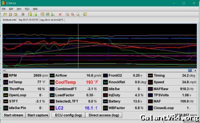

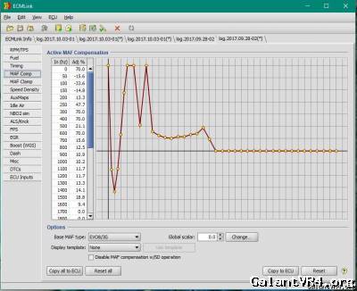

Yea, I zeroed it out. When starting it initially it would barely idle. I lef the MAFComp adjust do its thing for idle, and it set the active MAF compensation setting like this image.

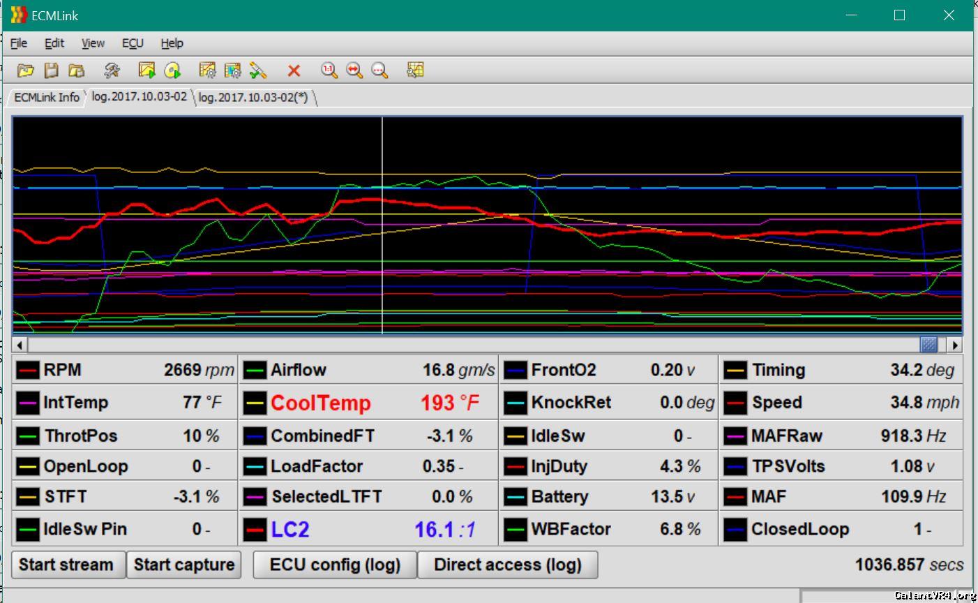

Here are the LOGS . Log that ends with 01 is my attempt to smooth the table, the one that ends in 02 is with the table set by link.
It would idle and start fine with this setting, but ran horrible below 3500rpm. Would stay in open loop. When performing a cruise adjustment, it would cruise fine but idled real lean then stopped idling. Then on restart it sounded like a subie that is missing a cylinder.
