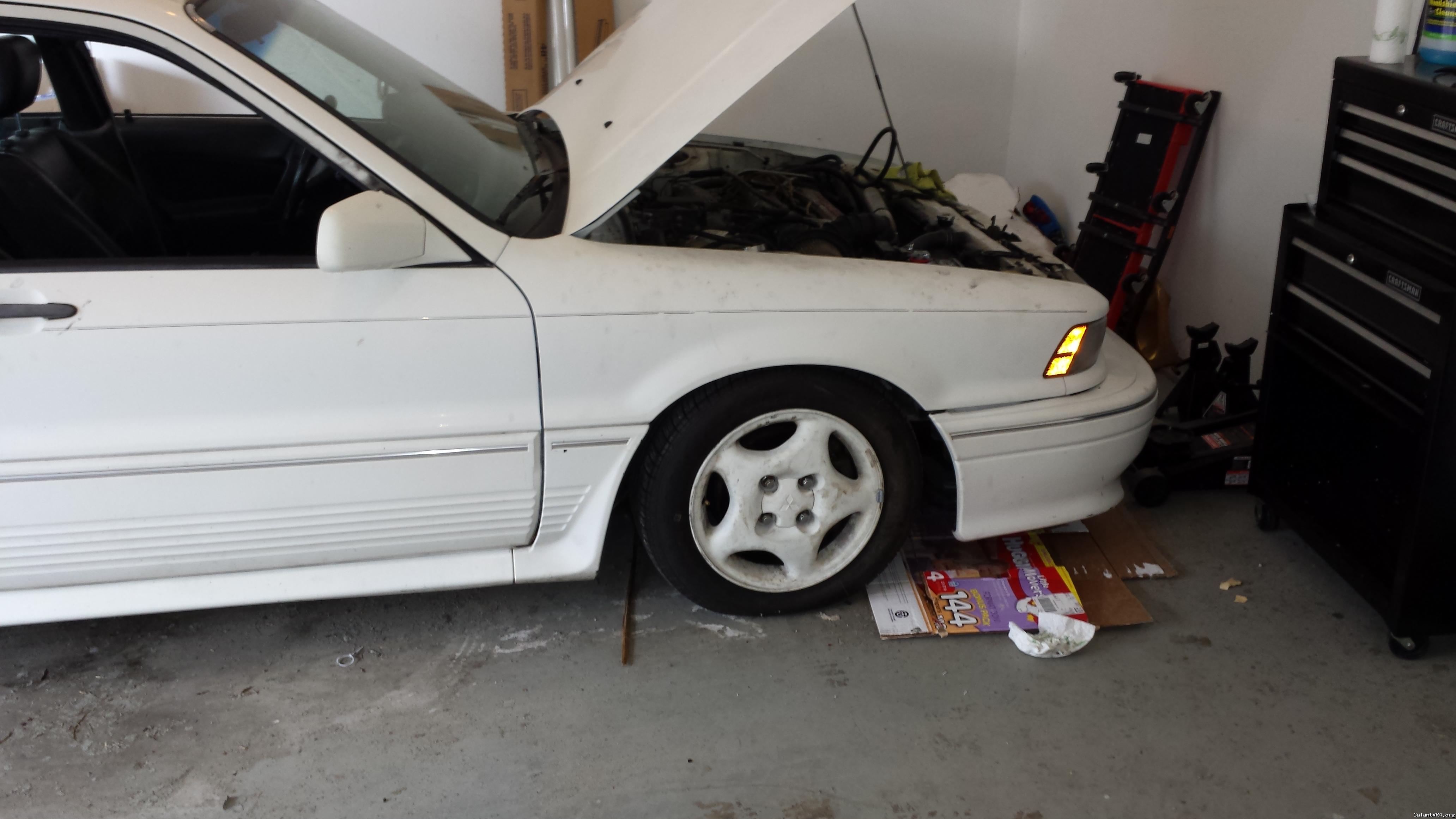

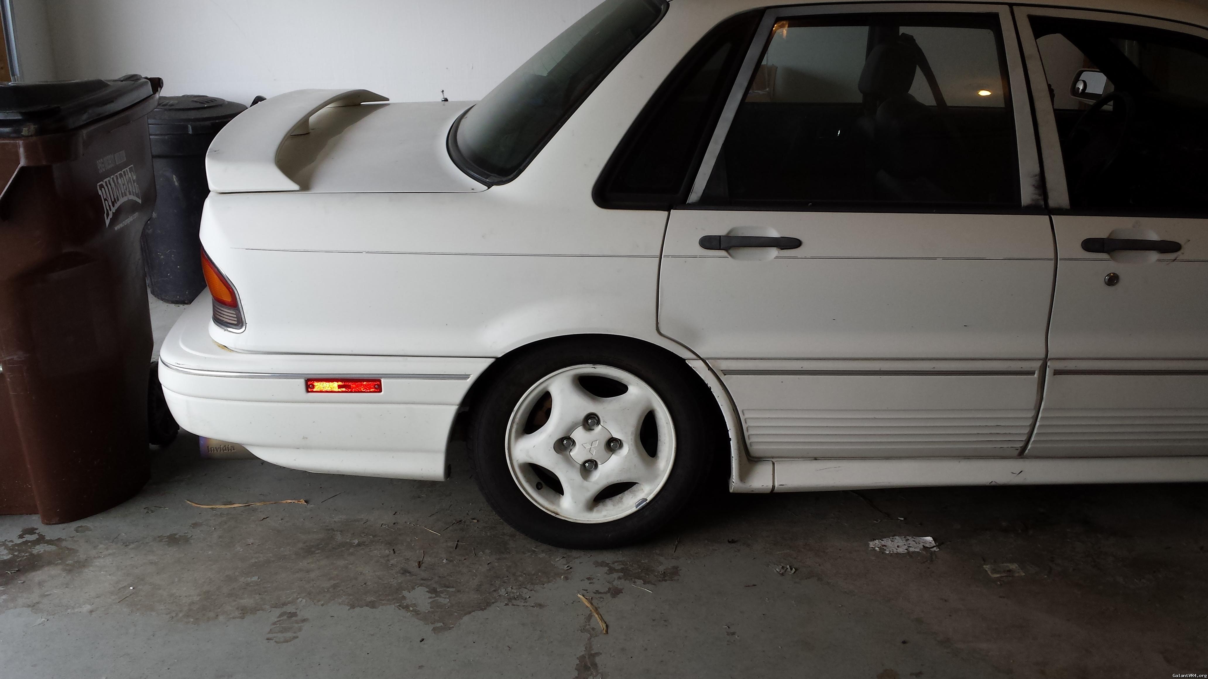

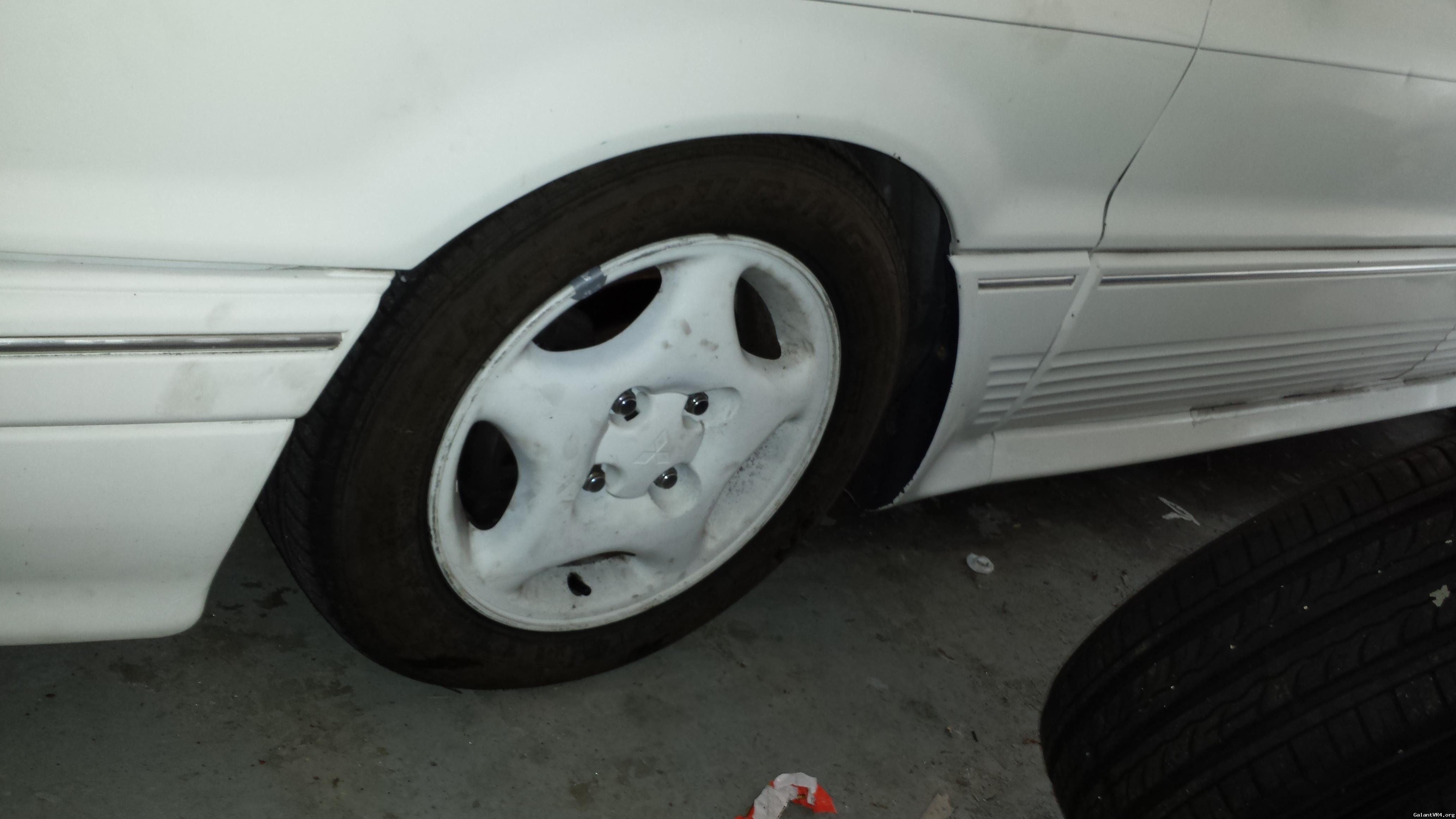

I like both of those. Currently mine is on the stock wheels and tires. The rear fenders just barely eclipse the top of the tire the say it sits. I'm at work but I'm going to see if I can upload a few pics I took with my phone yesterday.

Lol Those are almost positively cut or heated up springs of some sort. They are WAY too low for factory style struts. Dat stance though. /ubbthreads/images/graemlins/uhh.gif

Lolrite? That PO. I have more pics to take for everyone. There are many things that seem awry in the engine bay. The suspension isn't the only thing that needs attention.
