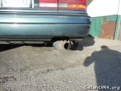

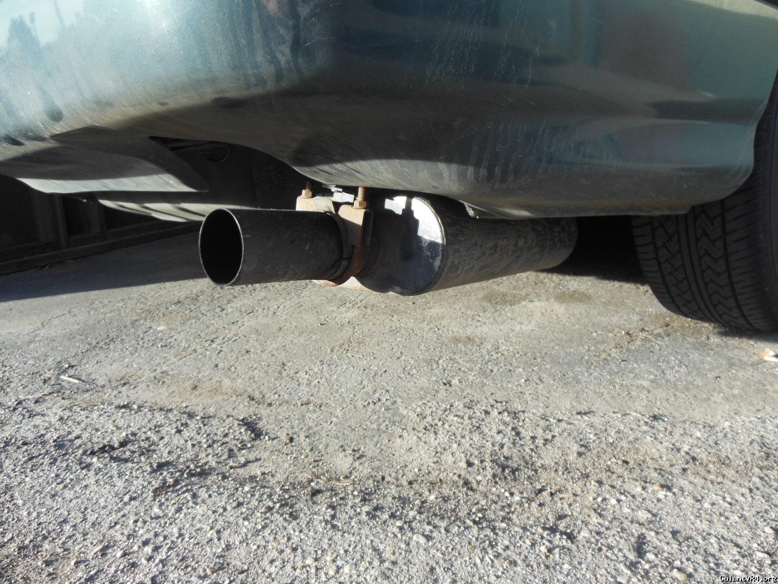

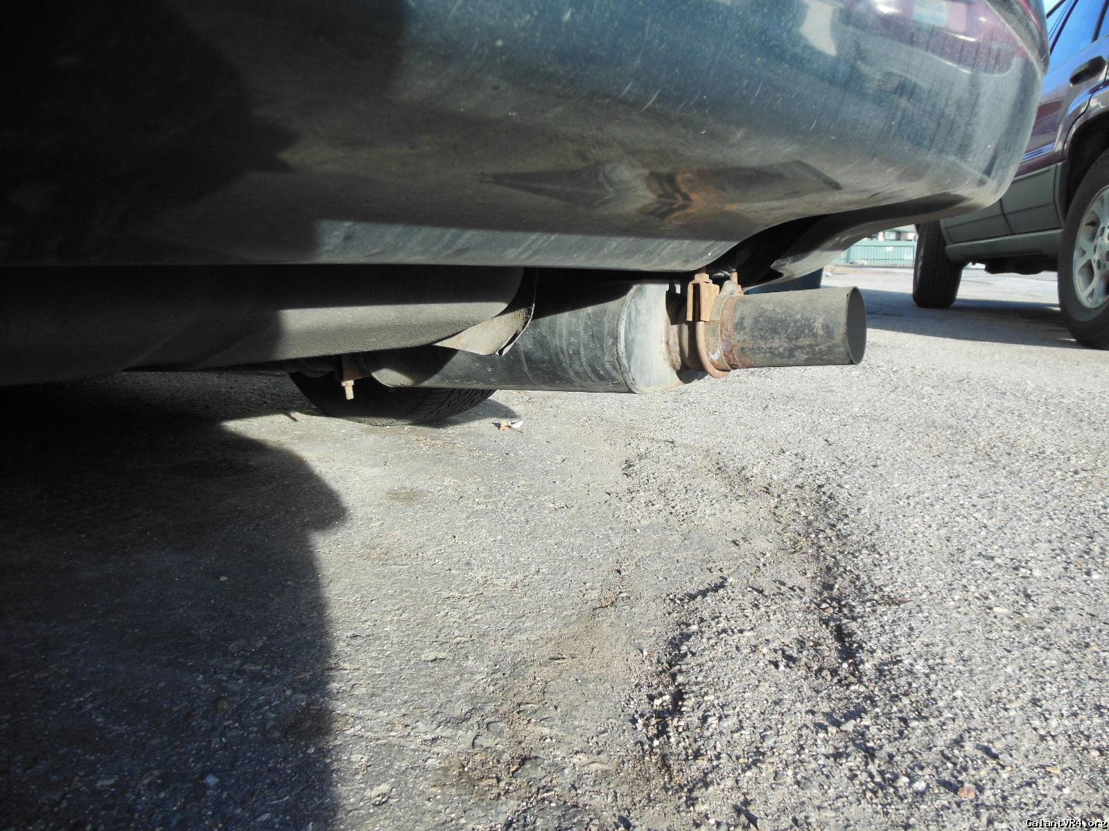

i have a full 3" exhaust, straight piped and i use a dynomax VT muffler, at idle its quiet and when you get on it it opens up and really howls. i like the way it sounds, but i have only heard it from inside my car. there is zero drone noise and the cabin stays quiet. i can try to get a video of me doing a 1-2 gear pull in it if you'd like, but i dont know how much that will tell you.
here is the muffler click

mine is quiet at cruising speeds. you can have a conversation without having to raise your voice while driving.
also its def not a can, here is what it looks like.
