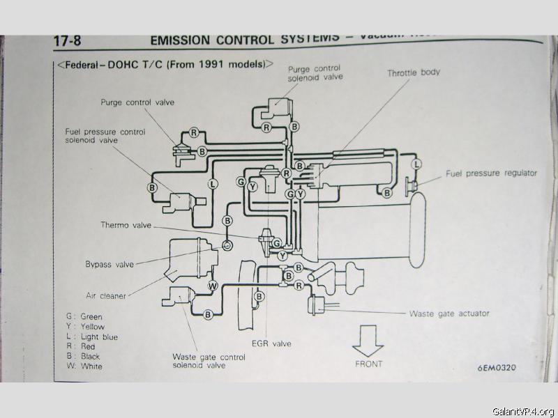

Any one got a picture of the stock boost seloniod hooked up and where each vacume line goes where? both my car never had them hooked up.
Option 2 would be just say the metal nipple goes too the wastegate and the plastic one goes to vacume source or the other way around
Thanks
If I recall, the BCS only has 2 ports, and it doesn't matter which way you connect them. Its either open when energized, or closed when not energized by the ECU.

Judging by that digram im not even sure which seloniod is which that I have where does it sit stock?

If I recall correctly, it's attached to the air filter canister.
It is the 2 port solenoid on the FRONT of the aircan, shown in the bottom left corner of that picture above. The 3-port solenoid on the back of the aircan is the FPR solenoid. The solenoid that you want doesn't have anything on the back end of it, no port, no air filter, no holes, completely blocked off. You could use another solenoid, but you must block off that port if you use it.
