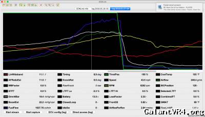

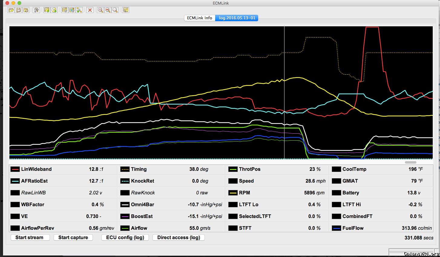

I'm still seeing some bouncy values at WOT. I'm running SD, so I'm not sure what's causal and what's symptomatic. If I had to guess, the bouncing RPM value is causal. In the screenshot below, you can see that Airflow, Fuel Flow, and RPM all track the same bouncy behavior. The end result is bouncy fuel delivery which isn't the greatest thing in the world at WOT.

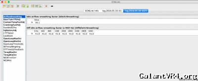

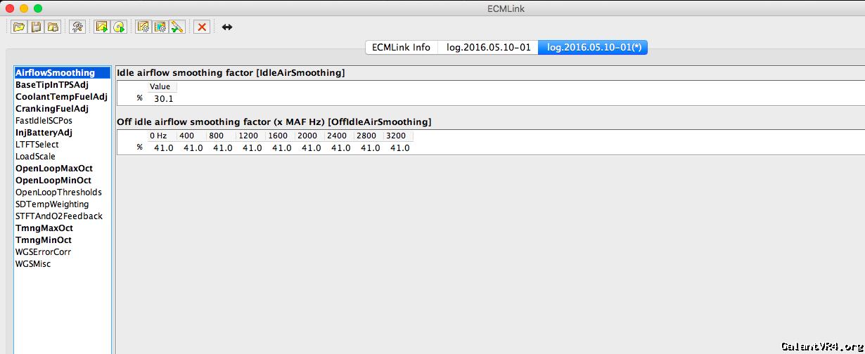

At the suggestion of someone over at the ECMLink forums (one of the link guys, if I'm not mistaken), I added in airflow smoothing.
Log File
Thoughts? After applying smoothing, things did get much better. The bouncy bits were far more bouncy before...
but my current condition still seems less than ideal.

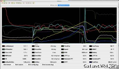

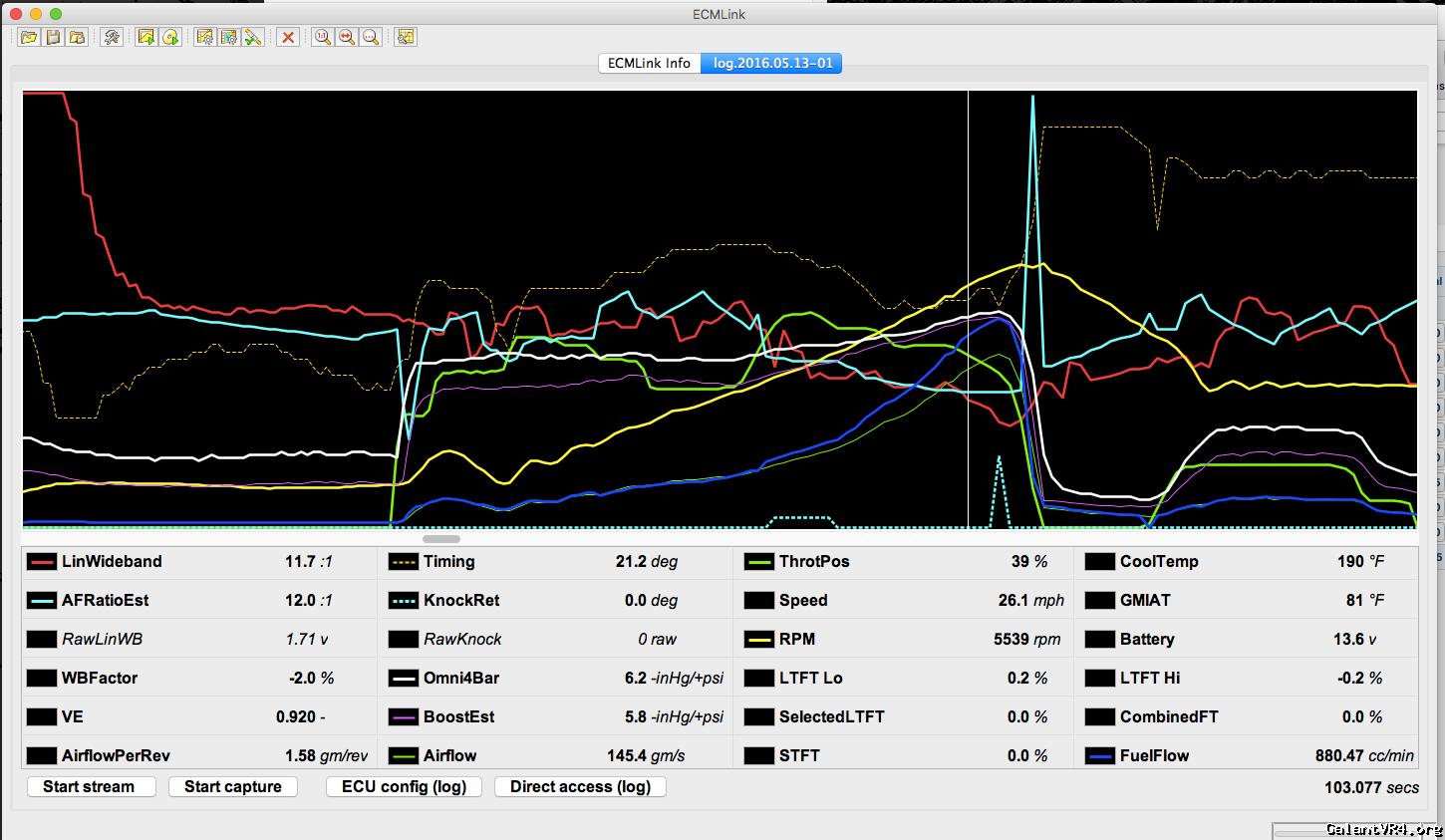

Alright, I might be making some progress, assuming I'm looking in the right place. I pulled a log with 3 separate points of interest.
Log

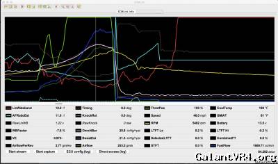

First, WoT in 2nd gear. Felt breakup in the usual place. In the image below, the break-up is occurring pretty much where the bouncing starts on the FuelFlow graphing line to the right of the selection bar. This bounciness mirrors bounciness on the RPM and Airflow lines as well.
Something else worth noting is that my VE is way off. I'm pushing nearly 10.0:1 at WOT under boost, but my target is 11.0:1. In fact, that number hits 9.9:1 at one point on that graph (just after the moment pictured).

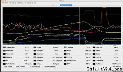

Next, I did two runs where I simply rev'ed up to where I see the bounciness normally.
No bouncy on the first high-RPM cruise, but noticeable on the second graph. The thing is I didn't feel any breaking-up on either of these high-RPM runs. Smooth feel and sound.
Am I not feeling the breakup under high-RPM cruise because it's just harder to feel those things when you aren't accelerating, or is this just anecdotal to my issue?
Could I be getting breakup due to a rich condition at WOT? 10.0:1 is certainly rich...
Something else? (CAS/fuel/etc...)
Thanks to all for the input so far.

I see two patterns here. One is that the RPM seems to bounce first.
The reason for this can't be many. Faulty CAS, or you're limiting power. In your case the limiting of power comes from the rich condition. When I started writing my SwD code I pushed the AFR as rich as it would go to see if the code was stable at full boost. I experienced what is called rich condition power limiting. This comes from the fact that the fuel is no longer being burnt and starts to acts as a cushion inside the cylinder. Remember fuel cannot burn without oxygen. There are MIT white papers on this strategy to govern power.
Try leaning out to 11.5 or even 12.0 and see if you get a cleaner pull. Remember to take it easy and if you hear knocking, back off the WOT right away.
This way you can get a good picture of what's going on at your 5000-6000+ range.
When you reach the sweet spot where you can go as rich as needed without getting any bounce, this is where your tune should be for your motor.

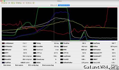

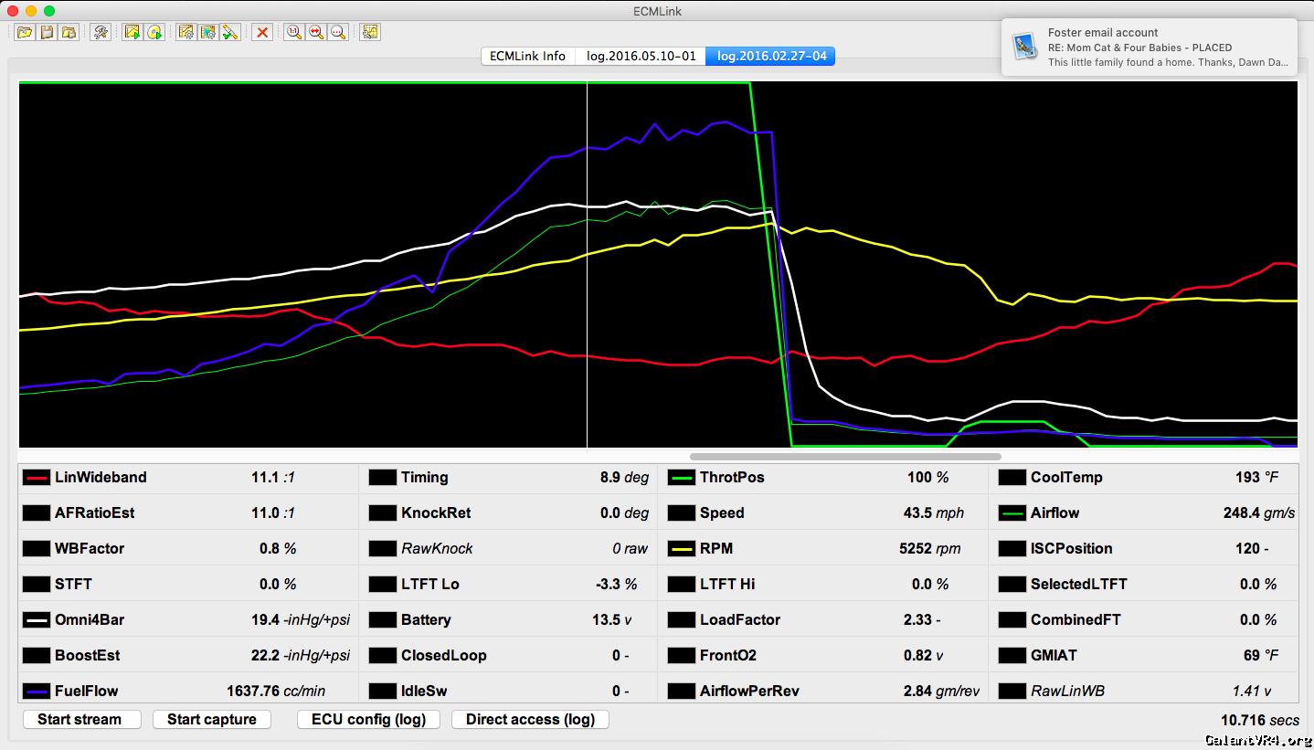

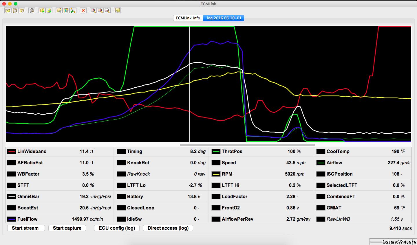

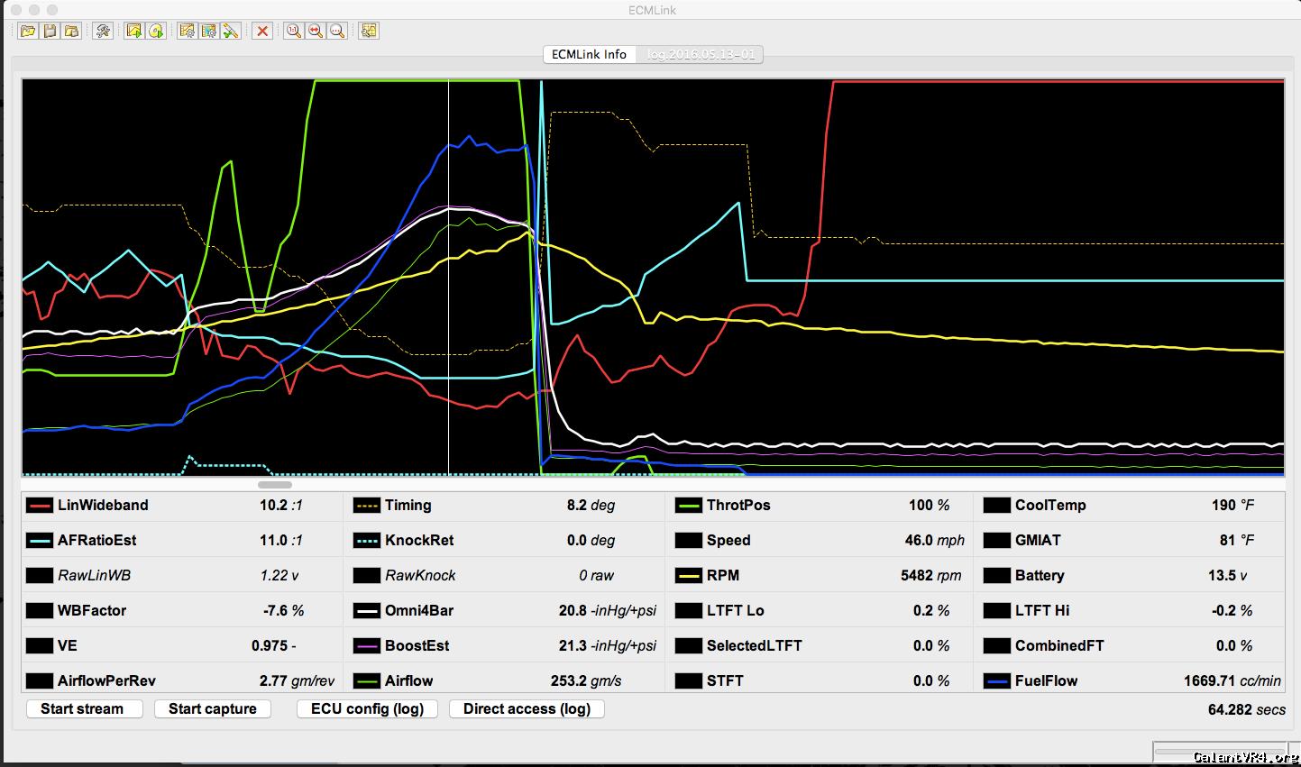

Well I finally got some WOT pulls in. Vastly improving results....
The first pull is in 3rd gear. I'm still running rich, but I'm out of the 9.x:1's.
The good news is that with the AFR leaned-out, I wasn't feeling the hesitation anymore. I made some VE adjustments and managed a 2nd gear pull (sometimes there's just not enough road). I got a touch of knock, so I backed off, but the AFR's looked even better.
At this point, I figure I'm just going to be doing pulls, tweaking VE cells, doing pulls, tweaking timing, doing pulls, etc.... I picked up a boost control solenoid that I hope to get installed and hooked into link. I'm hoping that being able to make more precise boost adjustments helps the process out. I'm sure it can't hurt.
Thanks, all. Looking good!
3,473
Looks pretty good. WB and AFRs are lining up nicely for the most part.
Just looking at the 3rd gear pull:
I'd start pulling fuel from about 5k on. You're around 10.0:1 at redline, which is pretty rich.
Personally, I'd make a manual TPS adjustment. +4 @ 103% means you're off a bit.
Timing is super conservative, but I know you're limited by sh*t fuel. Is that as aggressive as you're able to get without knocking?

Yeah, I actually already adjusted the WOT VE cell on the 3rd gear pull to lean out a bit. My target AFR @ WOT is 11.0:1.
I'll check the TPS. Haven't even touched that setting in like a year.
And yeah, gas here is sh*t. I plan on getting the car running with little/no knock, then I'll starting bringing the timing up to where 92oct allows. Conservative timing until then. I'm actually noticing quite an improvement just getting the AFR's right.
I mean of course I am, right? /ubbthreads/images/graemlins/smile.gif
Oh, and follow-up question on AFR's: At what point would you think I should be targeting 11.0:1?
15psi?
17psi?
max (around 23psi at the moment)?
I'm noticing a touch of knock @ around 18.5psi targeting about 12.7:1. Seems a bit lean for that much pressure...
