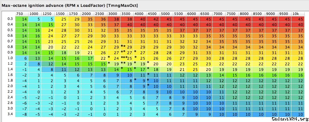

The thing about the knock is that it seems way more consistent with RPM and not with a particular section of the timing map. Here's a plot of where I see knock on my TmngMaxOct table. One dot for each time I saw knock in a log.
I suppose I could drop the affected cells down a degree, but I'd like to see what some others think, first. You can see in the plot what I'm talking about re: the RPM range.
3,473
BLUF: Don't worry about it.
Glancing at a few of your logs, worst case you're looking at a degree and a half at partial throttle, which isn't sh*t. Is this repeatable under the same conditions, e.g. can you make it happen every time? If not, chalk it up to sh*t happens. Also, keep in mind, anything that resonates in the knock sensor's frequency will show up as fabled "phantom knock". I've heard people claim everything from lifter tick to rod knock have been known to cause phantom knock. Whether or not any of that was/is true, who knows. Each car and scenario is unique.
If you want, sure, you can pull timing from the cells you have charted. You may or may not see a difference. Whatever happens, I'm betting any changes you make won't give you consistent results. You'll probably see a bit of knock here and there even if you pull some timing. It's nearly impossibly to eliminate all cases of knock from a tune. That's because the combustion chamber is such a dynamic environment. As internal and external factors affecting the car and engine change, so does how combustion is taking place. A tune that's perfect under one set of conditions can be imperfect as soon as those conditions change a bit. It's just the nature of the beast.
How's the car look under WOT? Do you see any consistent knock there? If so, I'd be concerned with that. 1.5* under part throttle...sometimes...Meh.
That's my .02
