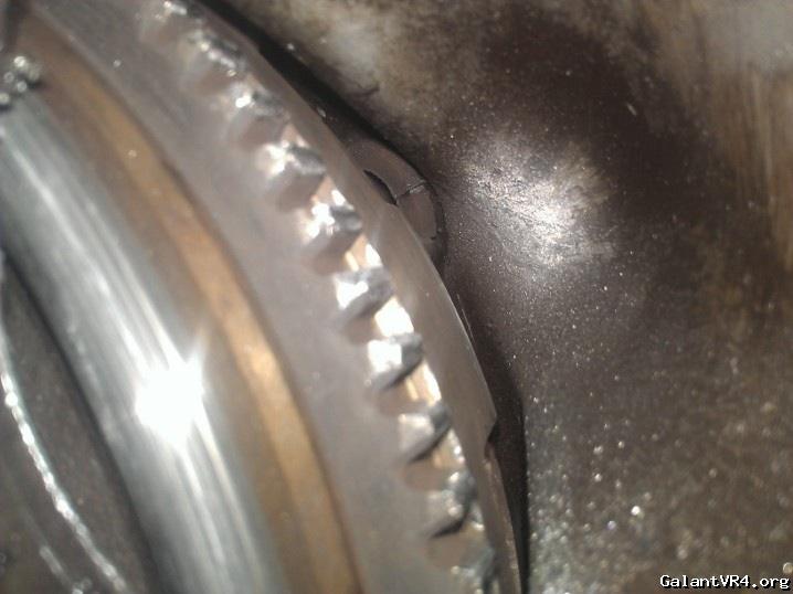

Ok, so I had to get a used starter from the junkyard. I pulled the starter off a 95 Sonata. I can here the starter whirring and it sounds like the teeth are scraping against the flywheel, but not engaging and turning the motor over. From the part number searching I've done, 4g63 6-bolts use the same starter. Could it be that the flywheel teeth are too worn to engage with the starter?
Its possible and does happen. Are you sure you have the right starter? Not from and auto or something? Its pretty easy to see if the teeth are screwed on the flywheel. Check that first, after that I would suspect the wrong starter and reason being the teeth are not offset properly

Ok so I went back to the yard and grabbed a starter off a car with a manual. I saw there was a difference between the two. So I was certain that this was going to work. I got it installed and the car turned over slowly a few times and then began doing the same thing it was doing in the first place. Is this issue caused by the starter relay going bad? Or is it that my flywheel is too messed up and the gear from the starter can't mesh with the worn down teeth on the flywheel?

Thanks, I will give that a shot in the morning. I hope it is just something simple like the starter and just exchange the one I have. I would think that the flywheel is designed in a way that the teeth from the starter gear and the flywheel mesh completely instead of just the tips, so that the worn teeth on the flywheel would not be an issue unless they are completely missing.
