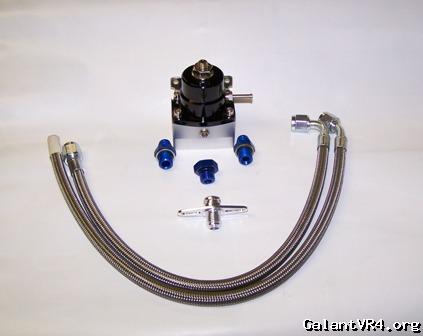

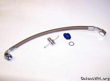

SS Braided Fuel Feed Line
I got this line made to try to make installation easier for the DIY'er. It goes from the filter to the rail. I also simplified the the return line from the rail to an aftermarket regulator then to the hard line or straight back to the tank.
No more messing with SS braid pricking your fingers.

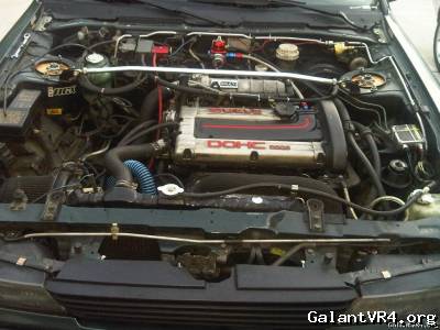

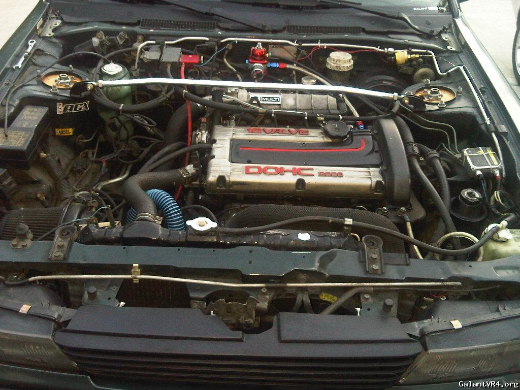

i mounted my fpr in the middle /ubbthreads/images/graemlins/grin.gif oh and sorry for the messy engine bay... im going to clean all that up once i pull the motor out
That's exactly where I mounted my afpr. The kit is set up to mount it in that same exact location. Very simple no non-sense clean install.

Just a suggestion here:
While stainless looks cool and all, some of us have discovered russell proclassic hose and love it.
If you made a "kit" with this stuff, it would probably sell quite well. As it stands now, i believe only STM sells the ProClassic hose kit.
I'd MUCH rather buy from you than them.

That ProClassic hose is a good idea. While SS looks nice, you have to be careful about it contacting anything else in a tight engine bay. My SS clutch line almost sawed through the stock rubber intake piping just from normal engine vibration so I ended up having to cover it in split loom.

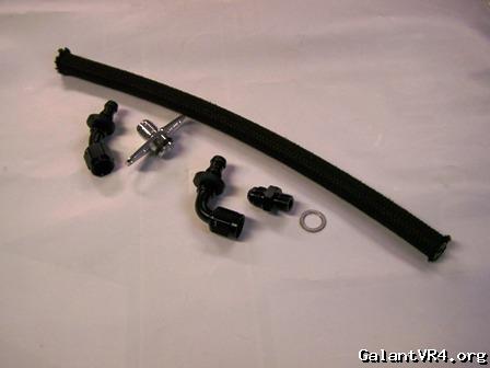

Pro-Classic huh....
Check out these beauties. Black Nylon braided lines with black push lock fittings.

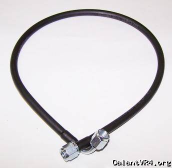

I can also do the SS lines in my original post covered in black so it won't have a chance to saw through or gound out anything. It would look so factory it's really cool. Wait, I have an oil feed line I did for member Scientist with this finish.
What do you guys think?

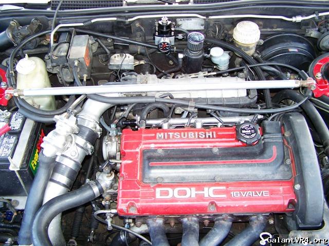

I'm working on prices on the SS line kits. Here's a picture of my return push lock kit installed.

That looks really nice. I've actually been looking at the kits availble and would much rather buy one of these kits from you. Definitely interested in price when you get it figured out.
