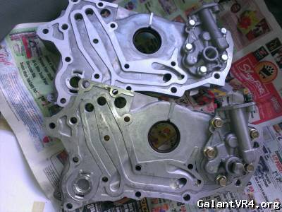

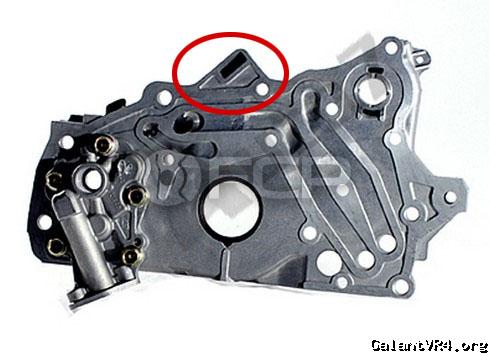

This is a confirmed fit for the dohc 6 bolt: Part#21310-33142 it's for a 92-95 hyundai sonata
open-uri20120713-31620-1v067qy.

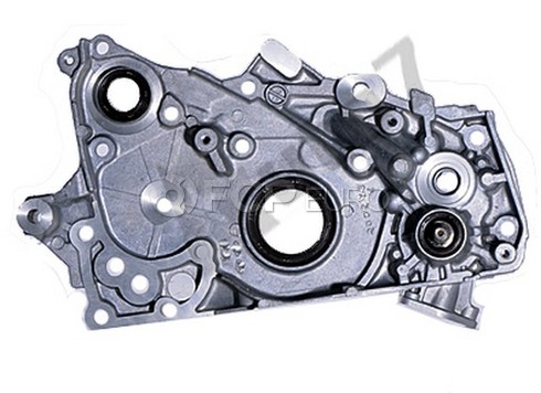

This is from the 89-91 2.4l: Part#622-0056
It has a little tab at the top circled. It may get caught under the tensioner arm on the dohc setup. Is that the only difference? If you notice the factory pump cover gasket actually extends up where this tab is at the top, so I imagine there would be a clearance issue seeing how the casting was changed presumed for the dohc cars. If thats the only difference I have no problem cutting it off.
In this thread it says there different then the same... not sure why they would be different.

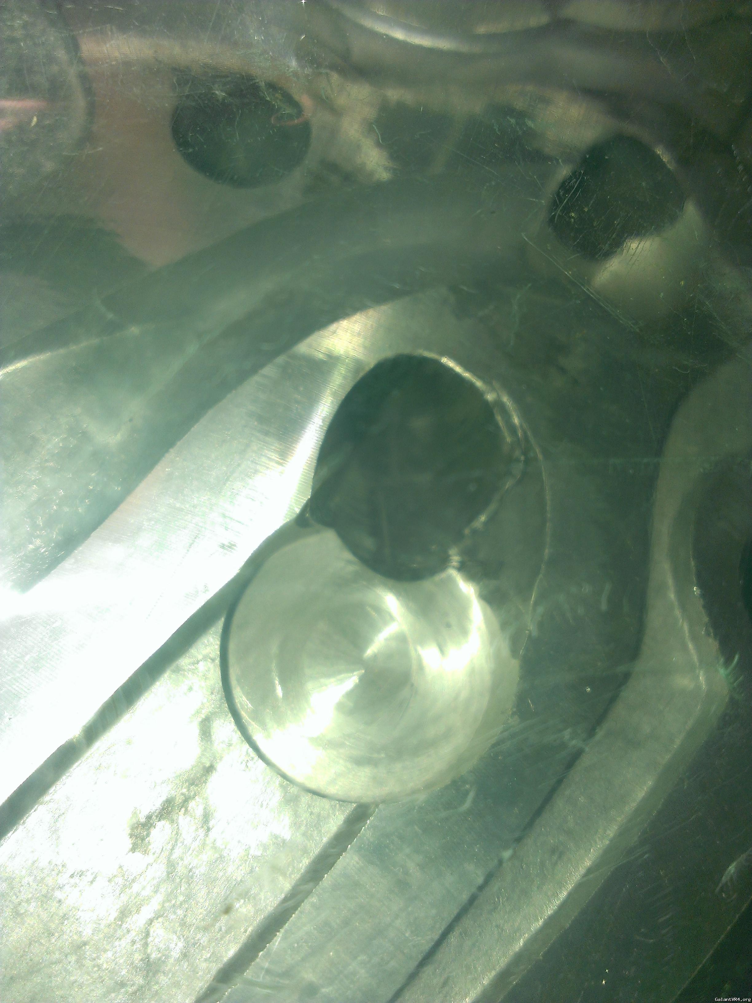

I got my ACL/Orbit front case in the mail... Lets just say I'm not impressed.
not the best picture but there's a huge hangnail chunk of aluminum ready to fall off. with quality control like that I don't want to trust it. Id be better off spending $100 less on an itm or dnj pump.

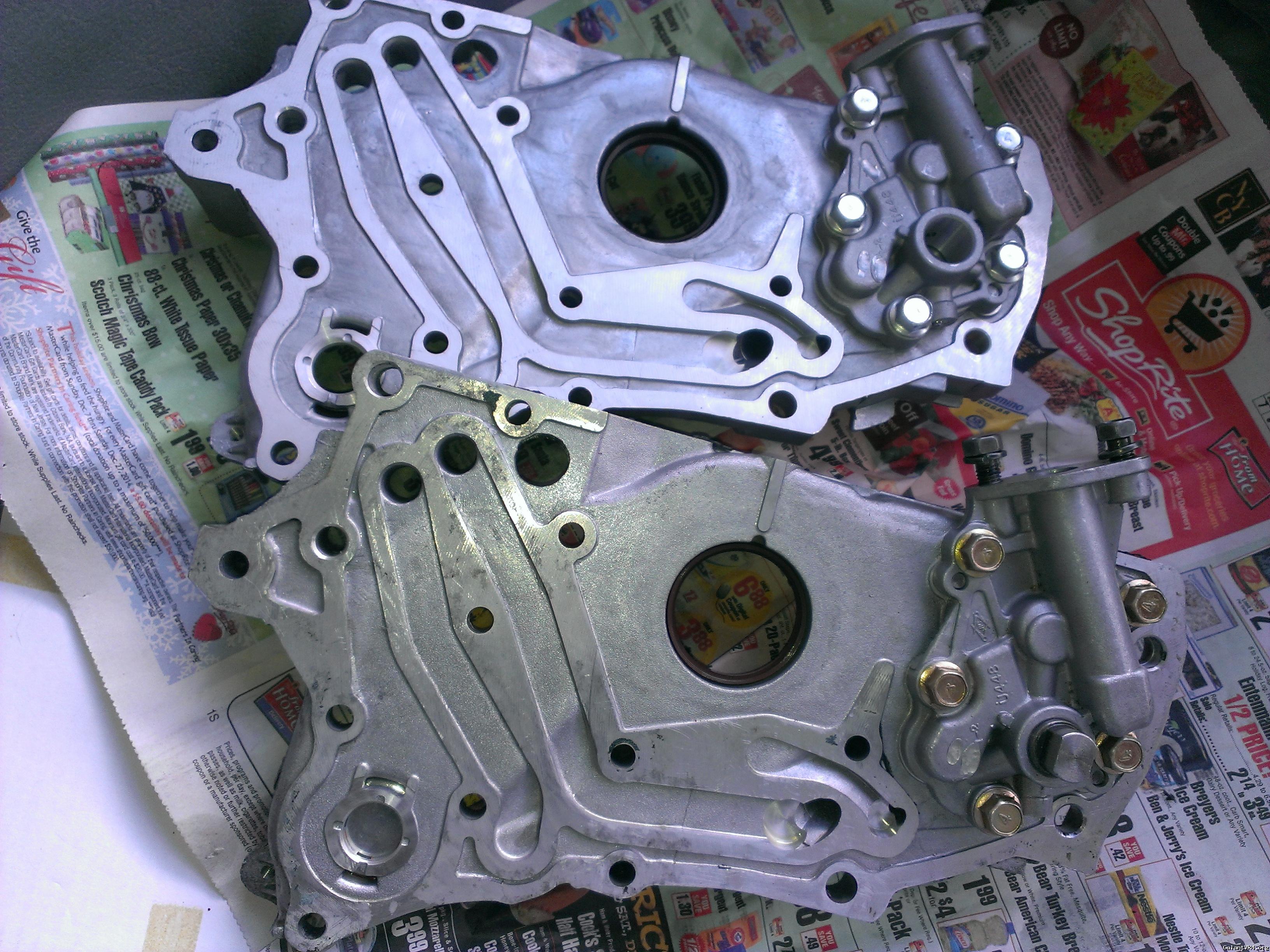

I got my Hyundai cover in the mail today. It is drilled much better but than the acl orbit unit, however it is filthy. There are bits of aluminum all over it. The cast is identical to the Mitsubishi unit but it is a little rough around the edges. The oem Hyundai seals come installed. I got it on sale for $70 with free shipping. For the $280 difference I will disassemble it and clean it and I believe it will work fine.
probably going to buy another while they are on sale!
tektic
Dec 19, 2012
1,497
ronkonkoma, ny
It came with gears. They are smooth. The only apparent differences are that the Hyundai gears have smaller alignment dots, and the grade 4 bolts that hold the pump down are silver and not gold. Same cast symbols every where.
(Edit: the smaller gear was installed upside down on the pump I took out. Looks like this casues extra play and partaly blocks off the oil feed to the stub shaft. Would have probably been catastrophic failure eventually)
I inspected it thoroughly and it looks to be a good piece. the gasket lines up perfectly. The rougher cast may just be do to the fact that mine was use twice and cleaned twice before. They only exist on the outer side of the cover. I'd post more pictures but there pretty much identical.
I ordered another one just cause. $92 with 20% off and free shipping. $73 total

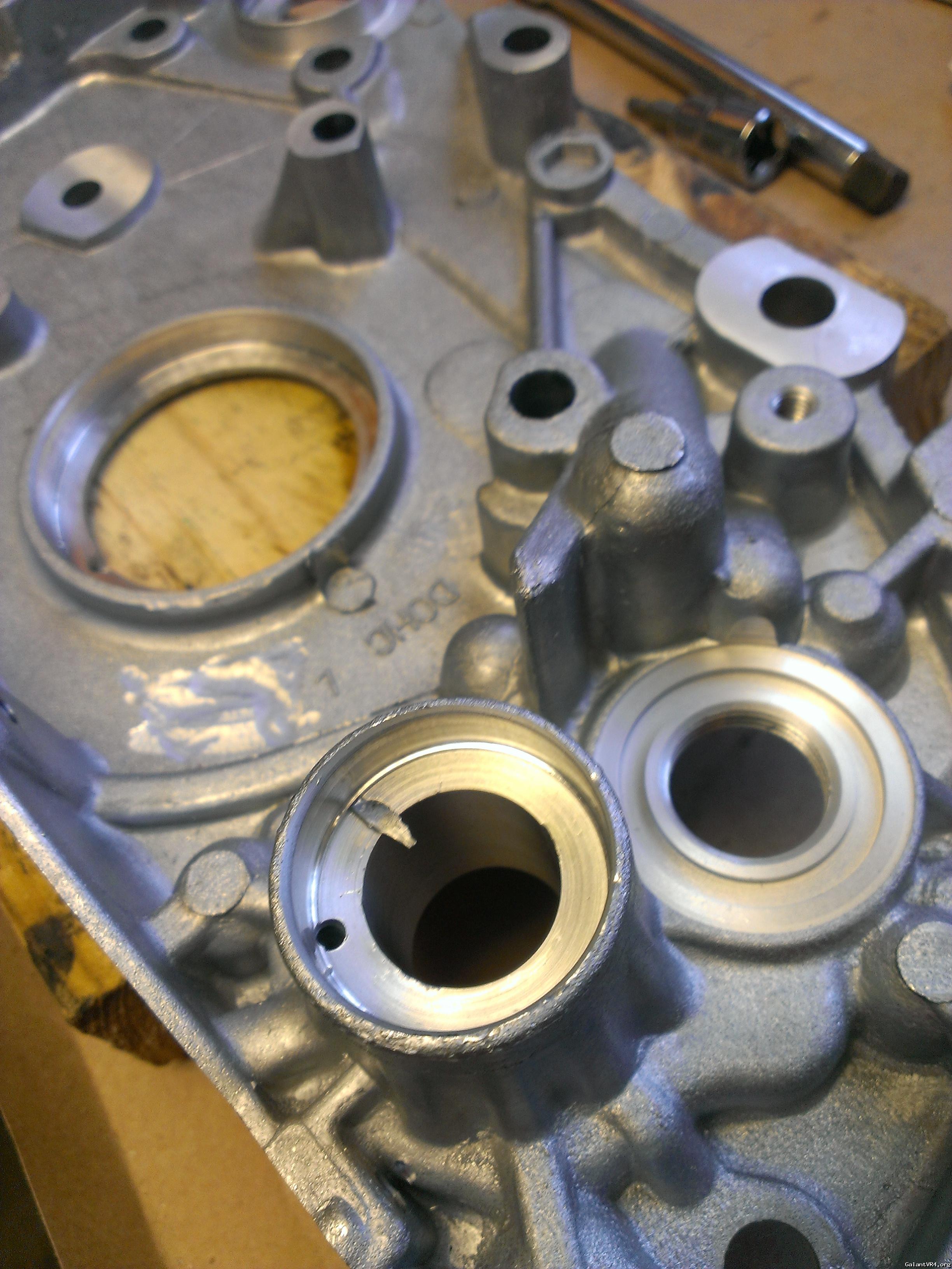

Warning! Disassembly is required!
There wete lots of little flakes and some chunks!
I went over the whole thing with a carbide to remove bits and smooth out some transition. I'm about to clean and assemble it.
