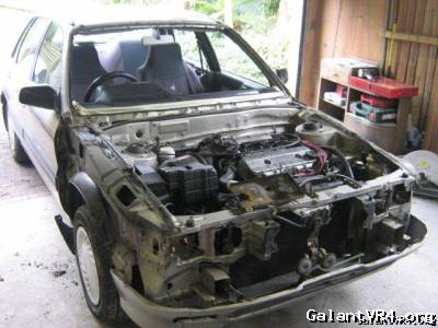

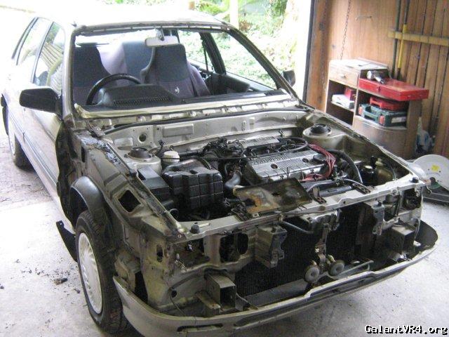

It is definitely a project. I wrecked my '92 Galant GS (automatic) shortly after rebuilding the engine in it. I found a SOHC Galant (base model, no power windows, mirrors, nothing) with a good body but a bad motor. To make a long story short, the engine harness will most definitely have to be swapped. The ignition system is completely different. Also, my GS had power windows, mirrors, etc. In order to make all of this work, the interior harness had to be swapped out. It runs from the ECU (front right), across the dash to the fuse panel (front left), down, and all the way to the trunk of the car. I completely gutted the interior, and swapped everything (dash, seats, carpet, etc) over.

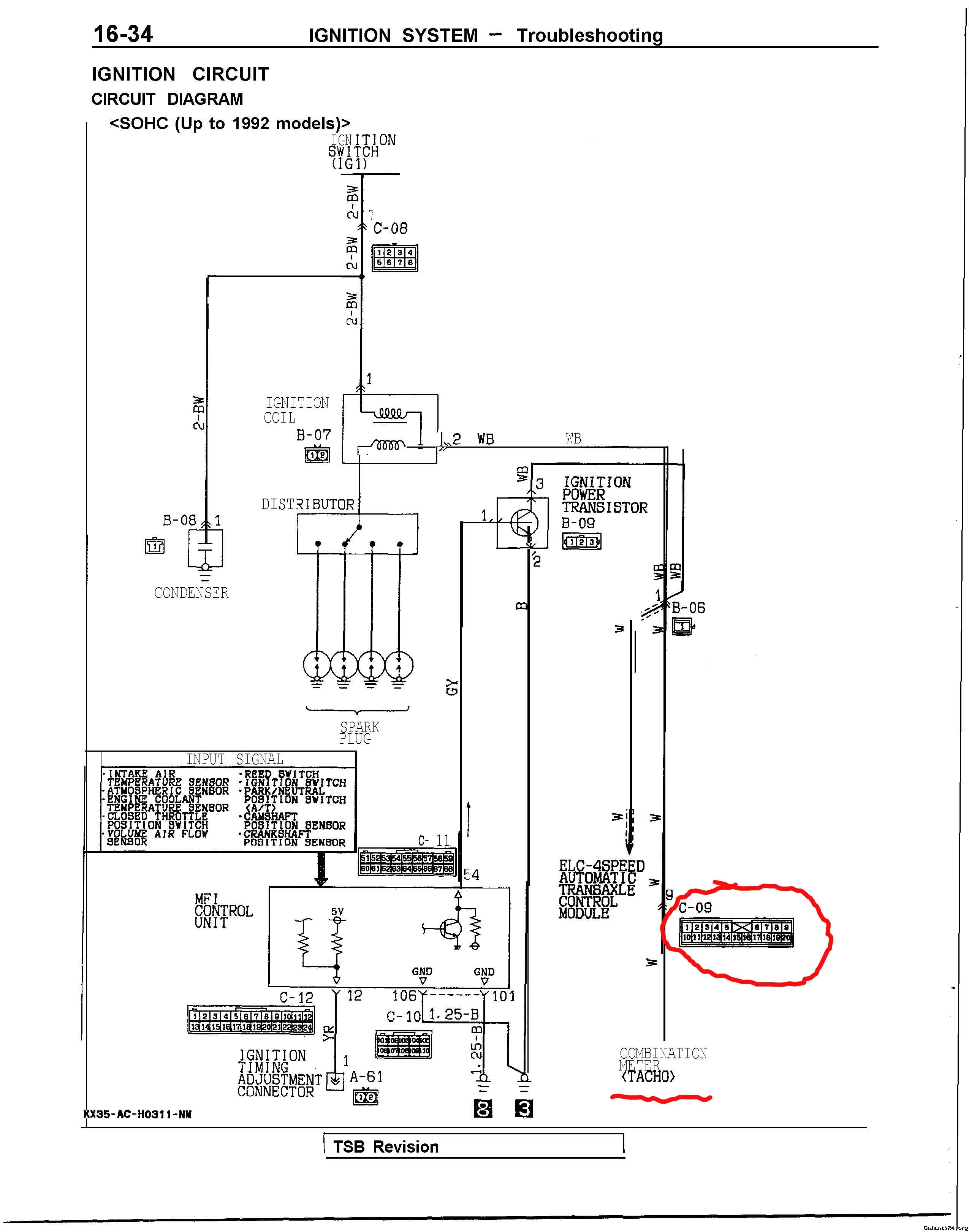

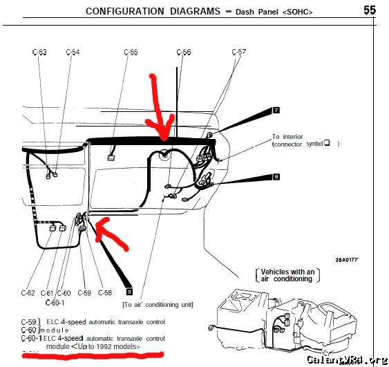

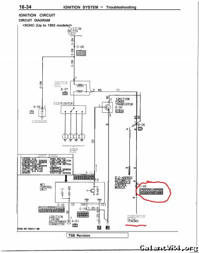

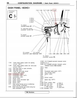

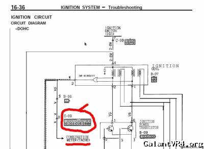

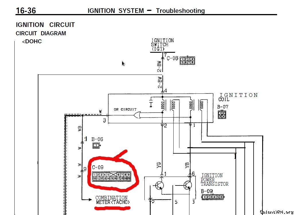

if I change my cluster to the DOHC, will that just plug in?

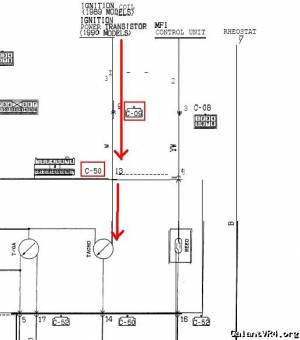

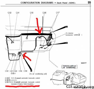

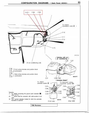

In the manual (the Body/Electrical Volume), on Page 54 of the configuration diagrams is a picture of the junction that I was referring to under the dash (note the connector numbers):
C-09 is a 20 pin connector that contains the wire for the tach signal. It is the same size between all Galant models (The only difference is that some pins aren't used for some models), so it should connect right up without any issues:
I'm pretty sure that the issue is with the SOHC tach assembly itself. It expects a different signal than the DOHC tach does, I think. If you can live without the tach for a while, I would try to find a DOHC gauge panel from someone here on the board. It would work, and you'd have the correct 9000 RPM guage.
Sure, feel free to PM me. I'll do my best to answer your question(s). You might want to post them here though, in case it would help other people. It is the Newbie section, so you can ask most anything /ubbthreads/images/graemlins/cool.gif

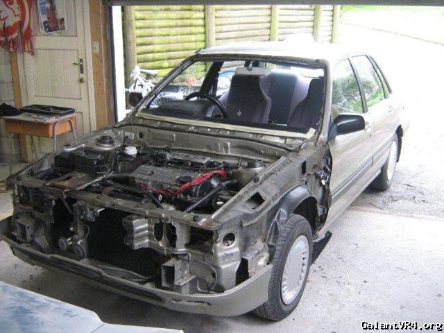

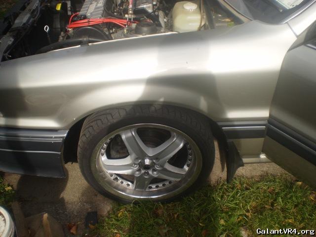

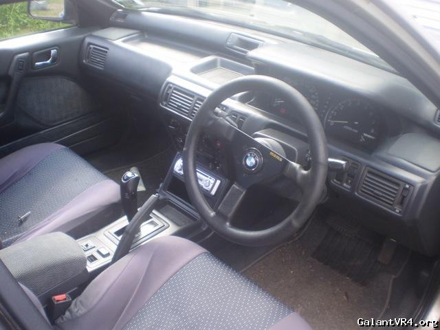

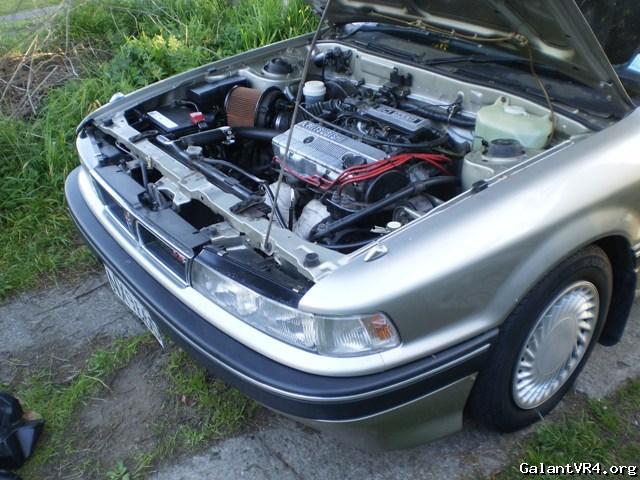

Too true, and thanks for all the help. I'm uploading some photos of the car. It was a 88 galant Super Saloon, four wheel disk brakes, all electrics minus aircon /ubbthreads/images/graemlins/smile.gif The motor came from a local guy, complete with computer, mint radiator (with duel fans), starter, two new oil filters, shifter and cables, trans still attached to the motor complete with clutch etc. I seen the car it came from driving around before it was hit in the rear. 160,000kms with new cambelt. The guy I bought it from was going to rally the galant before it was crashed. The guy was a factory rally driver and competed in Europe, Australia and Asia. He was quite a pleasure to talk with.
Like I said I have yet to buy the pedal box and engine wiring harness. I was quoted about $90 usd for the lot. Like the previous guy in the link you gave me I'm also a student (with a family), money's tight so it's going to take me a few weeks to get the parts I need. Then I can make the change. Thankfully nothing on my car needs doing so the initial change (getting it together and running) shouldn't take me more than a couple of days (fingers crossed). Just found a DOHC guage cluster localy for about $25 usd, the wreaker will probably give me the shift boot and piece in the middle of the console that has the over drive button and power mirror control.
Give me a day and I'm sure my little brain will cook up some more confusions lol.
In the meantime here are some pix

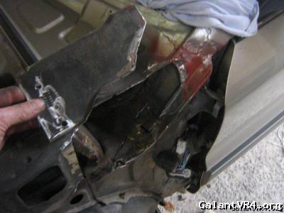

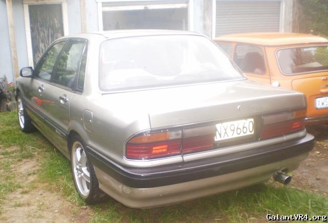

This is the car as bought, here the bumper was removed so I could remove the tow bar.
Here is the car at the body shop, windscreen out getting some work done, just surface rust behind the windscreen causing it to lift out /ubbthreads/images/graemlins/ooo.gif and rust around the heater box fixed

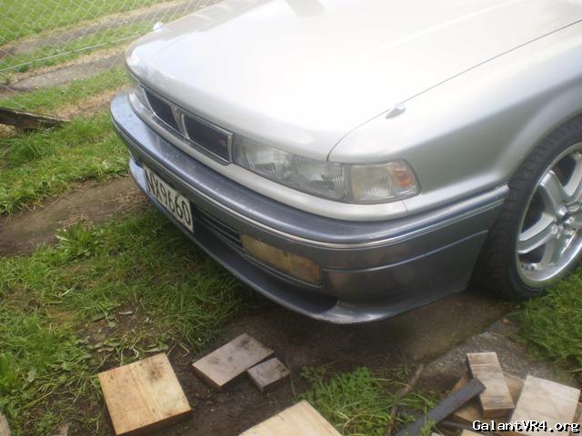

The car now
Here with it's new bumper, soon to see atleast a JDM rear bumper and posibly sideskirts and garneshes. Then a respray in the origional colour.

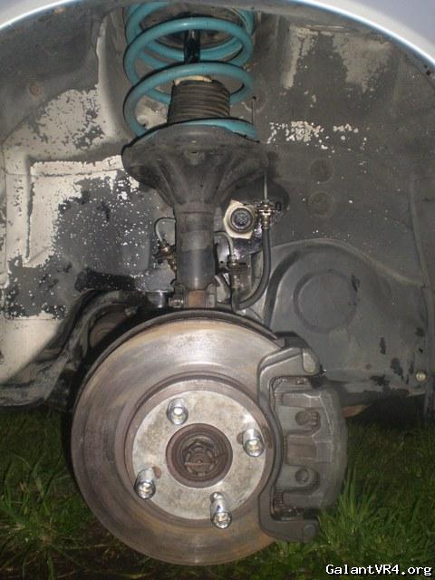

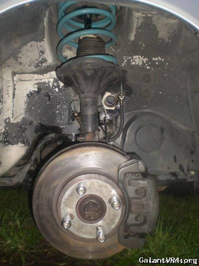

And here are the newly installed vr4 2 pot brakes, much larger than the origionals

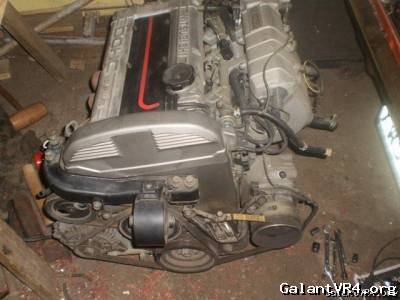

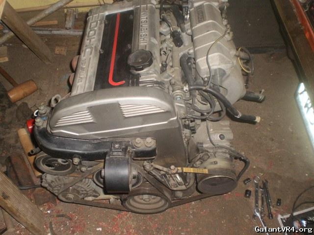

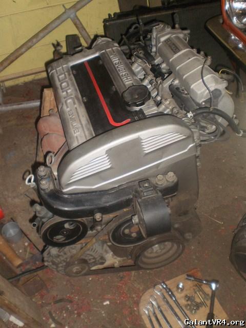

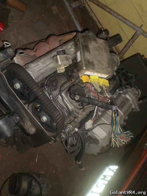

Here is my new motor /ubbthreads/images/graemlins/cool.gif I was sooo exited the day I picked it up /ubbthreads/images/graemlins/tongue.gif
Might be getting ahead of myself but the plan is to eventualy add extractors (headers), 2 1/2" exaust, adjustable cam gears and a small toyota supercharger running low boost

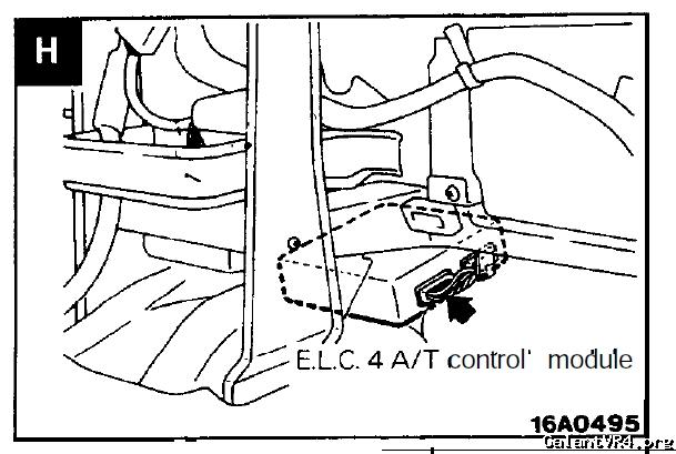

The TCU (Trans. Control unit) is located way back up under the radio. If you pull off those plastic sideboards that run along the side, you will be able to see it. It is definitely scrunched back up under there.
I took a look in the engine bay and the trans plugs into the current engine harness. So the harness (engine) must be different with an auto and a manual? My reserch has led me to believe the computers are the same with the auto and manual, so does that mean that after the harness enters the firewall from the engine bay it seperates? one way to the engine's computer and another way to the auto trans computer? (and of course to the dash harness etc) or is the trans computer integrated with the dash harness and info is supplied to it via some of those extra pins you mention?
The transmission harness is wrapped into the same protective sheathing as the engine harness inside the engine bay, but once it enters the passenger compartment, it forks. One branch runs to the ECU, and the other branch runs UNDER the rubber matting that's beneath the carpeting, over to the TCU.
As far as the ECU's being different between Auto and Manual models, there is a difference in the fuel maps (I think Keydiver here on the site mentioned it somewhere) but nothing that would be blatantly noticeable when driving.
You can get some really good info on how to do it from this page (it's for a DSM, but essentially the same process): click
If you are entirely replacing the engine harness with a DOHC harness (you should be /ubbthreads/images/graemlins/smile.gif), you can eliminate the TCU harness and TCU completely. The only thing I'm not too sure about is the clutch position switch (if it exists (I think it does, it's just left unused) on the dash wiring harness), but when it is unplugged in manual model cars, the car starts without it (it has a little thing that wears out, so many people on here just unplug it).

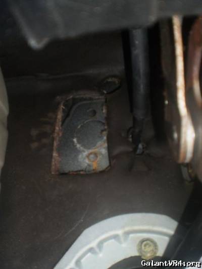

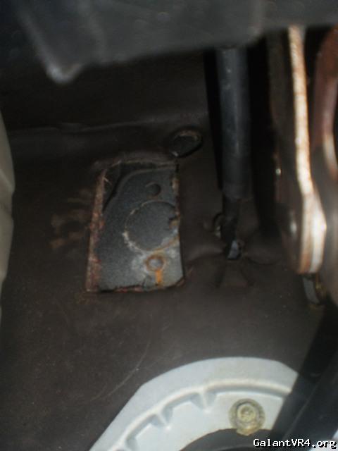

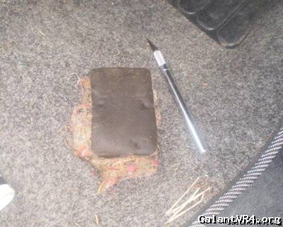

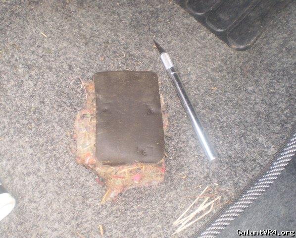

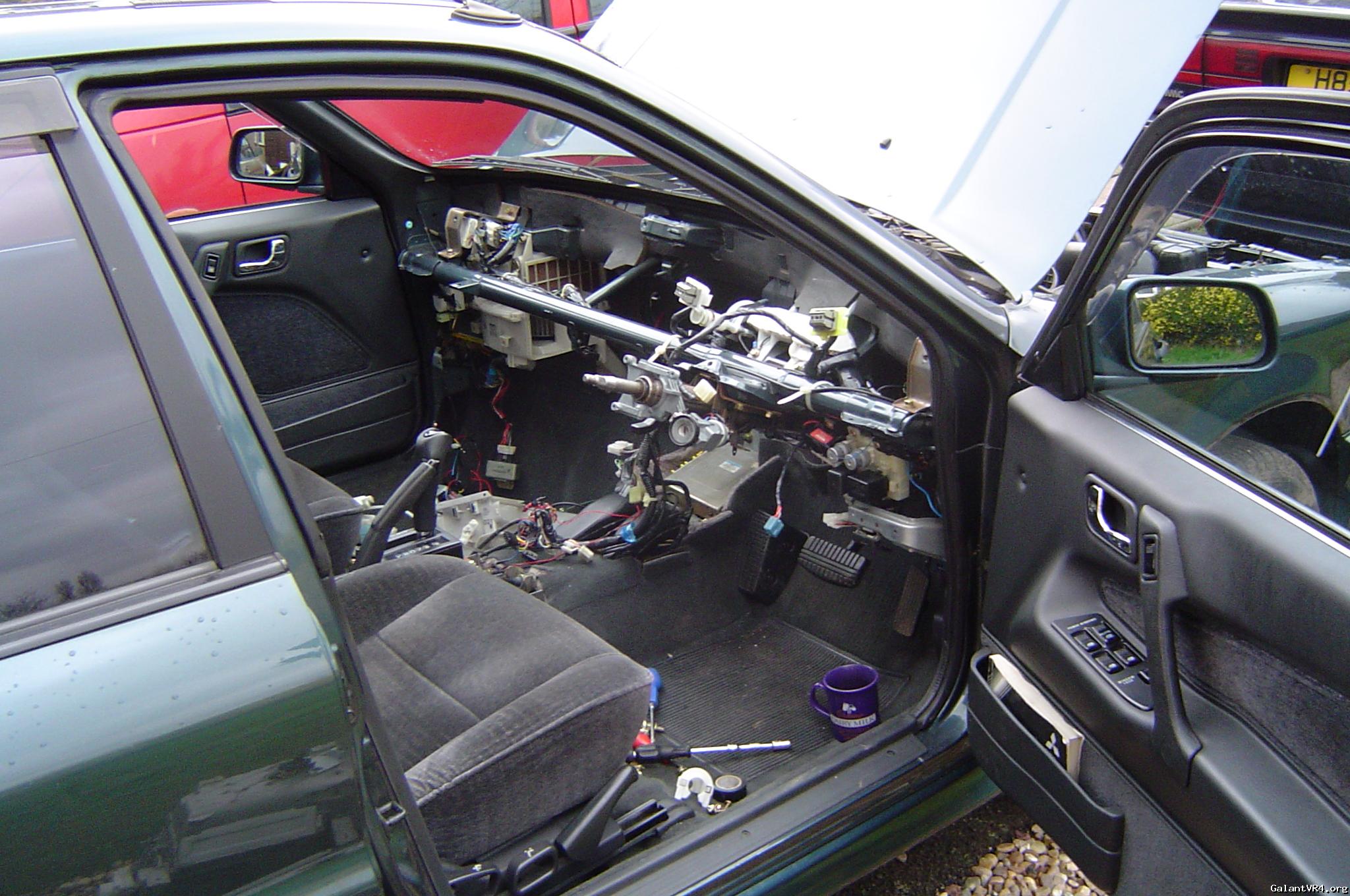

A little update, thought I'd add this incase someone else comes along wanting to do an auto to manual conversion. The soundproofing under the dash has a rectangle molded into it, I cut it out (it's already marked) and sure enough behind it in the firewall is the mounting point for the clutch, however only cut through one of the two layers of metal, so it needs to be drilled and cut all the way through. Take a look at the photos.
Here is the piece cut out
