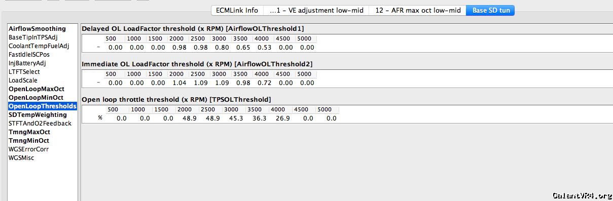

So, why would my OL thresholds be changed when my speed density was installed?

I just noticed this. Not sure why, but it would seem as though English Racing changed my low-load and low-RPM OL thresholds when they installed my speed density. I'm not saying it's a problem, but I can't figure why they would do it and I'm damned curious. They basically zeroed-out values below 2000 RPM's.
Ideas?
3,473
Basically, it looks like your car will never go into closed loop before 2k RPM (regardless of throttle input). You can verify that by logging the "OpenLoop" value, and check to see if it ever reads 0.
As for the reason why, I don't have a clue. Maybe their tune ran like butthole when the car transitioned to closed loop, so it was easier to run it in open loop? Maybe they didn't have time to extend the closed loop thresholds, collect data, and let the SD VE Adjust tool do its job? Who knows.
That's the problem when somebody else tunes your sh*t, only they know all the little intricacies of the tune. Plus, every tuner has their own way of doing things, and own ideas on how to tune best. Maybe they had a reason that we aren't aware of? You gotta hit them up and find that out. Let me know if you do. I'd be interested to know what that's for myself.

My guess is the same as GST's. I think they couldn't get a proper tune in closed loop at idle and part throttle so they did the 0's as a band aid.
This is just speculation but there really is no other reason to do that kind of tune otherwise.

Sadly, I've become convinced this is the case. On the first tune, I got an evo map on accident and my low-end was crap. Lucas sent me a new 1g map and things got better, but I've been working on the tune ever since (last winter). Of course, that's always going to be the case, as I'm the one driving the car every day making me best equipped to make drivability adjustments. But there were certainly things along the way that left me scratching my head. Things like:
SD installation did not include an IAT. They just zeroed-out the temp adjustments.
VE table had cell values as high as 106
Fuel trims were off by more than 6%
16.5:1 idle AFR
Knock threshold set to 70% throttle @ +4000 RPM's
and now I discover the OL settings have been changed.
Ultimately what I've done has been to adjust my global fuel towards 0, reduce the VE values to bring my max cell number to sub-100, modify the tip-in, tune the crap out of everything (idle, cruise, accel, and WOT), change the timing map, adjusted my knock sensor thresholds, etc etc etc
Anyway, not a dig on ER. I think knowing what I know now, I would have done much of the tuning myself before taking it to their dyno to get WOT dialed-in. I think I just got the sequencing of the work backwards. They were always very kind and happy to answer my questions.
I already changed the OL values back to default and the car's been fine. I'm fixing a fan issue and installing an IAT tomorrow, so we'll see how that goes.

I'm actually pretty happy with where I'm at right now. My car was running fine and i was tuning for low-end acceleration when I noticed the OL settings. It seemed like a reasonable reason why tuning at low RPM's was such a bear.

I have "touched up" a few tunes/cars from english, mainly ones on SD after an airflow mod and needed dialed back in. Honestly I havent been terribly impressed. Theres a 2.3 stroker on E85, a 98 GST on pump, both of those ER did the SD installs and some wrenching as well as the tunes, neither one had IAT sensors. When I asked the owners why they simply stated "they never mentioned that"... I dont know I feel like its a pretty important part and they should work on their parts consulting, then again nobodies perfect. On the other hand Ive seen a few Evos from there that have them. Theyre great at making awesome power and track times but for what these cars are used for (street, autox, drag, ect) an IAT is a pretty important part to be overlooking.
As for the OL thresholds, Ive always ran a bit higher than stock and gone for that econo cruise... 50% throttle and 1.01 load factor, slightly lean cruise and get 22mpg city with all kinds of mods /ubbthreads/images/graemlins/smile.gif

1st: off AEM V1 full tune with support is $750, but we don't really like V1 due to inconstant idle control. We like V2 better. Its $80 for 3 pulls or $100hr for the dyno.
2nd: O2 off at idle is not lazy its more work have to flash it off and tune the car. Most of the time if the car has cams I try to idle them high 12s to 13s for more stable idle. Trying to run trims at idle can make for bouncy dying car. Do to so many race cars I may set cars that could run on the trims this way.
3rd: VE # over 100 is no big deal. By the time you adj your inj and other settings to get VE # under 100 you made a ton of extra work and a car that will not work as well.
4th: Air temp is good data but I feel it does not work on DSMlink since you don't assign it like you to the Map sensor or AF and you can run even the map into that input iat input and select it so how does it adj anything.
5th: in my book + or - 5% on the trims is good. If you want to geek out to 0 go for it. You will find under different situation on the SD trims are moving and its with in the same cell so you can really chasing your tale trying to get 0. I like to to be on rich side if I can because they will drive better.
6th: Most of the time I am 40-50% TPS and around 3k on the knock unless the car has bad PK problems. 70 is a bit higher then normal for me. Not sure if Aaron or I tuned it. I style is close.
7th: yes we are very busy and don't have good freebie time to figure out old DSM. We can do it but the Cost can way to out of hand. And most people don't realize it cost the same to work on your 1991 talon as it does a 2015 GTR. Our labor rate is the same for both cars.
8th: In tuning the goals are does it drive good, not die, Get the right MPP, make HP and not blow up. So chasing a bunch of fake ## that has noting to do with getting a good tune at the end. Remember Link is not a factory SD ECU. Ecu's like Haltech, Motec M1 ETC will see VE # over 100.

More than likely whatever you said you wanted to do must have been missunderstood with the guy on the phone. Nobody here in their right mind would say a single dyno pull is $750. do you remember who you talked to? Myles, AZ or Atif?
3,473
Quoting LucasEnglish:
Care to explain this more, because I can't make any sense of that explanation? I can't think of a single reason not to run an IAT unless you're out of ECU inputs. ECMlink uses the IAT just like most other SD systems I've ever seen, so I'm not sure what you're refering to when you say you can't assign it like a MAP or WBO2. It reports air temperature to the ECU just like a MAP reports pressure, or a WBO2 reports AFR. Since air density changes with air temperature, I'd say that's a pretty important piece of information, especially on a street car. I wasn't bashing anyone, just stating my observations.
I understand you guys tune cars as they come to you. Furthermore, it's not your job to configure the car. But, are you saying you don't recommend running an IAT on cars with ECMlink on SD?
