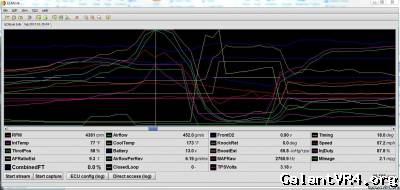

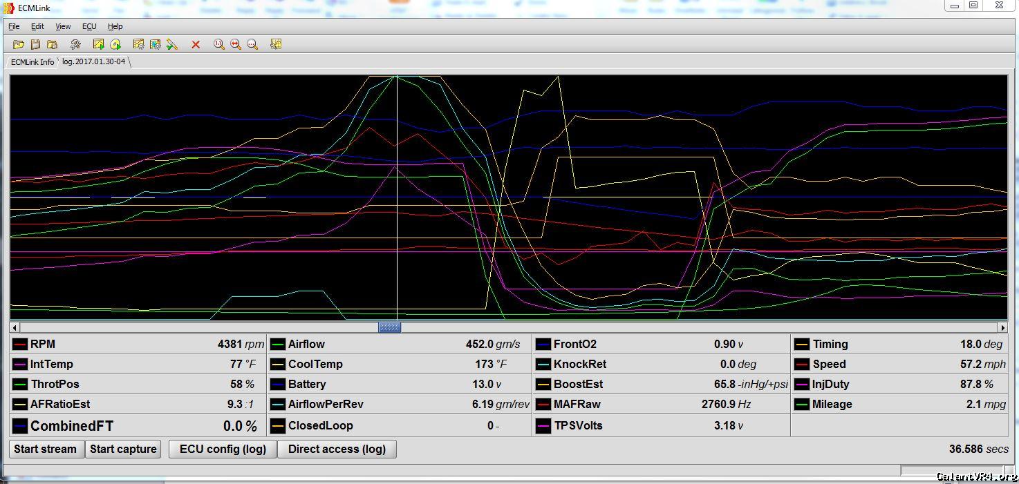

While getting on the freeway I decided to try and get a WOT log in. The results were not what I expected. Once @ 4500rpm it fell flat on its face (felt like fuel cut), but the logs show over 60lbs boost??

First WOT attempt on the galant. Log shows I peaked over 60psi boost @ 4400ish RPM? Not sure what I am missing here. Needless to say, she fell flat on her face when that happened. It felt like fuel cut, but it never leaned out. Injectors even hit 88%. All things point to the fact that I did hit that boost, but I would think the e316g would blow into dust at that pressure.

You'll need to post the entire log if you want help. You can host it anywhere and simply link to it here. Dropbox, or ant FFU site will work.
BoostEst is not actual boost. It's calculated boost based on the parameters the ECU sees. My guess would be your MAF compensation is way out of wack, and the ECU thinks you're moving way more air than you actually are. You'll need to add a MAP sensor if you want to log actual boost.
Also, I don't see a WBO2 being logged in your display. If you don't have one, I'd advise getting one before trying to dial in the tune any more.
Your target AFR displayed in your screenshot is 9.3:1. That's way too rich. You should be shooting closer to 11.0:1 on pump gas.
Post an actual log of a 3rd gear pull from ~2.5k to redline (with a WBO2 enabled) and I can provide some worthwhile feedback.

Just in this screenshot i see some issues.
TPS is only showing 3.18V. Far from WOT, yet IDC is already 88% at only 4400rpm.
I don't think it's remotely possible that turbo is flowing 60lb/min at 4400rpm, either.
There's also knock just prior to your marker. Timing looks flat across that range. Could be rich knock.
