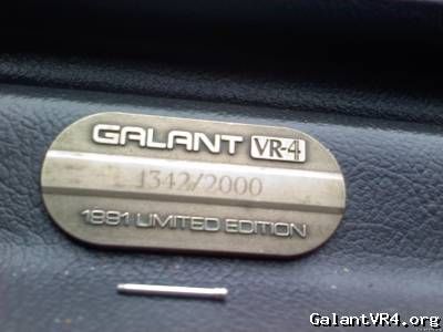

snohacking
91 Galant vr4
1342/2000

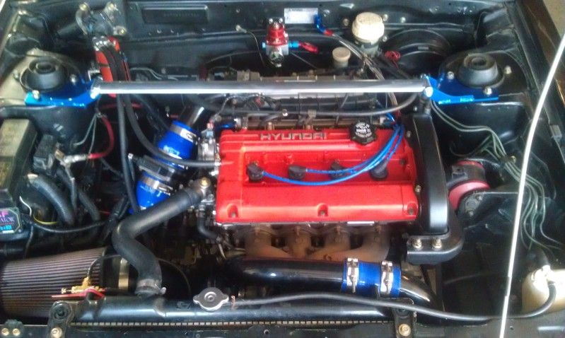

Engine
• Stock 6-bolt with around 110xxx miles
• 1990 oil filter house and oil cooler
• balance shafts removed
• Arp head studs
• Cometic MLS head gasket
Head:
• 2g head port matched to a 1g intake manifold
• BC 1mm oversized intake and exhaust valves
• BC spring and titanium retainer
• Ferrea bronze intake guides
• Ferrea Copper alloy exhaust guides
• Ferrea valve keepers and valve seals.
Fuel system
• 1200cc precision injectors
• full blown motorsports dual fuel hanger with two 225 walbro fuel pump in tank
• -10an feed line with -6an return
• Fuel lab fuel pressure regulator with ss line
• Fuel lab fuel filter with ss feed line
• -10an magnus fuel rail
Turbo system
• Hx35 6-blade with .55ar bep housing
• FP 4” polished intake with 9” K&N filter
• ETS intercooler kit and piping with 50mm tial bov
• FP exhaust manifold
• Punishment Racing SS Recirculated O2 with 38mm tial wastegate
• Megan 3” down pipe
• 3” cat back to vibrant black 3” dual tip muffler
• SS feed and return line
Suspension
• D2 coilovers
• Cusco front and rear strut bars
Interior
• 2g shift ball
• Old school alpine radio
Engine Management
• Dsm link v3 with gm maft cable
• Gm 3 inch maf
• Autometer phantom boost and oil pressure gauge
• Innovate motorsports mtx-l wideband

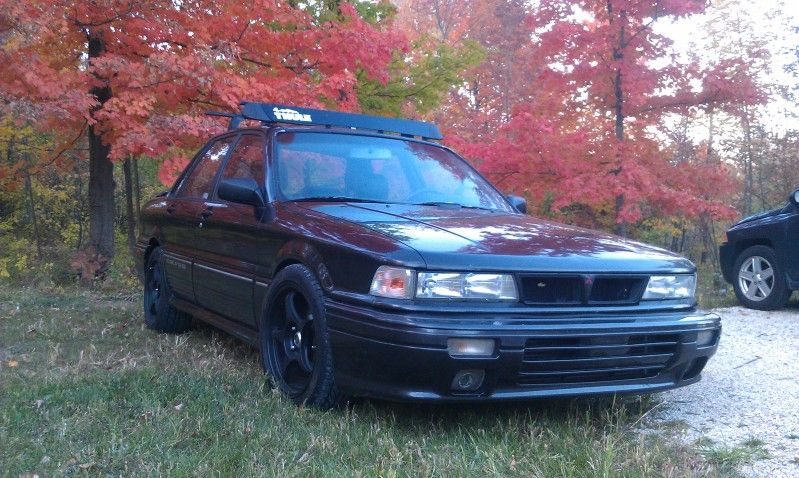

Exterior
• 5zigen fn01r-c matte black rims with hankook evo v12 tires
• JDM Replica door decals
• Galanvr4.org badge number window decal
• Thule roof rack
• JDM clear corner lights
• 93 headlights
• Wisconsin hobbyist plates

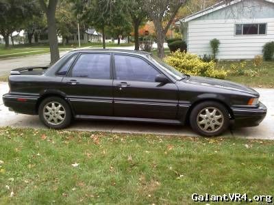

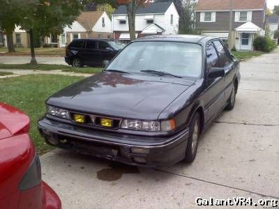

The day I picked her up

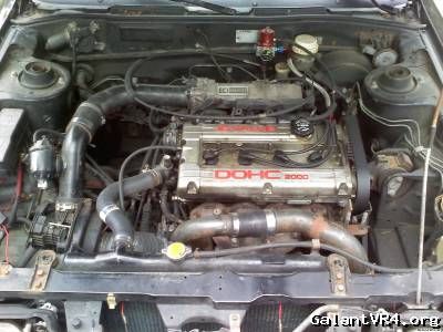

Before pics

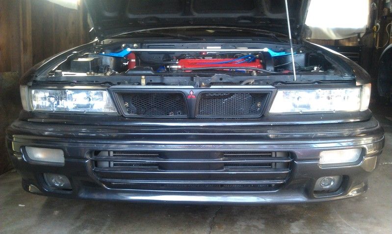

After pics
