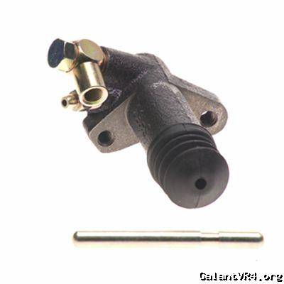

I bought a master and slave set off of ebay for a 90-93 DSM. The Slave I pulled off the car had a green piston and the orientation of the bleeder screw and banjo bolt was opposite. This is how the two bolts sit. Made bleeding easy since the bleed screw faces the bottom of the car.
The one that came with the kit is a DSM part number (didn't know that DSM slaves and GVR4 slaves were different until after I bought it).

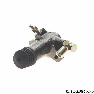

It is harder to bleed because the screw is at the top. I had to bend the clutch slave line a bit (didn't kink it) to make it all fit.
This is how the bolts sit:

They aren't different. What you likely have is an NT slave cylinder. The red and green are piston sizes and yes it makes a difference. I can't remember why the bleed is oriented differently but you must get a slave for an AWD car.

Did a bit more research and I found some interesting stuff. It seems that the 92 GVR4 and 1g slave's throw is further than the 92 GVR4 and 2g slave. I think that the DSM slave actually has the bleeders oriented differently. I still think that I do have a DSM AWD slave...but the orientation is kind of confusing.
Check this out....
Here is what I ended up with......

I bought a box store slave a few cars back and had this come up. The one I got with this orientation failed pretty early, but others have held fine. Next time get OEM for hydraulic stuff, but, it'll work fine.
The green piston unit you're replacing has less throw than the red/pink/gold, so you're either 'same' or might need to adjust clutch a bit under the dash. You'll be under there sorting that master cylinder stud anyway.
