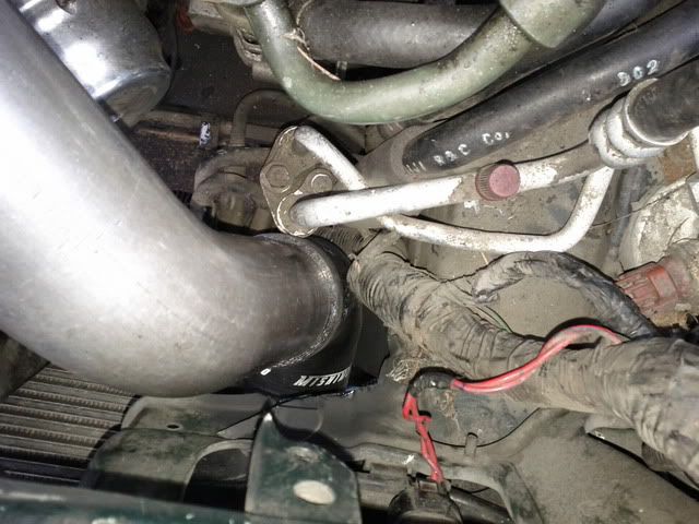

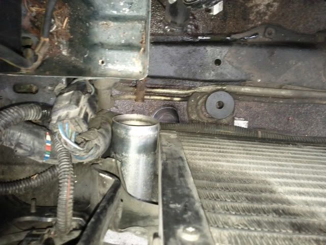

my install ~> click
looks like i didnt take/post pics anywhere of what i had to cut/hack. i did however find...
note that both those are test fits. i cut the battery tray cuz my battery is half OEM size and it looked funny and slightly in the way.
also like i said before, i have a 1g Koyo radiator in my Galant. i trimmed the radiator/brackets and slid it over a little.
