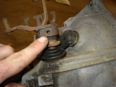

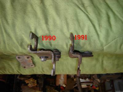

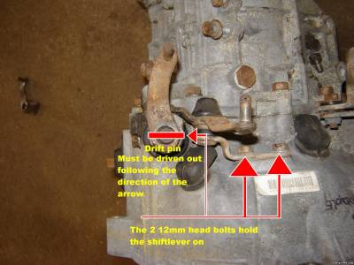

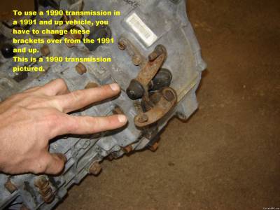

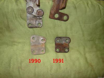

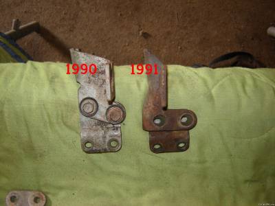

Just so you know, The transmission cases are the same! You can run a 90 in a 91, or vise-versa as long as you swap out the brackets and and shifter arms. The shifter arms are the only reason why the cables dont work when you do this swap.
YOU DO NOT HAVE TO CHANGE THE CABLES AND SHIFTER BASE!!!

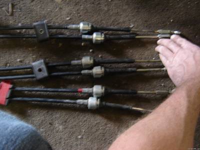

I labled these as brackets in the picture, but ment to call them shifter arms!vv
Here are the cables sitting next to eachother. The top ones are from the VR4, the second set down, are from a 1991 and up DSM, and the third set down are from a 1990 DSM. The VR4, and 1991 and up DSM are the same. The difference in length between the 1990, and the vr4/91 up, is roughly 1 3/8 of an inch on only one of the cables. The other cable is the same length.
