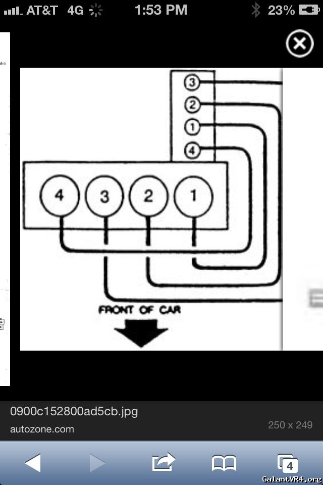

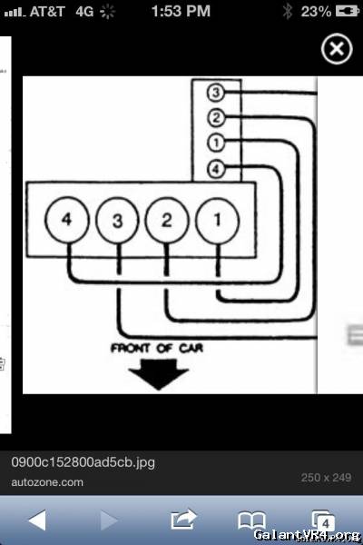

prove_it
Jul 3, 2008
4,201
Sioux Falls, SD
I would also see if you can find someone local near you to help out. Another eye can make the difference.
Codes are bogus. Have you checked the plug firing order? Maybe they pulled plug wires and swapped the companion cylinders.
