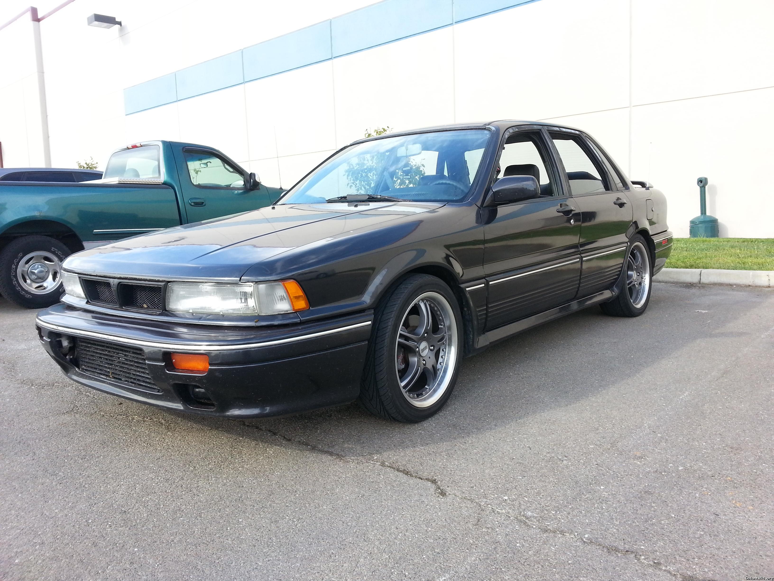

Current specs:
91 Nile Black, 190,000 miles on chassis 70-90,000 on JDM engine
-H&R lowering springs
-KYB agx shocks
-slotted front rotors
-hawk pads all around
-braided stainless brake lines
-Maf translator with 3in maf
-2.5 inch aluminum intake with cone filter
-blacked out Front mount with 2.5 inch polished aluminum piping
-JDM throttle body with FIAV blocked off, ISC blocked off, going to reinstall ISC but leave FIAV blocked.
-JDM engine with Cyclone manifold wired up to work using a summit racing RPM switch, set to open butterflies at 3k rpm
-blacked out stock grill
-1990 Oil filter housing with external oil cooler
-Greddy RS BOV
-3 inch turbo back with 4 inch slant cut tip, pretty quiet
-Exedy street disc
-Fidanza aluminum flywheel
-Wallbro 255
-battery relocated to trunk
-660 injectors and 14B turbo through stock USDM ECU, 15psi and pulls very cleanly.
-17" SSR reps,ummer
