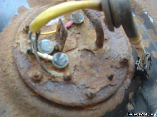

Well I have been able to remove 3 of the nuts, however the rest are falling apart before I can even get any torque on them.. I have been soaking them in PB Blaster though I think this not helping much because the nuts are rotted.
Are there any special tools that would be recommended?

I got em off with this..
Though the metal hose cracked when I attempted to loosen it /ubbthreads/images/graemlins/banghead.gif ..
So I will still need another sending unit.

yikes that is just bad!! I would power wash it then soak it with PB blaster for couple of days.

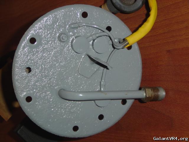

Seems there was a member on here recently that sent his fuel sending unit off somewhere and they were able to clean it up and it looked brand new afterwords...BobDole maybe?

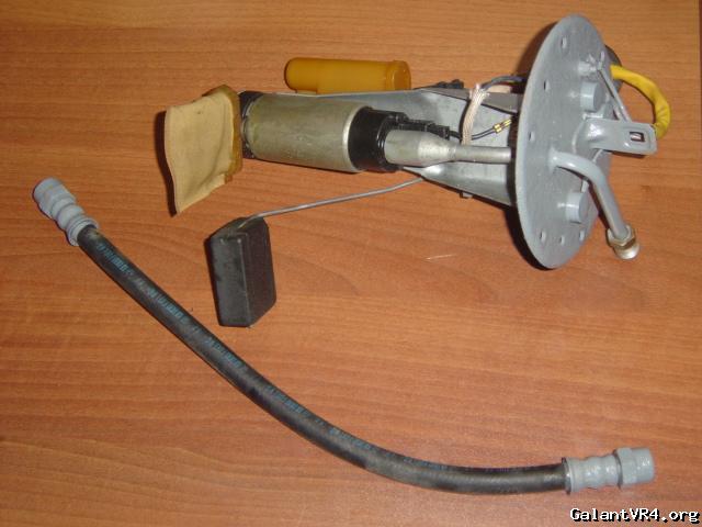

I will have to look up the place again. Here are before and after pics. They did a great job.
Before.
After.

I agree with what Yao, that PB is good stuff for getting bolts loose man
10,992
I did one car with Kroil, over and over again for weeks, The nuts came right off. Second car, not so lucky. Broke two of them. Should have been more patient or cut them off carefully.
