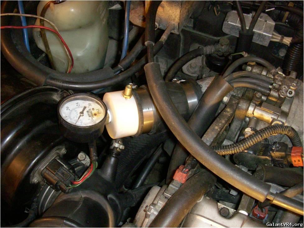

4) Boost Leak Test (BLT) – Note: you need to position the crank at 30 degrees After Top Dead Center (ATDC) before you start to prevent being in a valve overlap condition; this is where both the exhaust and intake values are open at the same time in the same cylinder. I performed a BLT by starting with the area behind the Throttle Body (TB) with some soapy spray to determine if there were any leaks in the TB gasket, BISS screw, TB shaft, intake manifold gasket, injector insulators, brake booster, air side of the FPR and all vacuum lines/connections. This also lets you help hear leaks cause by the Pressure Control Valve (PCV), valve seals/guides and rings by taking off the oil fill cap. If you put your ear next to the end of the tail pipe when you pressurize the system (I do not recommend going higher than 20 psi) you can also pick up leaks cause by the Exhaust Gas Recirculation (EGR) value, valve overlap, burn or unseated valves or bent valves caused by a broken timing belt. Here is a picture of my home made BLT in place: (I can put together a quick article on what it takes to make this BLTer if it would help someone out).

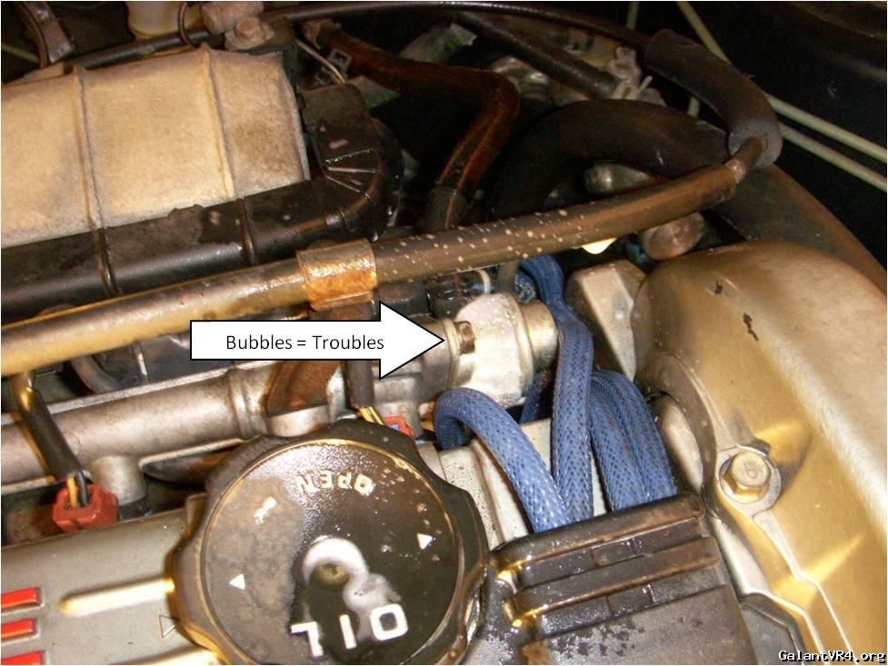

6) Next, believe it or not I found a leak around the replacement FPR, see picture below:

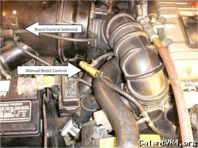

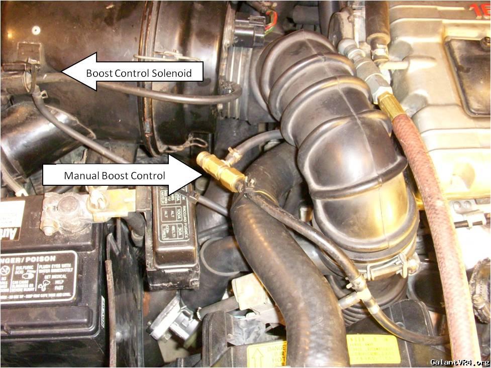

9) I started to wonder what pressure my waste-gate was starting to open up at. After a few hours of forum research on this site and www.DMSTuners.com I found that the waste-gate along with the Boost Control Solenoid (BCS) device that really determines what your boost pressure will be during hard acceleration. THE BCS is the two port electronic solenoid on the stock air cleaner housing closest to the stock battery location or front of the car. A good factory waste-gate opens at about 9 psi and the BCS increase the factory boost to about 11 psi if everything is working. With a 0-15 psi pressure gauge that I pickup up W.W.Grainger I was able to verify this. (detailed steps/procedure not included). You don’t have to read very long on these forums to quickly figure out that you would be doing yourself a big favor by installing a Manual Boost Controller (MBC). These MBC’s allow you to increase your boost over the stock setting. You can also get an electronic version that can be controlled inside the car but I happened to have on that I found on a parts car we bought. It is simply a ball and spring one way check valve with adjustable spring pressure. After some playing around with the MBC on the bench with a pressure regulator, pressure gage and an air supply I was able to get an initial setting of about 12 psi to start. I then installed the MBC between the waste-gate and the hose that comes off the j-pipe on the high pressure side of the turbo. You can disconnect the BCS hose that goes to the T-fitting in the high pressure hose. This is where I installed my pressure gage to check the boost. You could also use this location to connect up a boost control gage if you want one inside your car. (all these hoses are 3/16 or 7/32 small diameter hoses). Here is a picture of the MBC I used to test out the effects ….
Conclusion: 360/2000 is no longer stock but the MBC valve did the trick; the car pull harder now then every before. The car runs so good now that I may get wrench happy next winter and rebuild the motor with a bunch of the performance mods I read about on this site. I still need to get a replacement FPR so if anyone has one for sale let me know. I checked at NAPA but they have two versions, one set at 50 psi and another set at 51 psi; both are higher than the factory spec so I hope to find a good used one.
