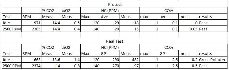

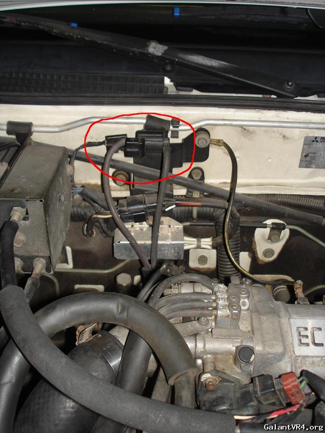

Went to go get the car smogged and since I had no idea what the car would do since I bought it out of state I had a pretest done. It passed with flying colors, but they said the timing was advanced to 15. They also found a sensor unplugged and plugged it back in before running the test for real. They set the timing to 5. Apparently these two things killed me, as now I am a gross polluter on idle for the HC. The thing that kills me is that it was idling like crap after they set the timing and never adjusted the idle screw. So I am thinking the combo of this and maybe what ever the sensor is might be what made my HC bounce up.
Anybody know what this sensor is for?
Thanks in advanced to anyone that helps. I can send hand made PB&J's through the mail for help
