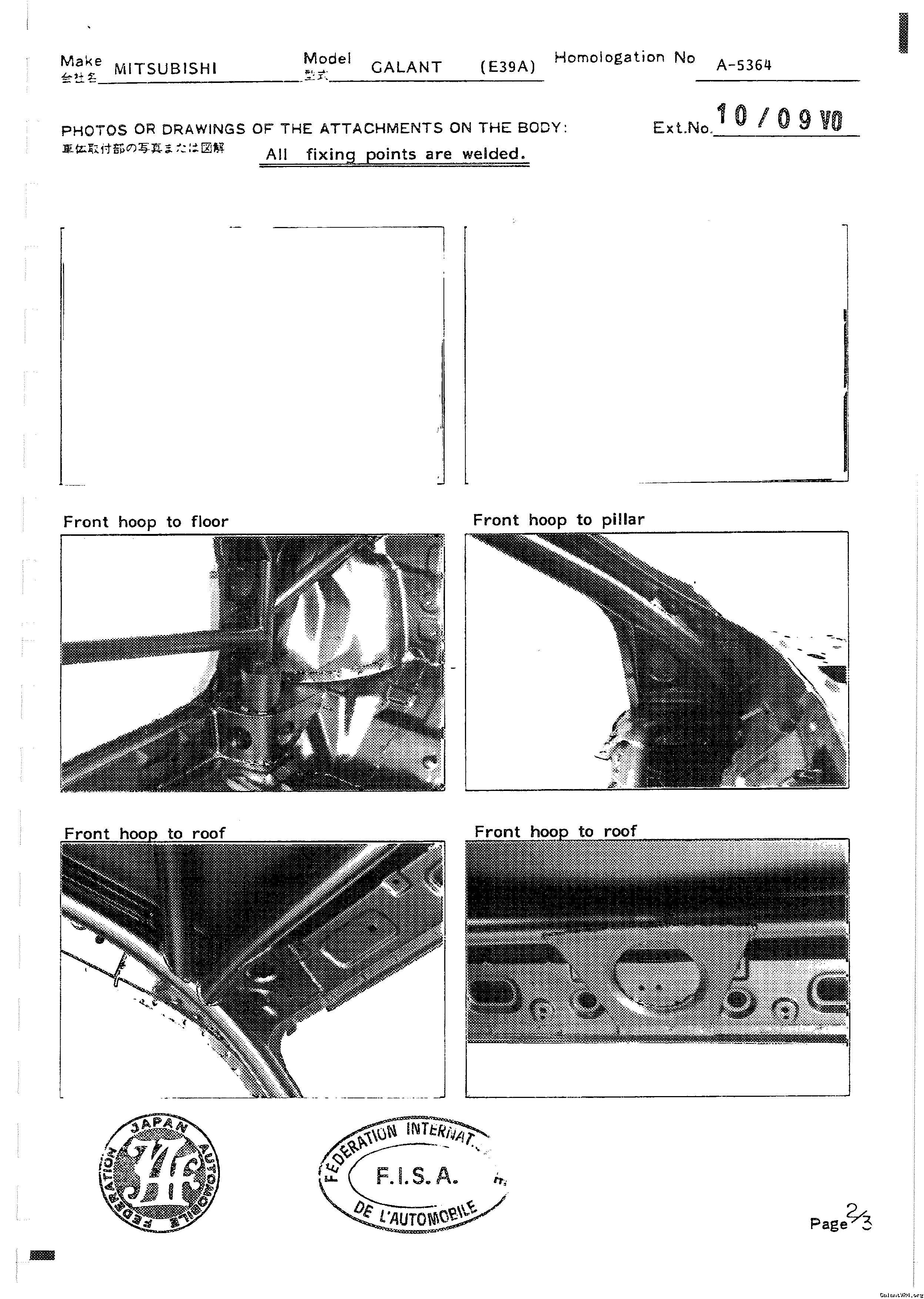

Look in the homologation papers i posted. all of the safety devices and ralliart group a cages are shown explicitly in there.

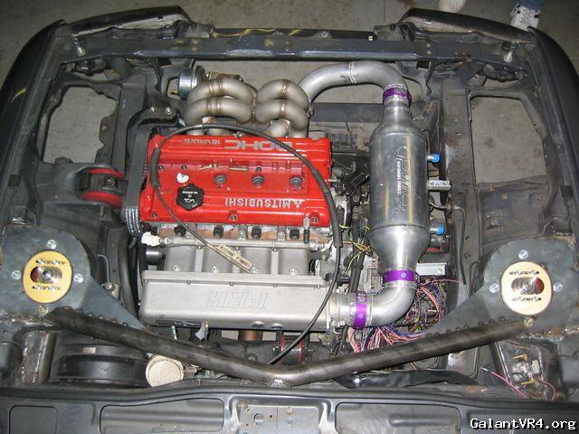

Brian hooking the strut towers in really helps and I plan on doing it as well but really the best way to do it is cut out the area oversized do the tube and then replace the sheetmetal with 2 pieces of sheetmetal with a half circle in each if that makes sense. you could also replace the whole area with thicker metal that has been bead rolled behind the brake booster and the clutch master to get rid of firewall flex.
Then build your own strut tower brace that connects to the firewall as well as across you could also tie the firewall to the dash bar while your at it. But might cause you to need to remove the dash.

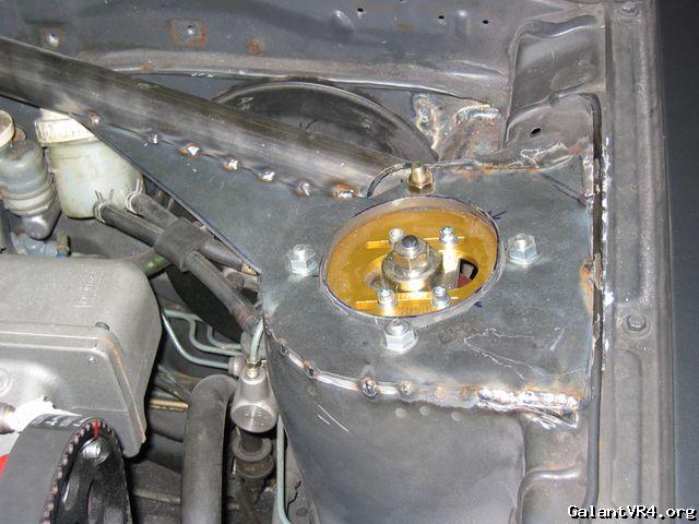

And thank you for your advice as well, Curtis. Dimple-cut gussets are on the agenda. Easily A-pillar, B-pillar, but I also like the rear strut tower brace in those pictures and will be looking to do something with that stuff under the dash for leg protection.
here are some pics

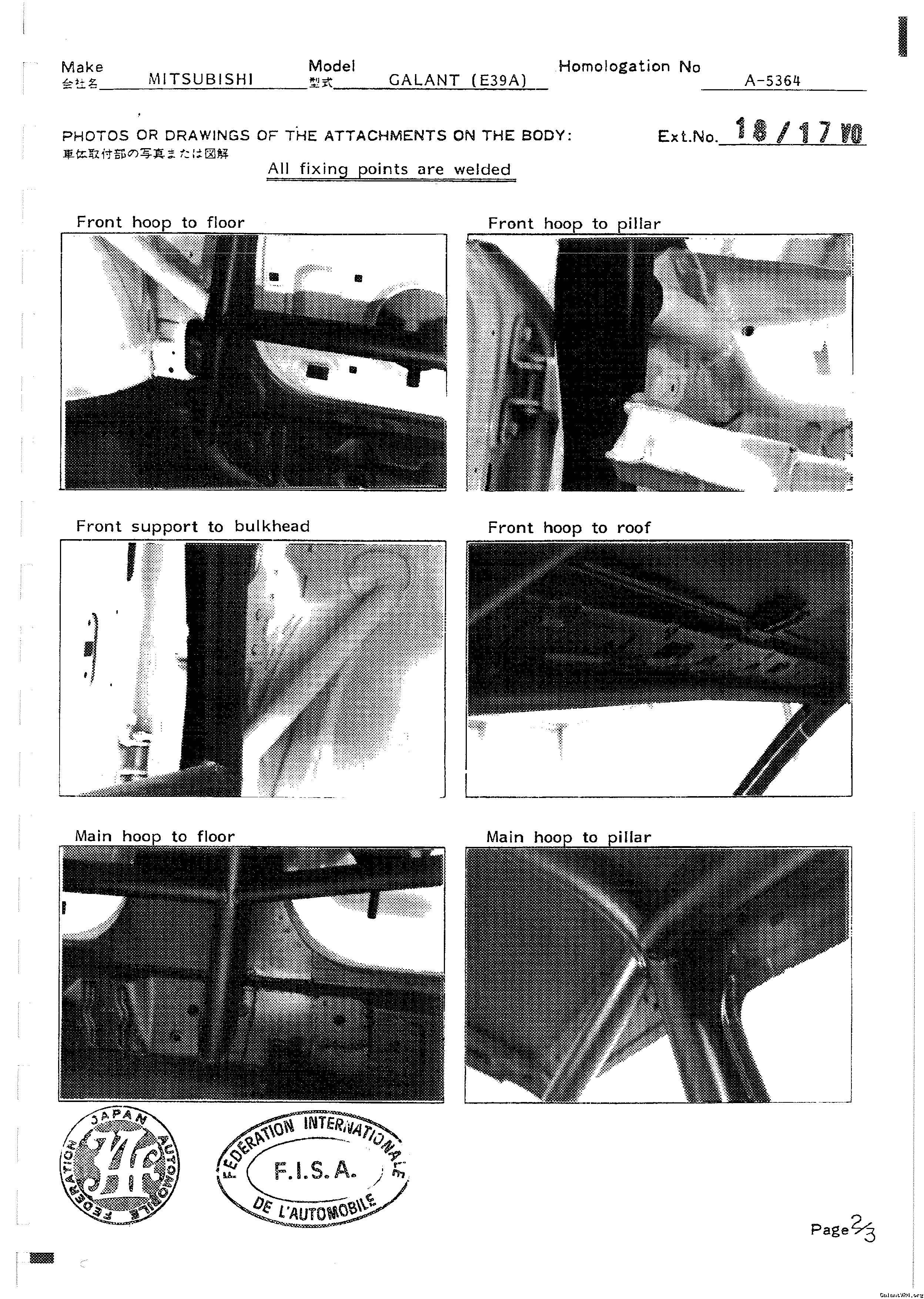

Sorry, forgot to mention its in the library!

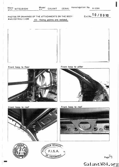

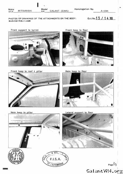

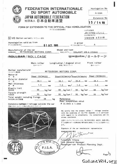

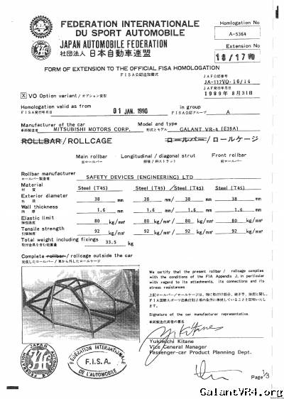

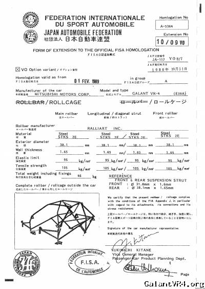

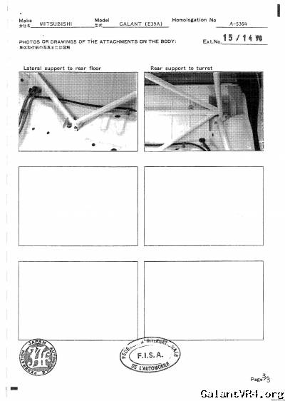

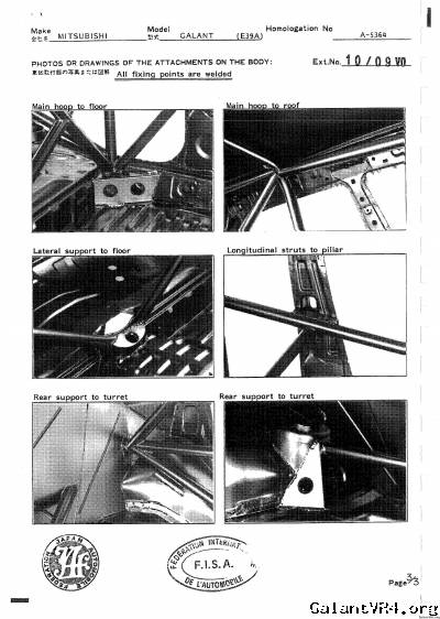

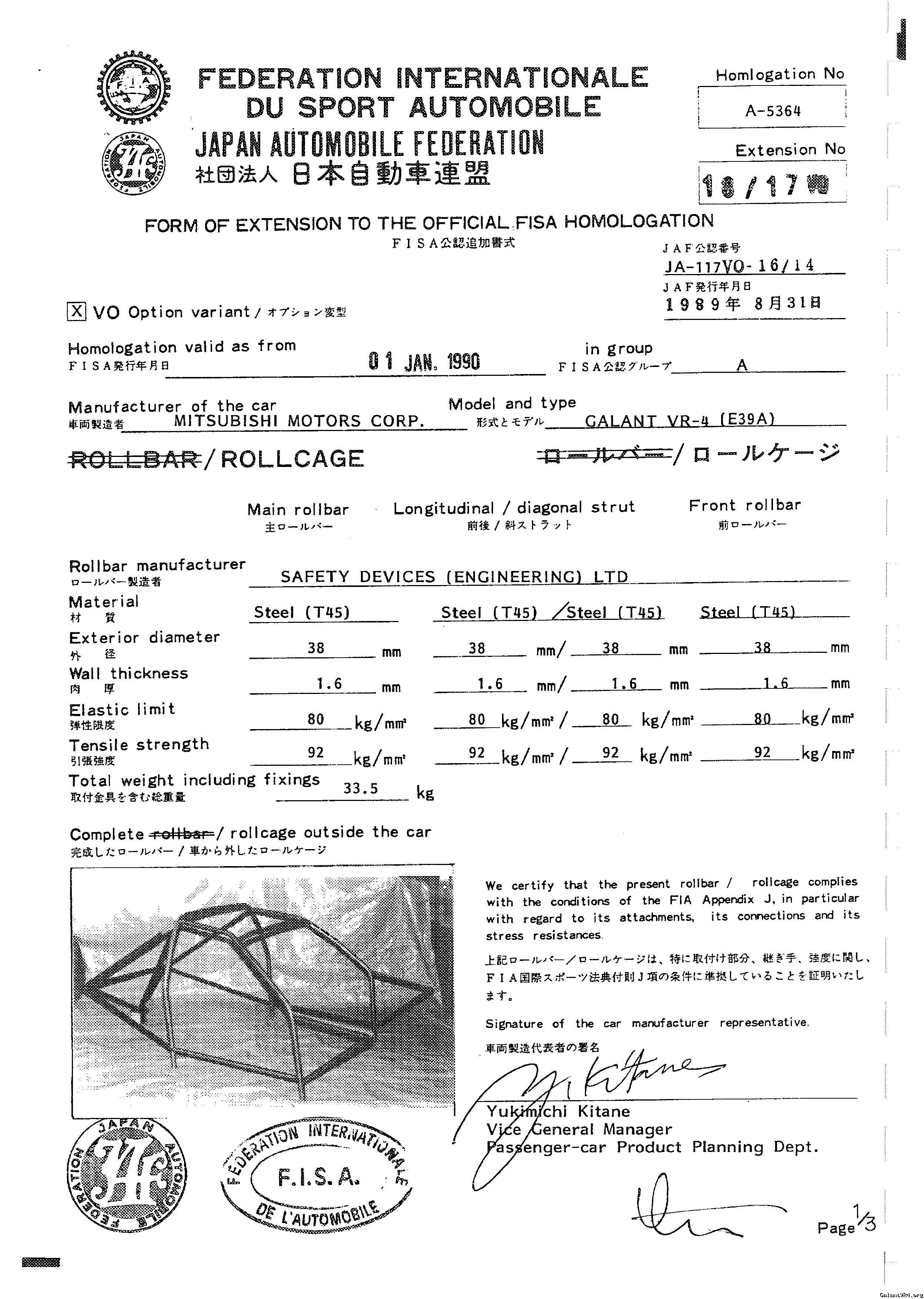

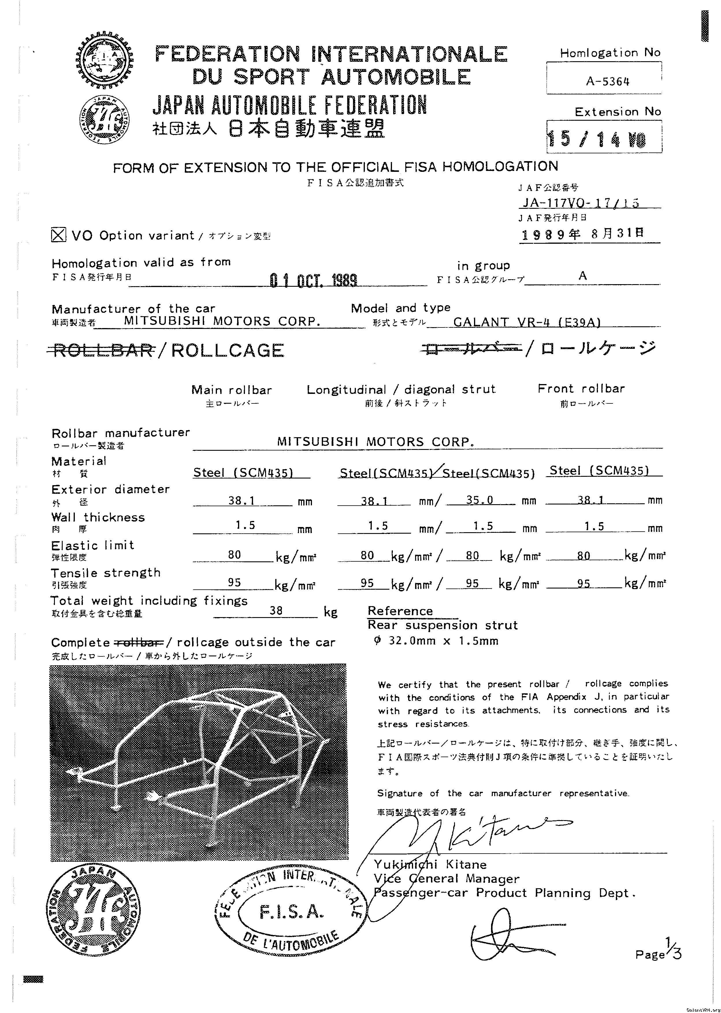

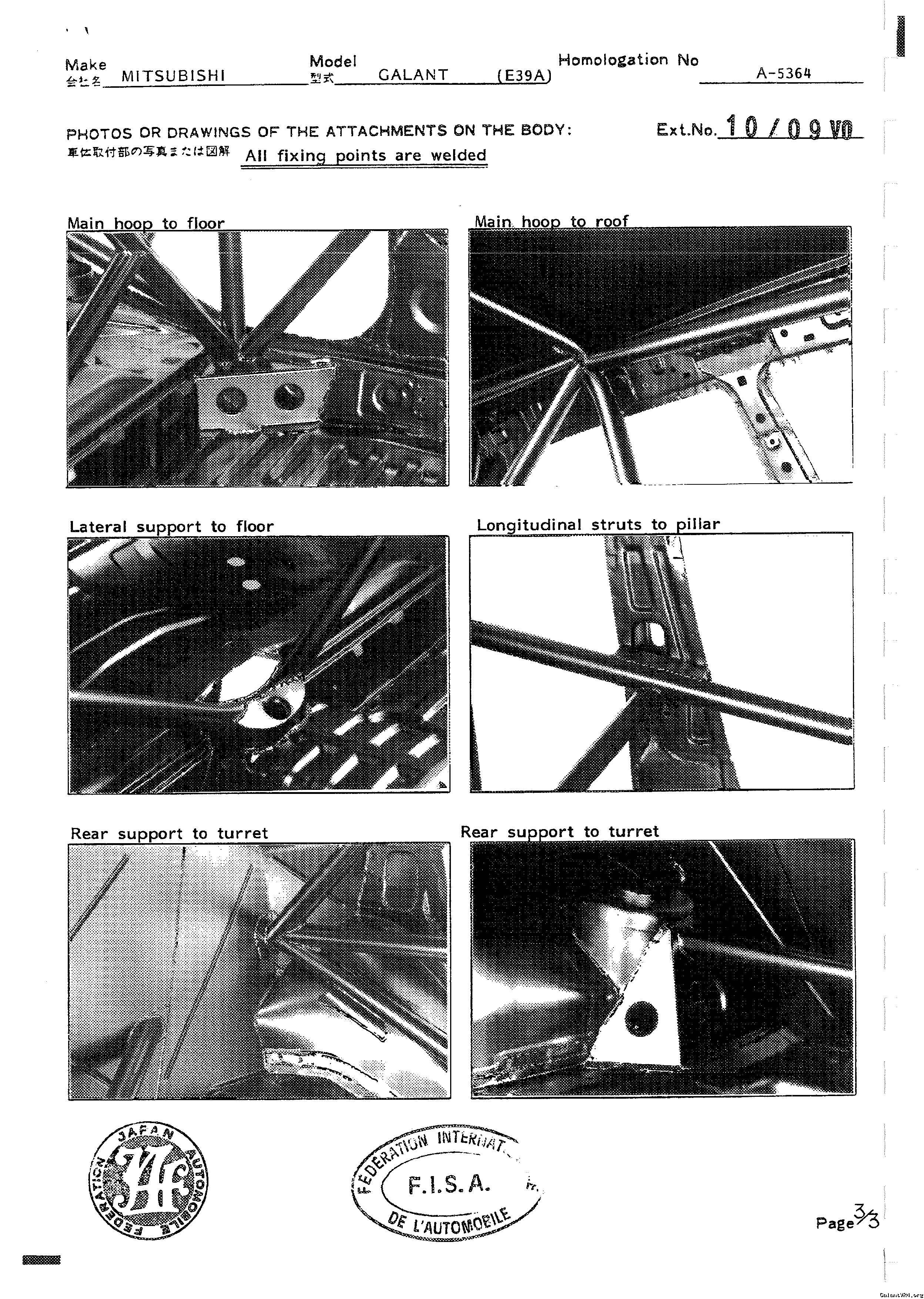

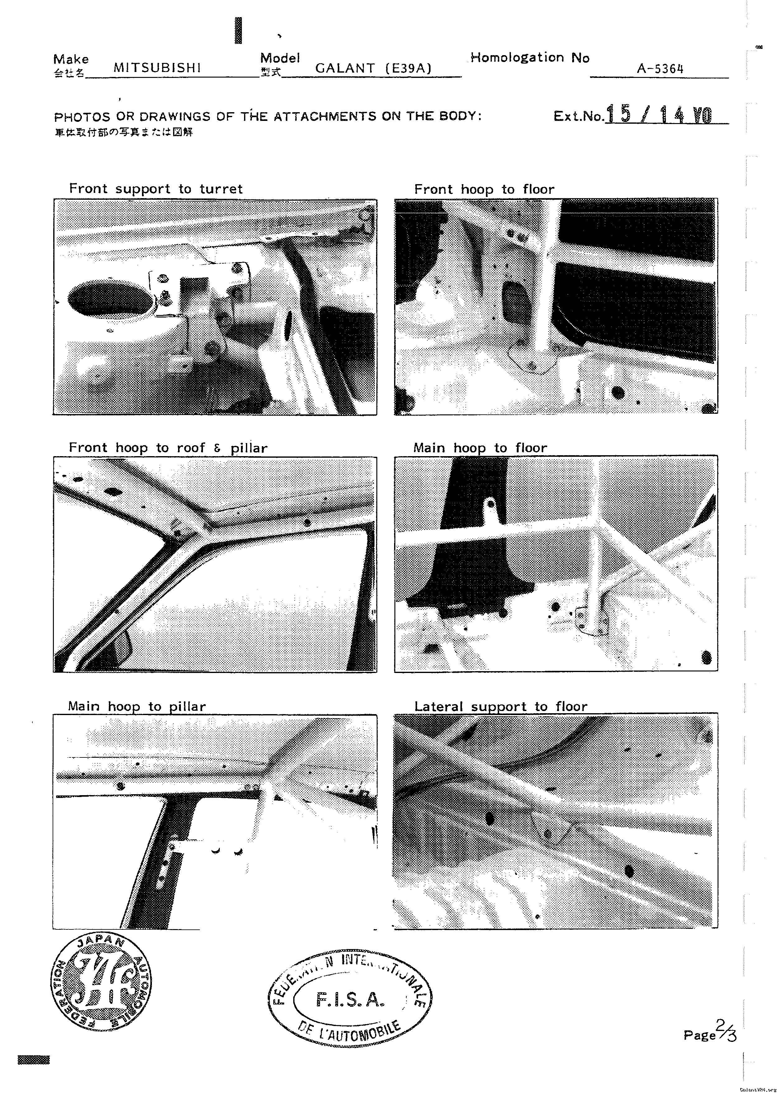

Anyhoo. Here are the last three steel cages. Mitsubishi motors, Ralliart inc. and safety devices. The earlier aluminium and bolted cages were outlawed so these are the welded ones.
1
2
3
The earlier one (2) should show the tower connection, the later ones are similar.. and it literally is straight through the dash through the firewall to the turret.
Hope this helps,
Rich

Thanks for posting the individual screencaps, Rich.
Obviously, none of those designs are legal for rally competition anymore (especially not here in 'Merica). So many dead tubes and flimsy-looking bolt-in bits. /ubbthreads/images/graemlins/uhh.gif (shudder) I did like the shots of the boxed-in rear turrets and the triangulation up to the front turrets. Perhaps I can swing a few extra bucks and talk Kent into door and sill bars (which would allow me to see about getting a log book issued). Those would make excellent points to tie into the front turrets.

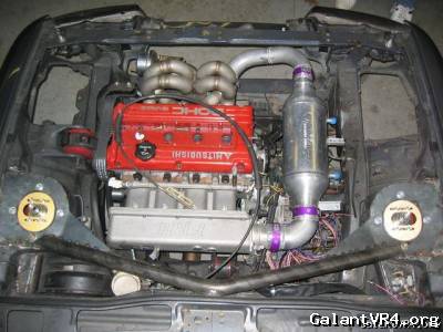

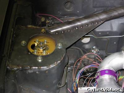

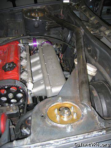

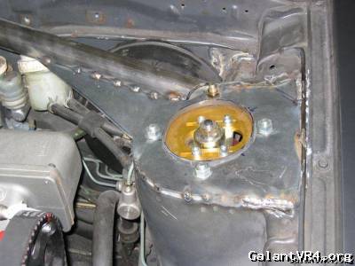

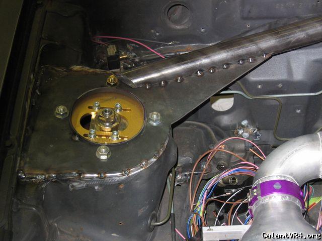

Ducktape, that's a beefy tower bar! Dig the strut tops too. I like the triangulation to the center of the firewall, but suspect there might be an intrusion risk after a couple hard landings. You get that thing airborne at all? How is that center bit supported? Do those diagonals pass through to the ends of the factory dash bar?
My buddy with 82/2000 (it's a rally car) took a 3ft deep water crossing at speed and made it through, but as his front end isn't tied into the cage, the front end took a head-on and downward hit. Now the nose is sagging, buckling the fenders, and the sidemembers are separating from the firewall, even tearing the wire harness. I'd be concerned bracing the front turrets without tying them into the cage structure could get hairy in a head-on or front 3/4 shot.

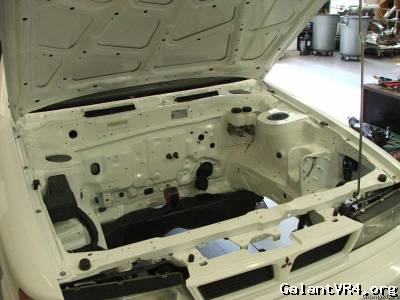

By the weekend, I intend to take a good, long look at the firewall in these locations. Wires can be easily (albeit, painstakingly) extended, but punching pipe through the firewall will take some planning. I like the simplicity of fender bars (which tie the outside of each turret to the door hinge locations), but nothing beats a fully integrated cage.

Yea strut tower bar is sweet. I have pictures of Larry's car and others on the harddrive some where, it will take some time but I'll post them up if I find them.

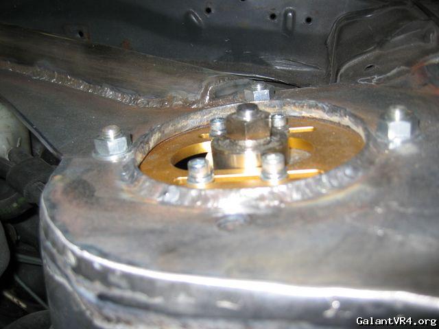

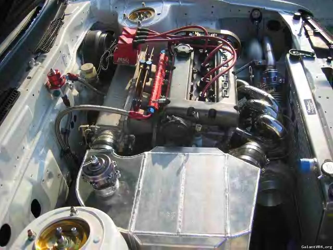

I opted to NOT tie them in due to the added headache... I plated the tops with some waterjet .250 plate and left it at that. I didnt notice any issues, but it can help when you stuff the car in the woods.

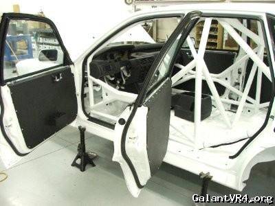

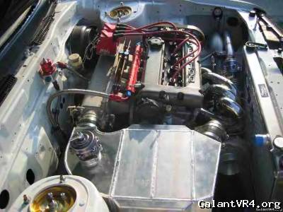

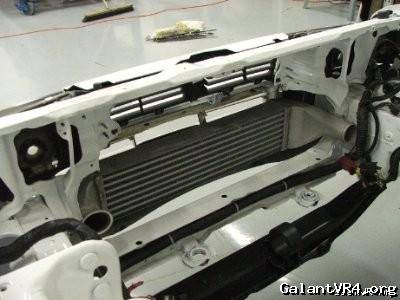

Quoting curtis:
This is why I'm running the SRT4 IC (and the picture what helped me figure out how to install it.) As Larry said, it fits nicely around a DSM radiator. Considering they can be had for $20-$50, I might pick up a spare or two.

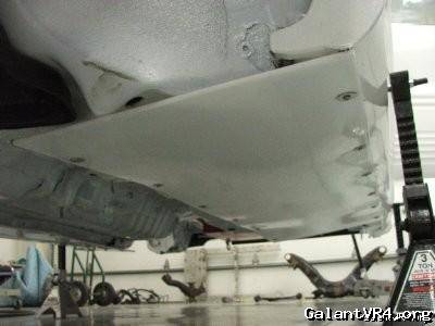

Quoting curtis:

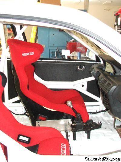

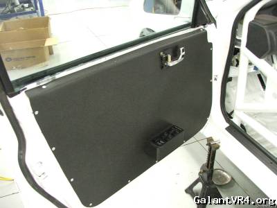

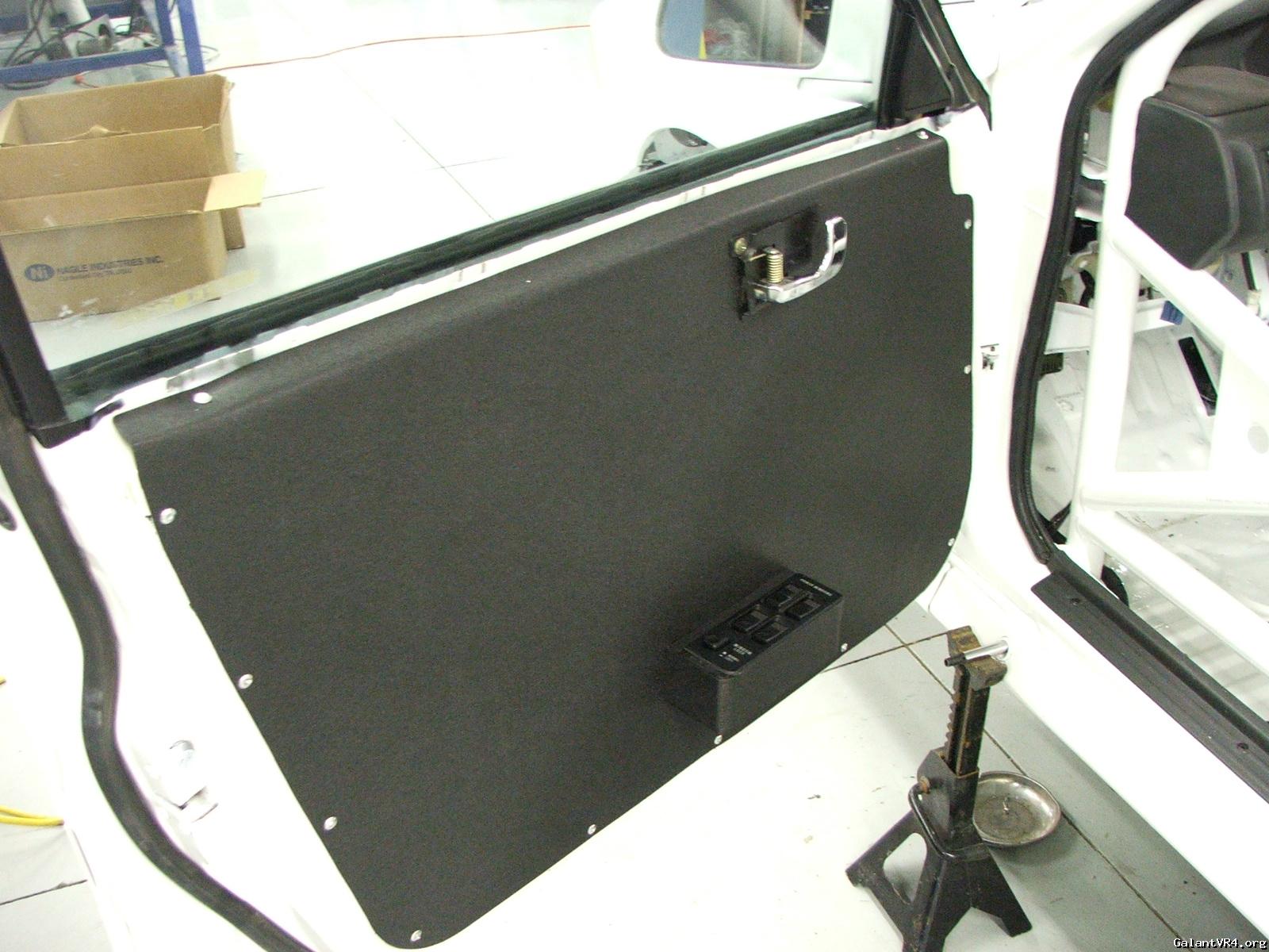

First thing I notice - door cards. I need to figure something out. Saran wrap with gooey black tar can suck it, and factory door cards won't fit. Those are really nice and suggest it's best to wait for the door/sill bars to be installed before finalizing their design. (Though I would like to know the material used for those...)
I also notice the door bars. No doubt, they're solid, and I like the double bar action, but I think I'll opt for more of an shallow, gusseted X in that location.

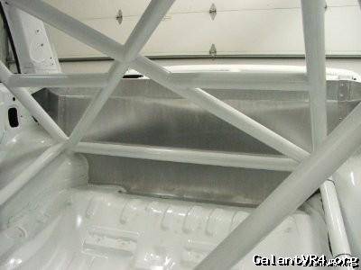

Quoting curtis:

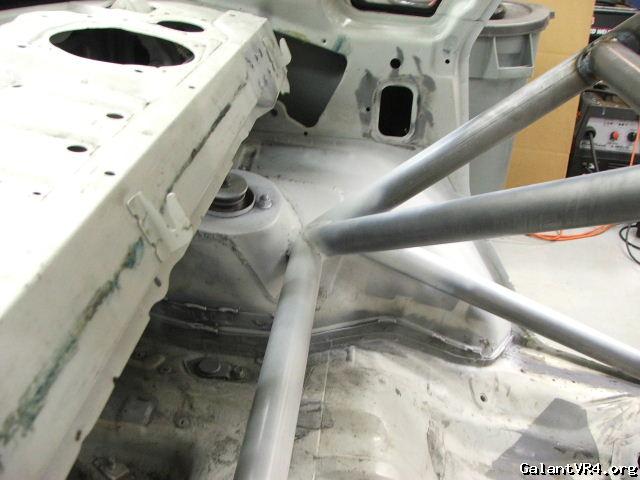

Looks like Larry ran the harnesses all the way back in the car. Very nicely tied together back there, although I can't make out how the cage is tied into the rear turrets in that picture. Looks more like wheel wheel (which is dome-shaped, and likely on the stronger side). The bulkhead between passengers and fuel cell is clean as well.

Elevated shifter and e-brake are on my #todo list fa show.

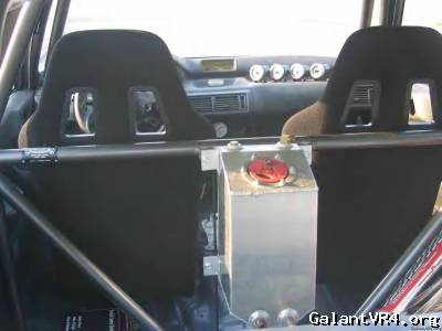

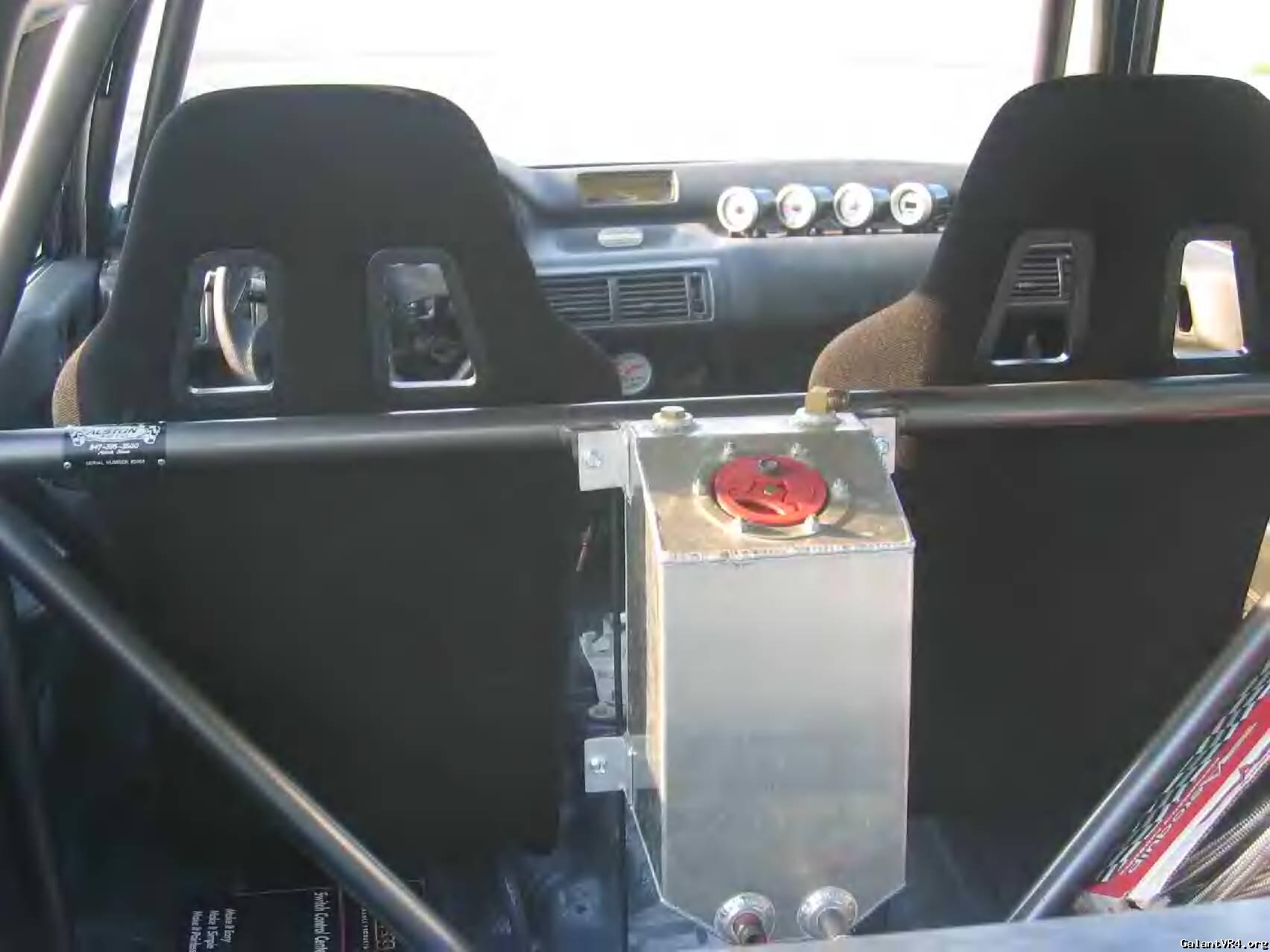

Please tell me that's an ice water reservoir for the AWIC or cool suits. That can't possibly be a fuel cell. Who would think that was a good idea?

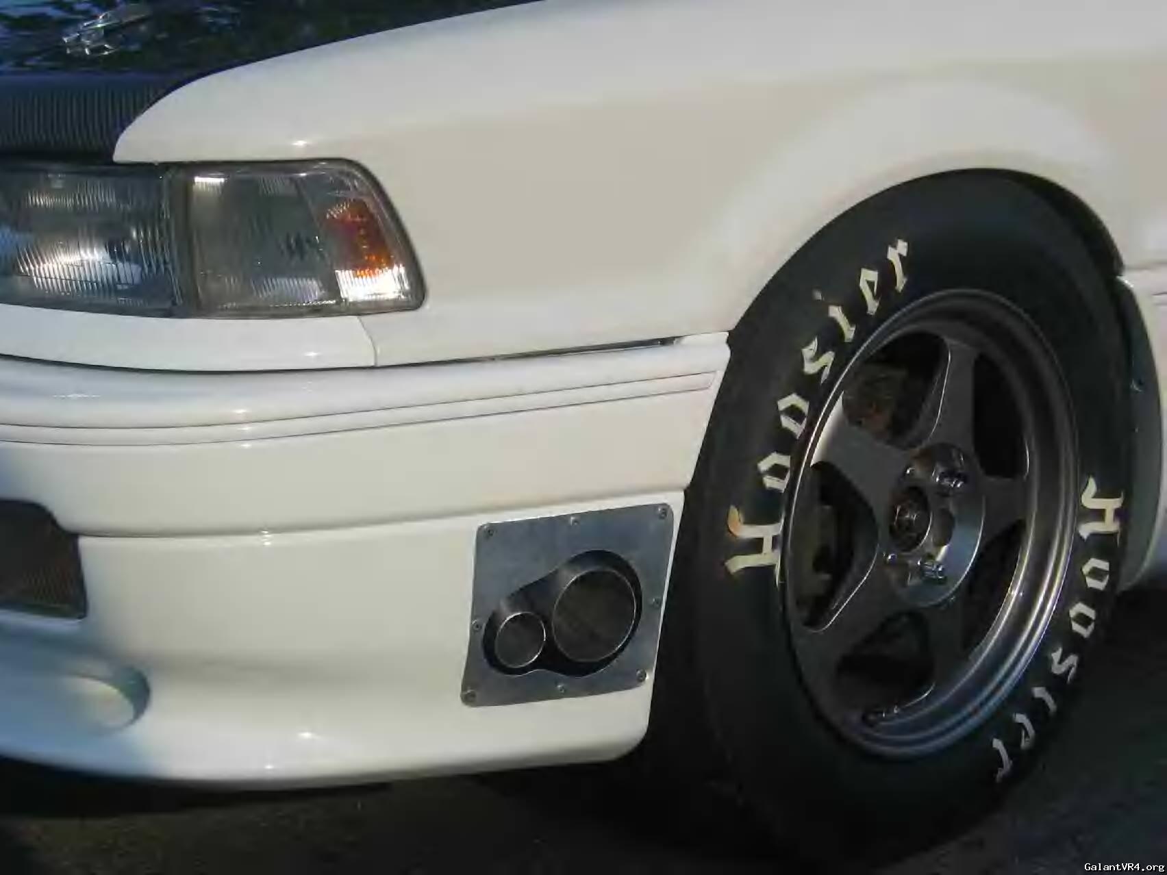

Quoting curtis:
Illegal in rally. Exhaust must exit behind the driver/co-driver. (But cool for sure.)

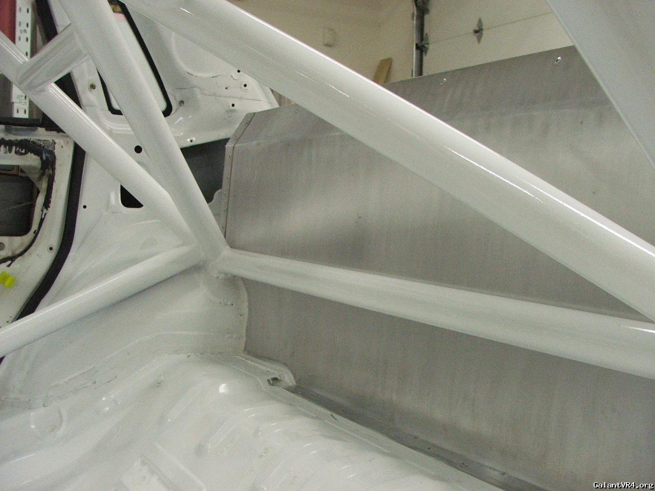

You can see a bit more of the rear towers here along with the fronts... Door cards where made from 1/8 textured ABS plastic from a local source...
