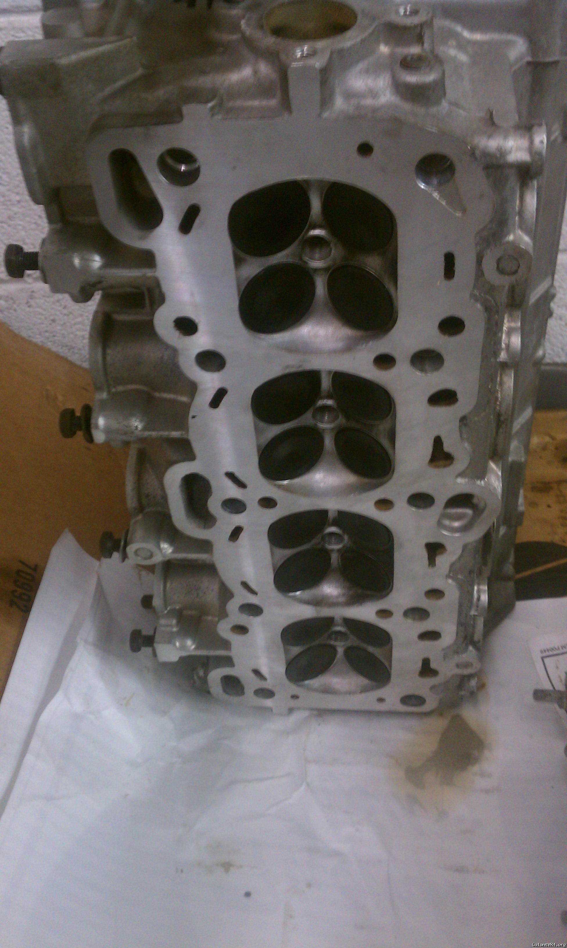

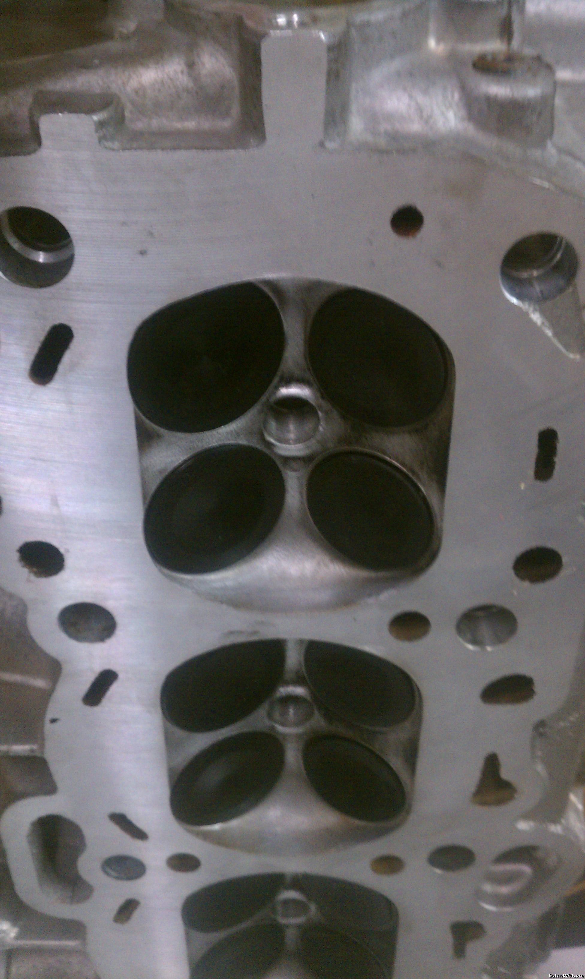

After you pull the head, take some pics for us, and have the head checked for cracks
crap phone pic...droid 8 mega pixel camera...click to enlarge.
