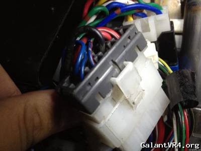

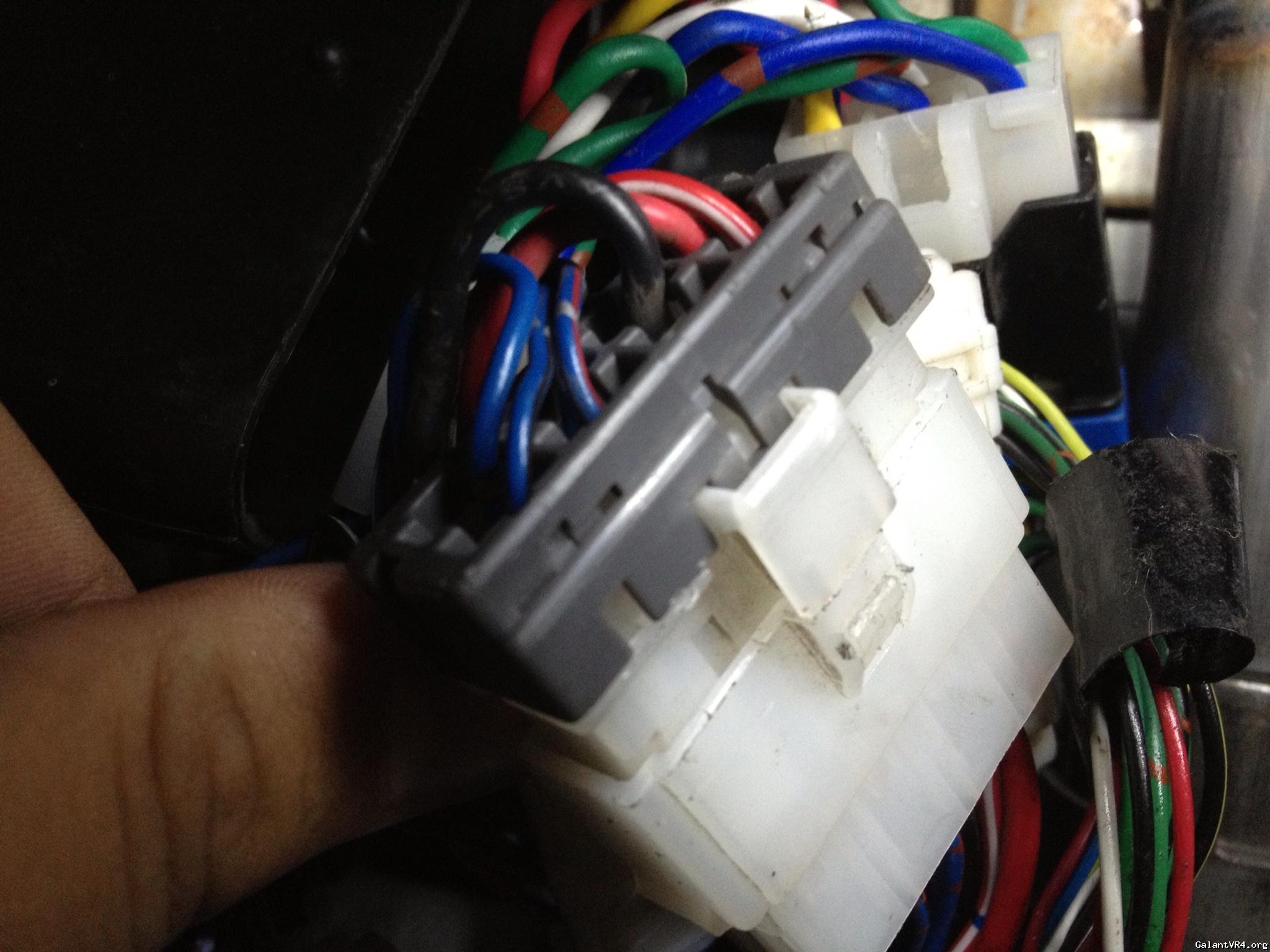

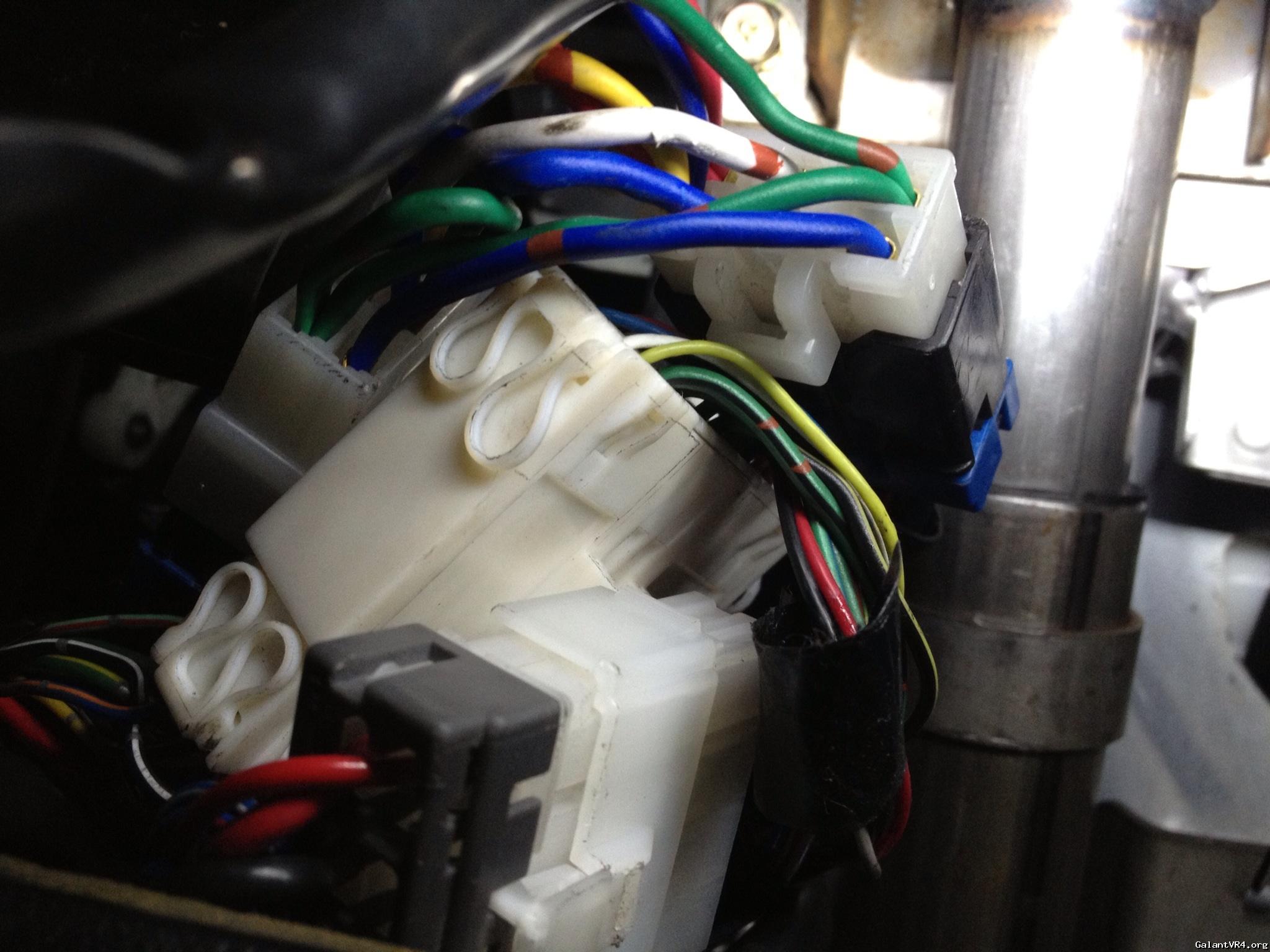

I'm am stumped. I had my clutch pedal rebuilt. I put it back in and hooked up all the harnesses. My turn signals nor hazards will work. No blinking or anything. The high beams turn on along with the headlights so the lever must be connected. I checked the 10 fuse under the dash and tested it with the volt meter and it's good. Swapped it out for another and nothing. I took apart lower dash cover and steering coulomb cover to see if I notice anything disconnected but I don't see anything. I unhooked all the harnesses and took the turbo timer out to take it out of the equation an hooked it all back up and still no go.
Any ideas? /ubbthreads/images/graemlins/confused.gif

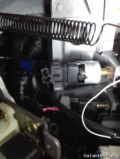

This is the only connection I could not find anything else to hook up too. It's near the clutch pedal switch and the connector that goes to the clutch pedal

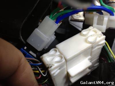

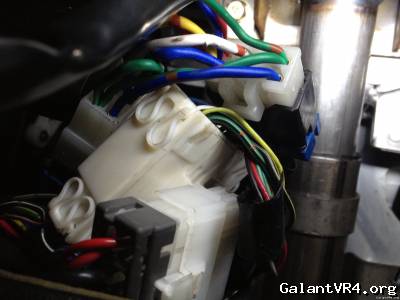

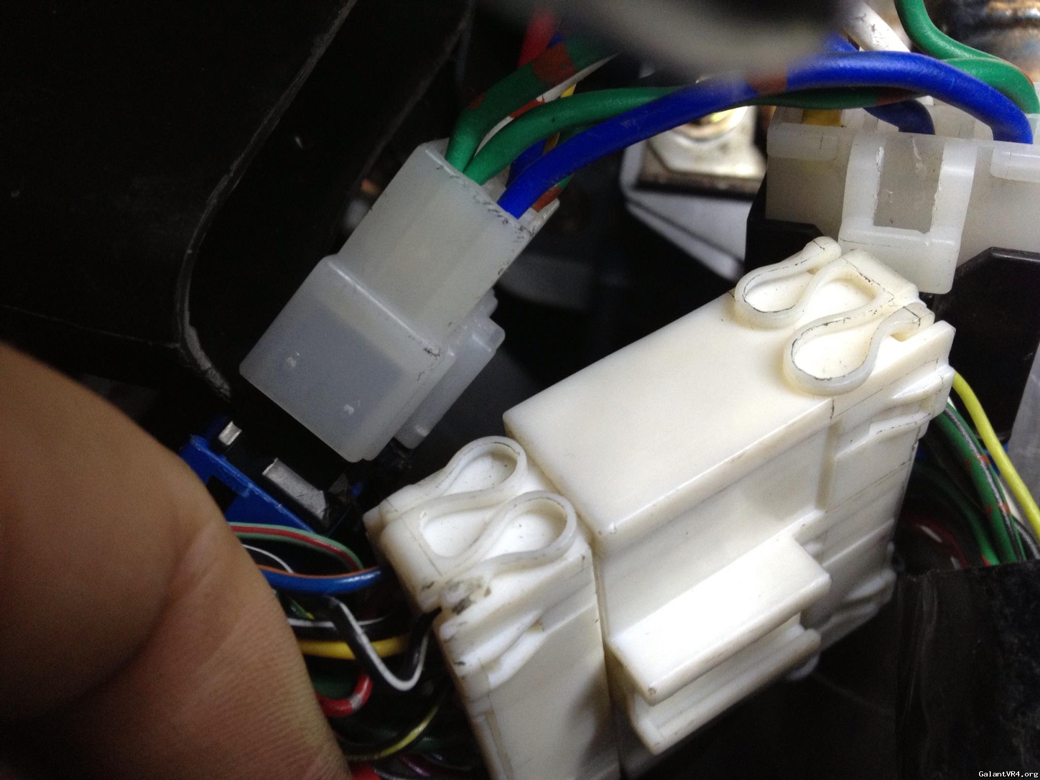

After hours and hours of diagnosing, thankfully, I found my issue and it was an easy fix. One of the wires coming from the back end of the wire harness that connects to the hazard/relay flasher box near the fusebox have been snipped and separated. It must have happened when I was pulling the pedal out and it caught it. Since its really not easily visible it took some time to track down the issue. I went through the wiring diagrams as well.
