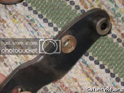

Rebuilt the entire clutch pedal assembly a few years ago but looks like that plastic bushing where the master cylinder clevis pin goes through ate it up already as I have some initial slop.
Anyone find a drop in bronze bearing for that slot? Or anything else that would work, even if its plastic I suppose because not like its hard to replace.

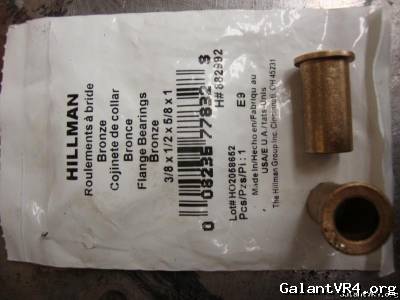

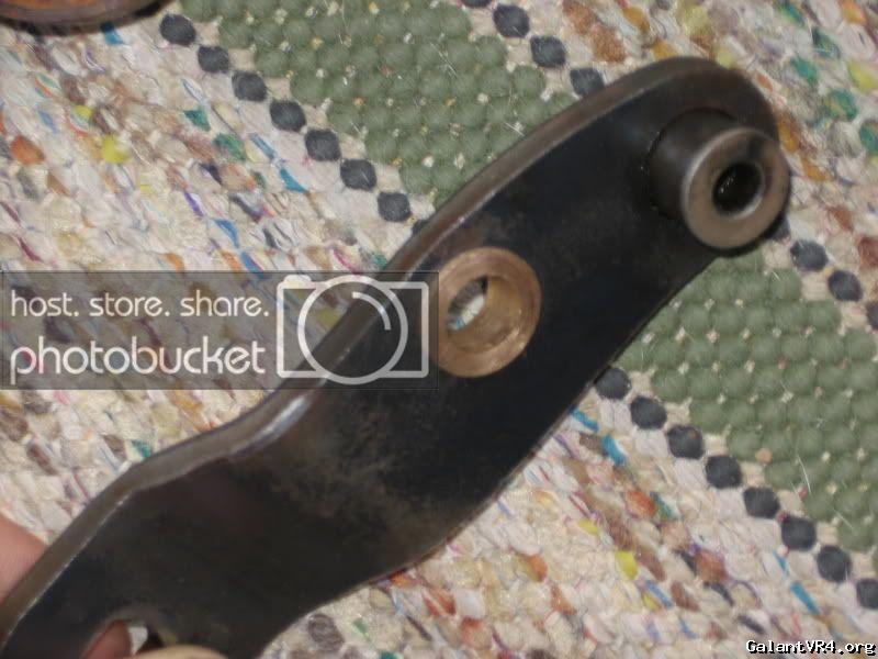

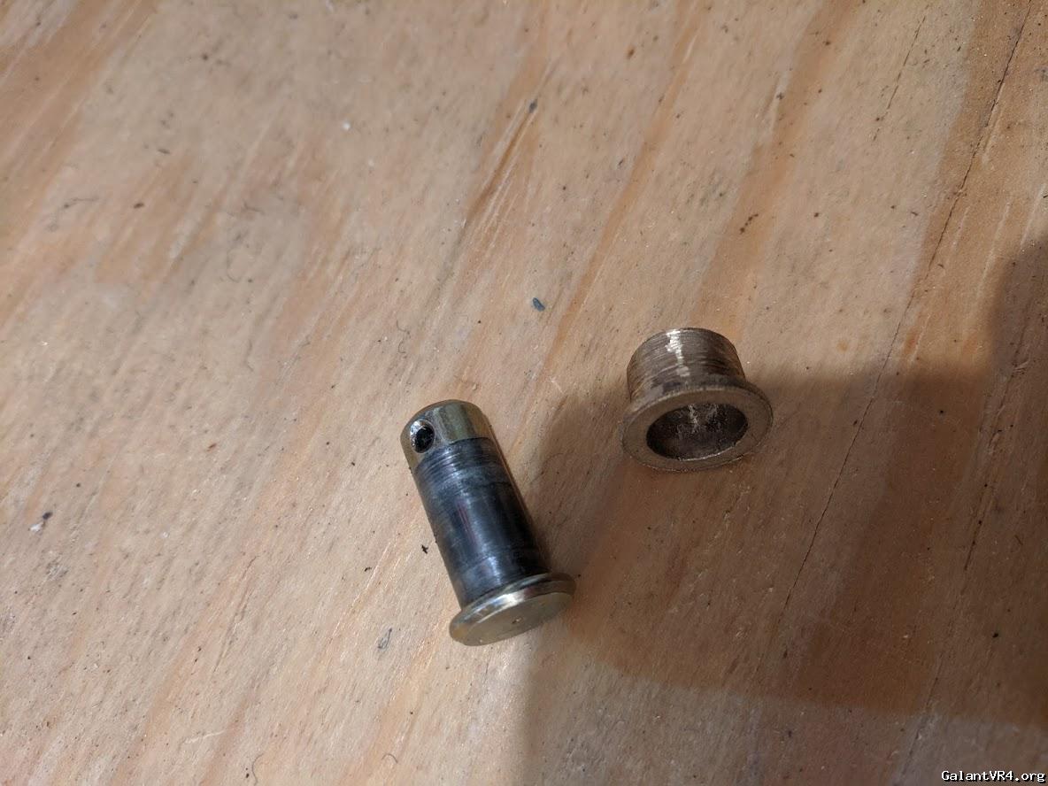

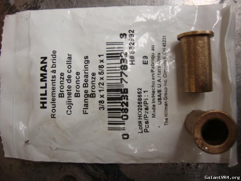

Nevermind, I went to Lowes and picked up a bronze bushing. Cut it in half, drilled out the center diameter a bit to fit the clevite pin, used the dremel to shave down the outside diamter enough to fit into the pedal lever. Greased, slipped in, and zero play now. GG.
