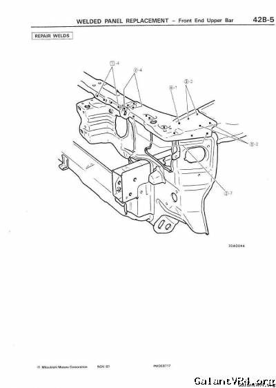

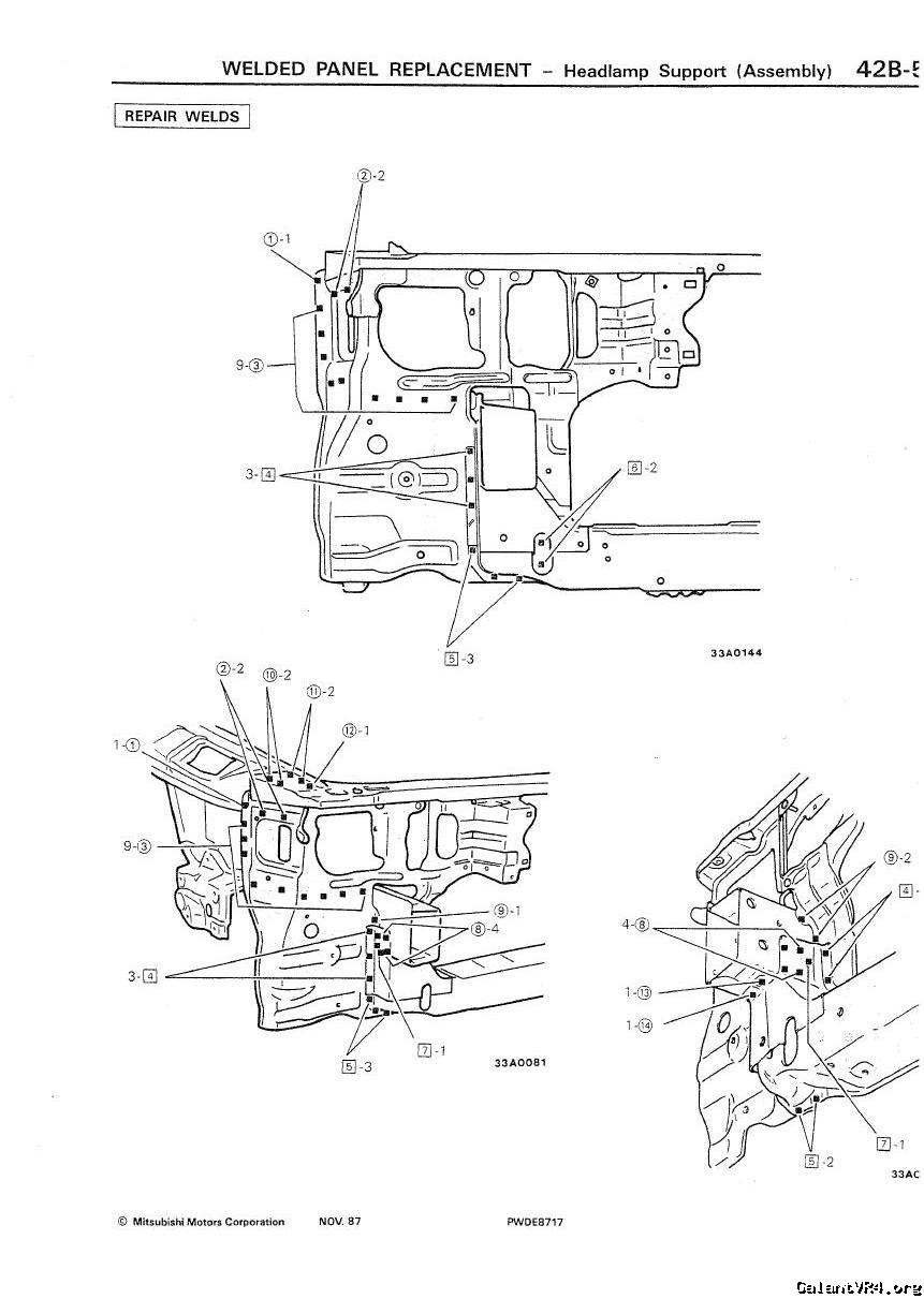

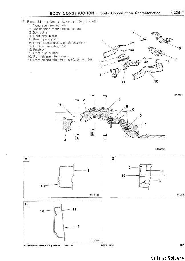

Finally getting around to drilling out the spot welds. I haven't seen any write ups anywhere. Anybody got any links or frustrations of your own, please feel free to share. I am also sawing the frame rails off as mine are bent. I will post the pics I can. I just wish I could fabricate a front end /ubbthreads/images/graemlins/frown.gif((

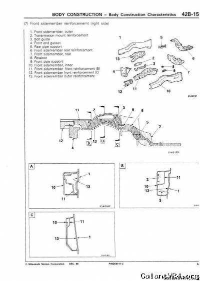

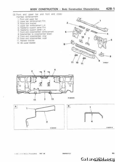

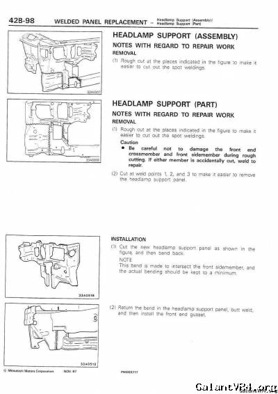

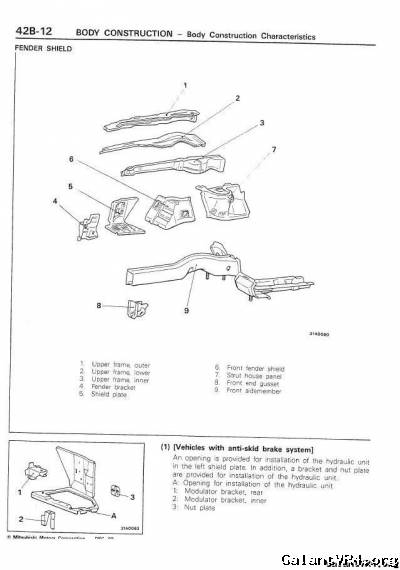

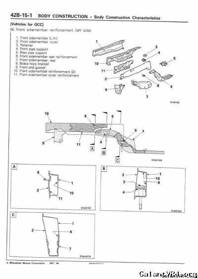

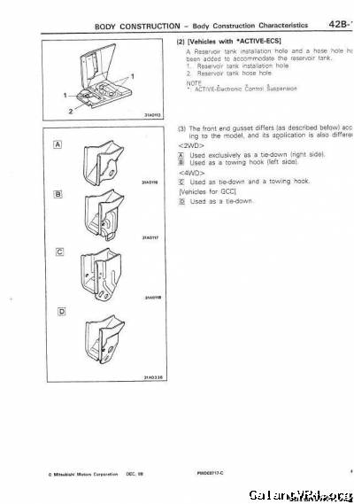

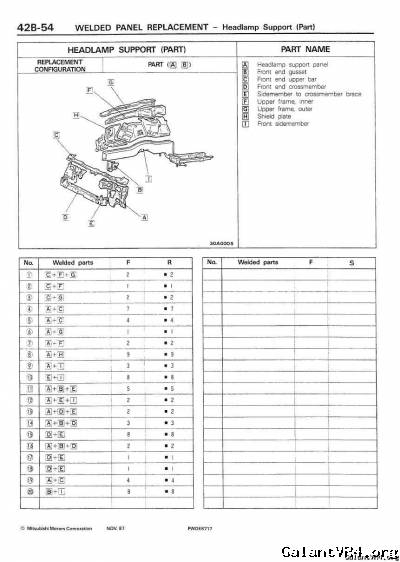

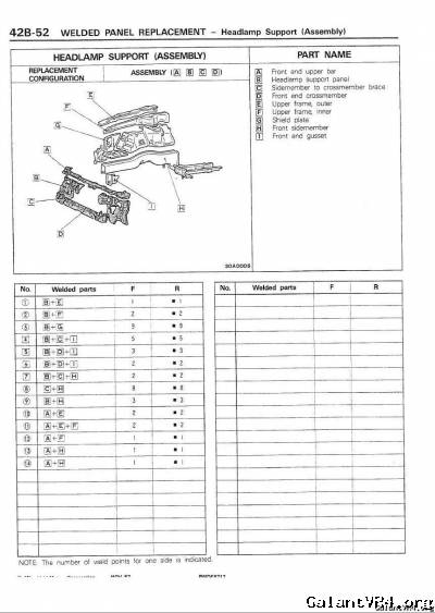

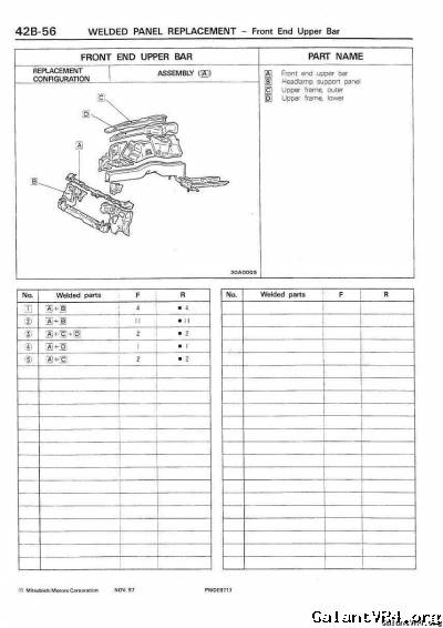

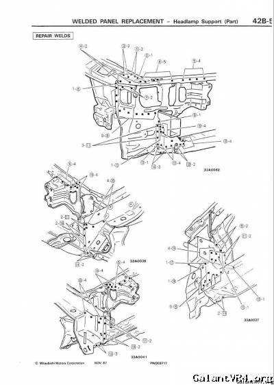

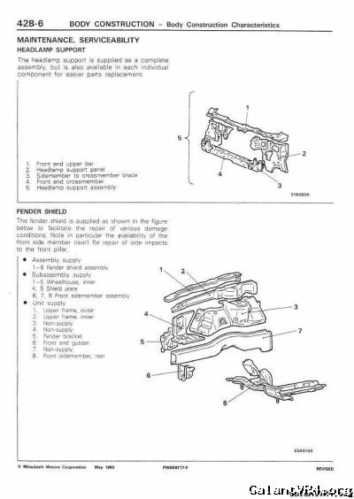

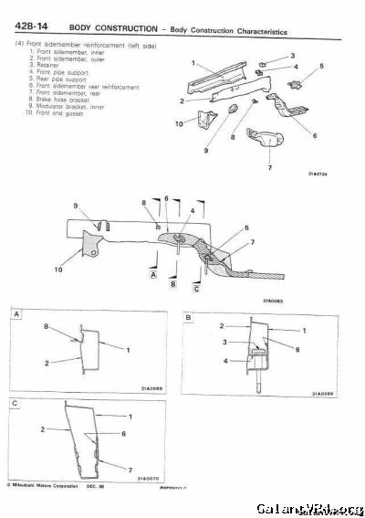

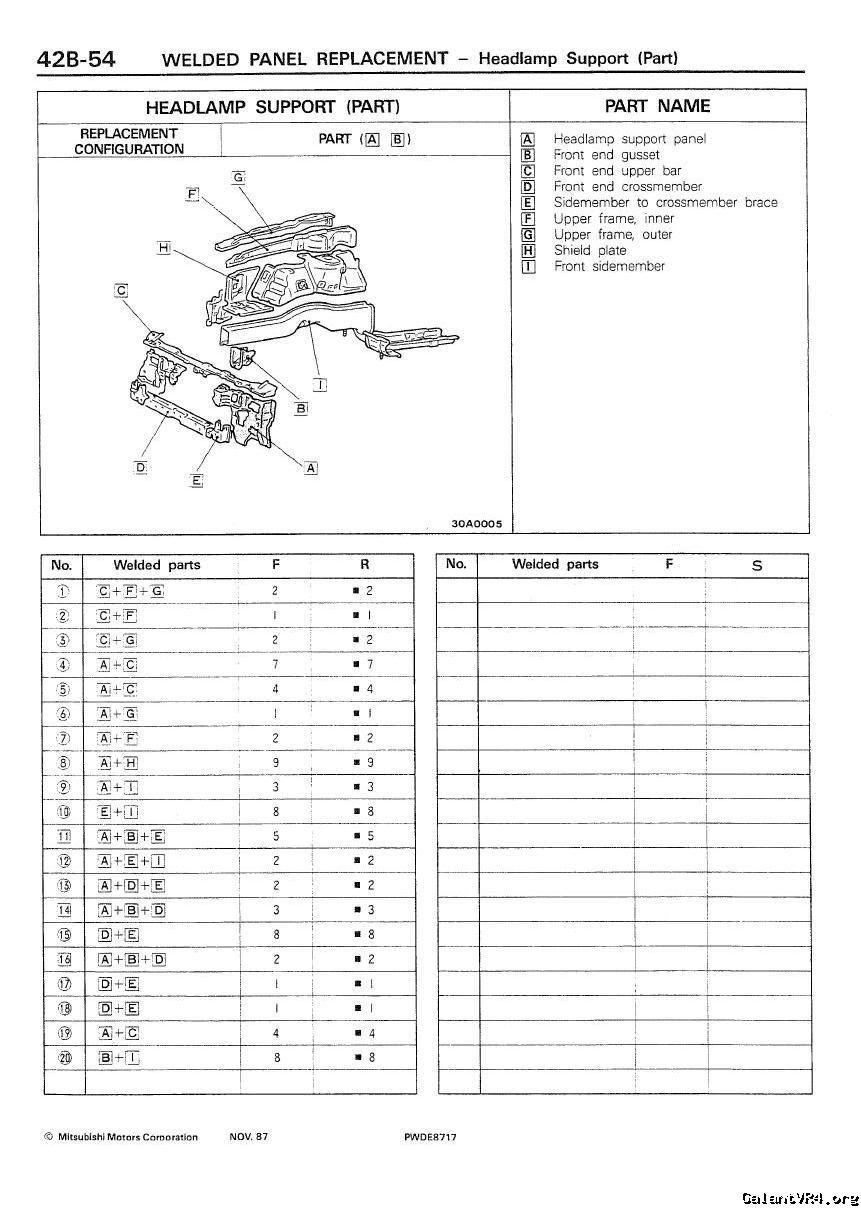

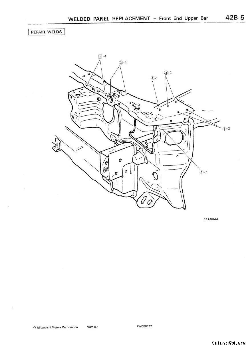

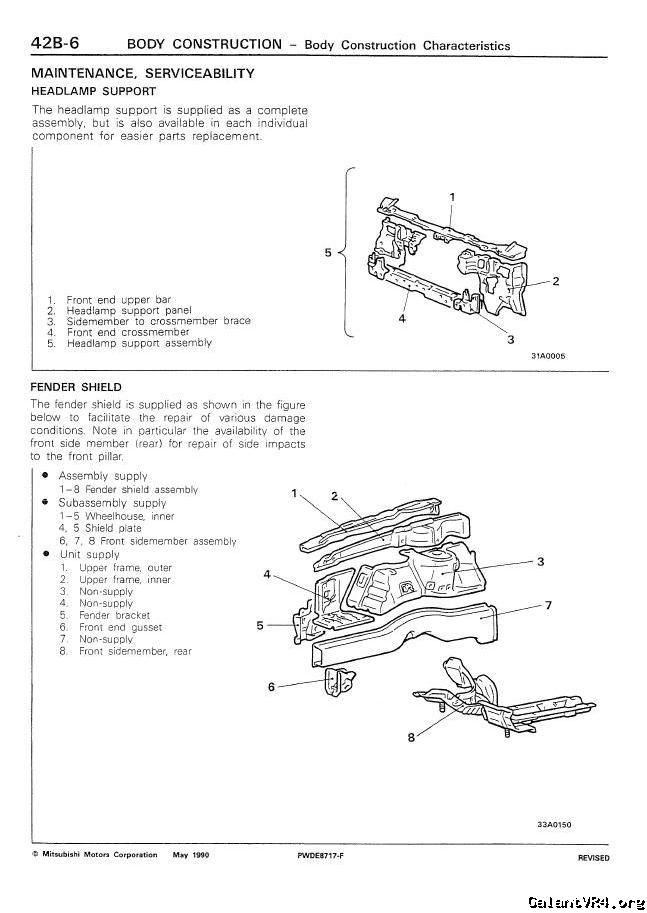

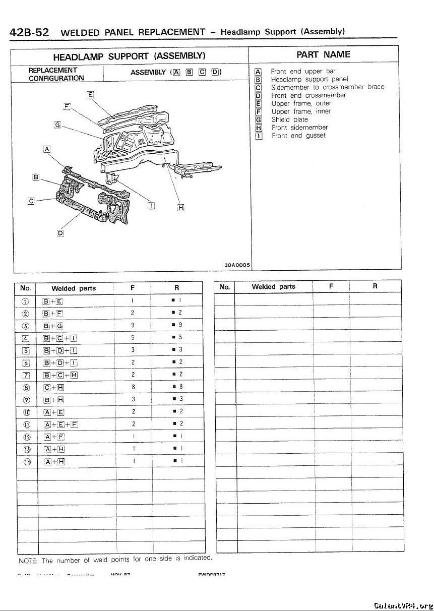

Haha, sitting in an airport at the mo. I've got the weld diagrams to hand as soon as arrive somewhere that isn't here.
I've posted quite a few, i can't remember ifvthe front ones are up though. Have search in the how to section, I've put an index post in there for all the diagrams
Hope this helps,
Rich

Here is the post Rich is talking about.
misterfixit
Aug 4, 2004
1,580
Midlands, UK

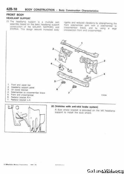

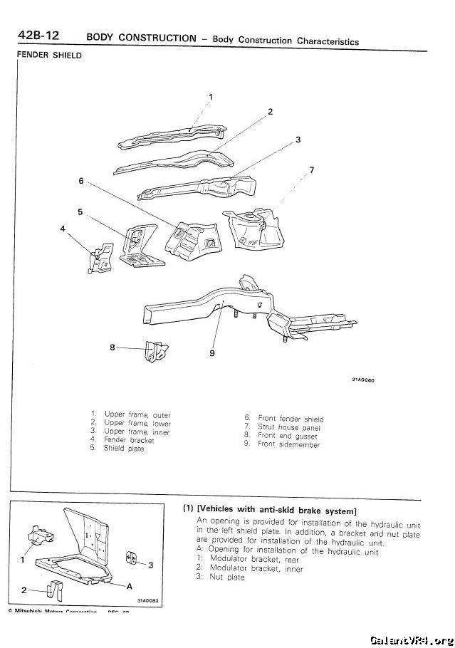

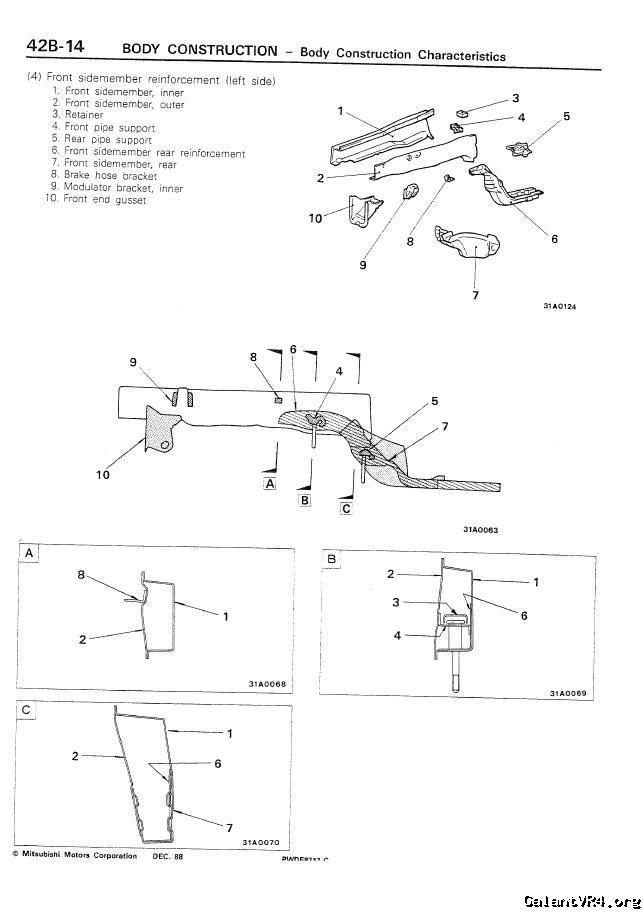

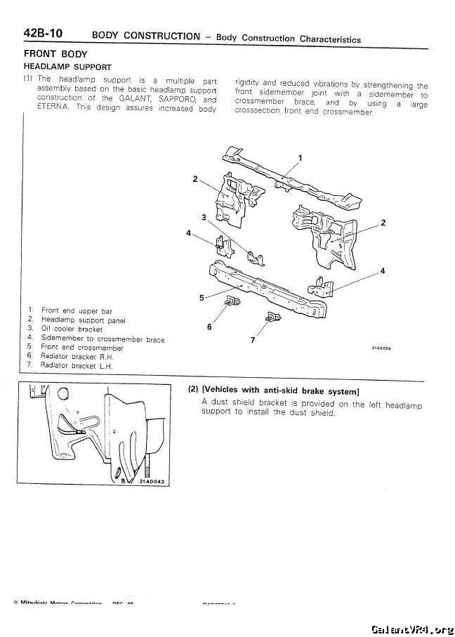

You will need to refer to the side and rear body manual section I also posted. Link is in the above post.

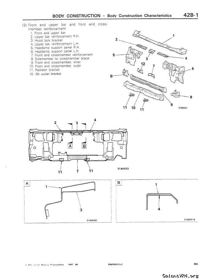

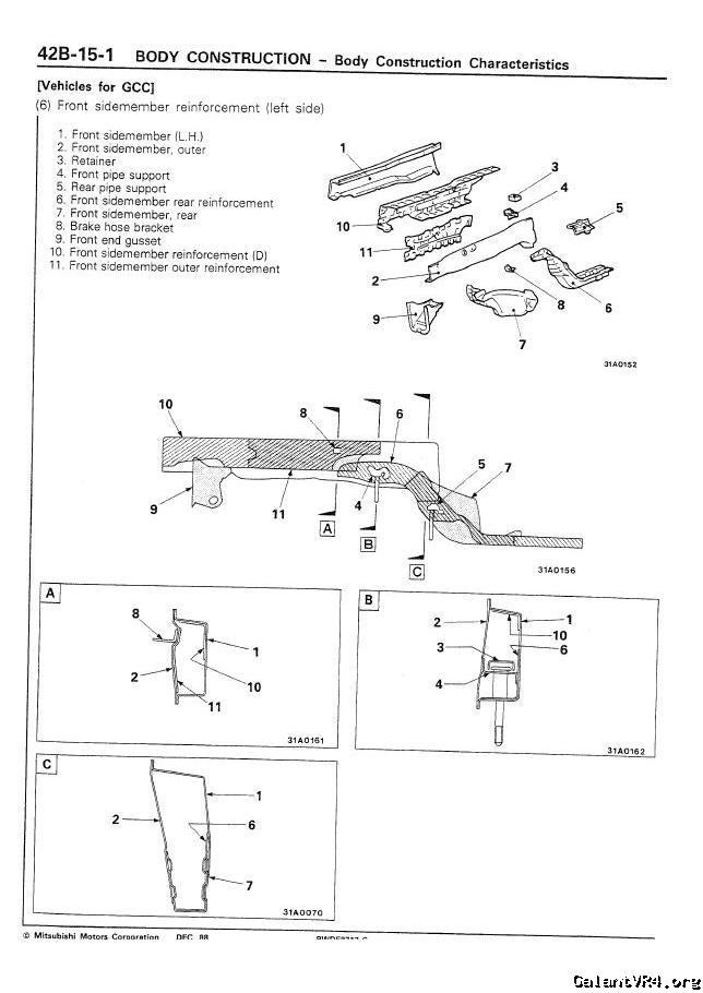

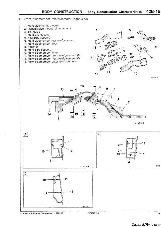

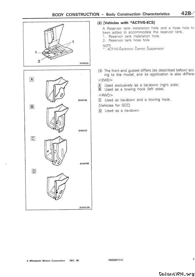

Construction diags first:

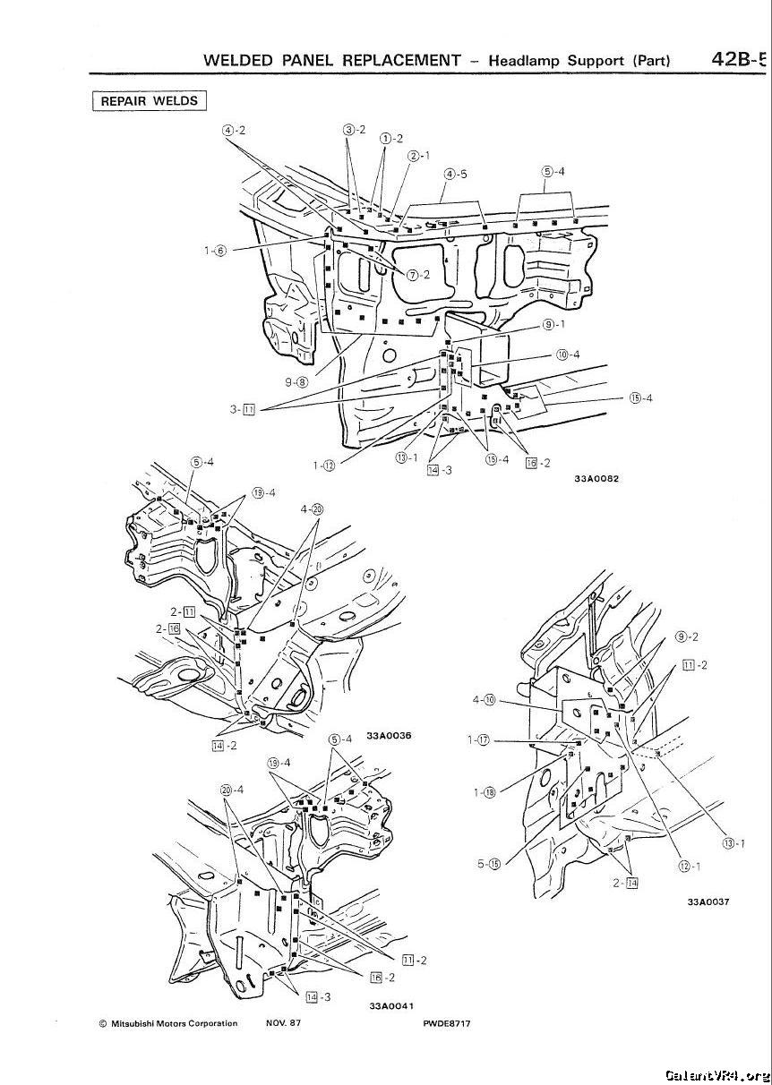

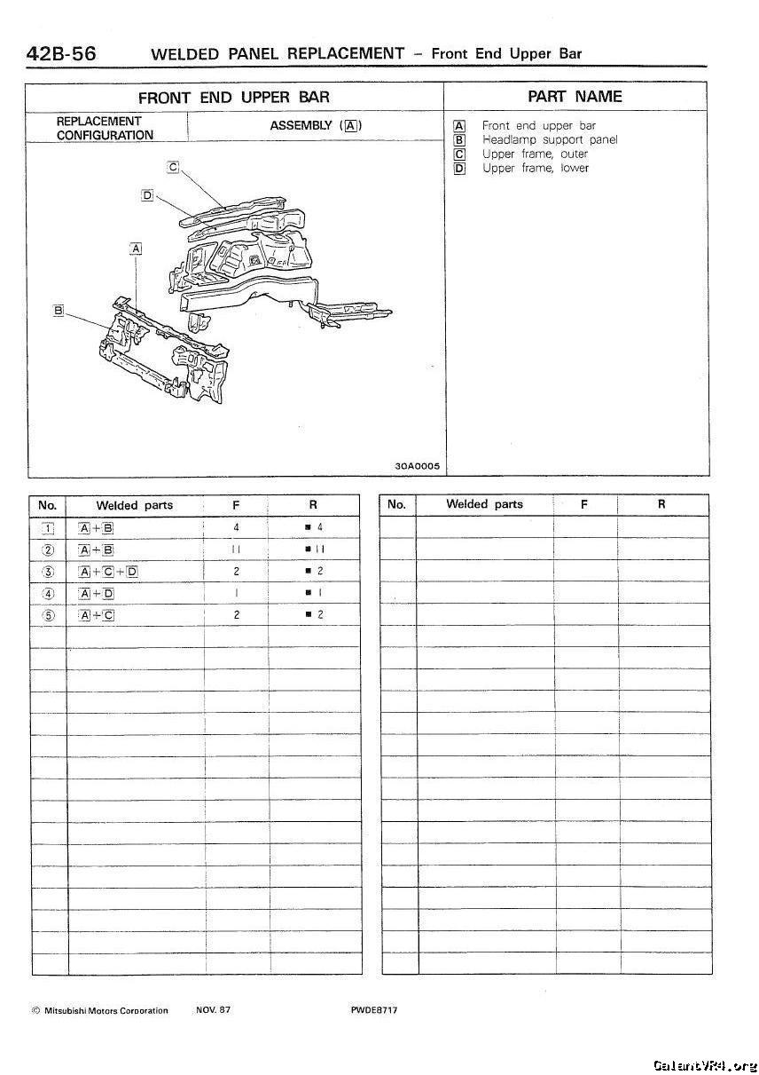

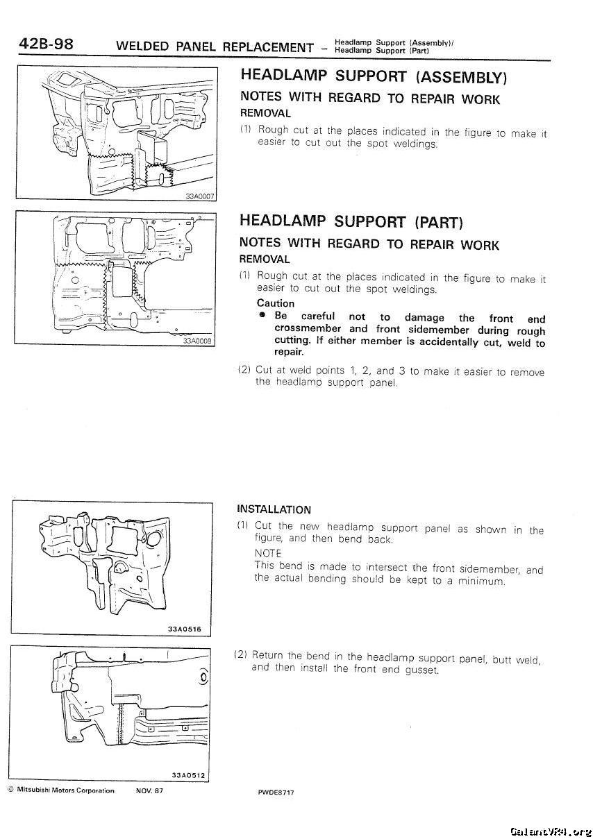

Weld Diags next, Again as before the code symbols will be explained in the other thread (p48 etc iirc)
Notes:
Hope this helps!
Rich
