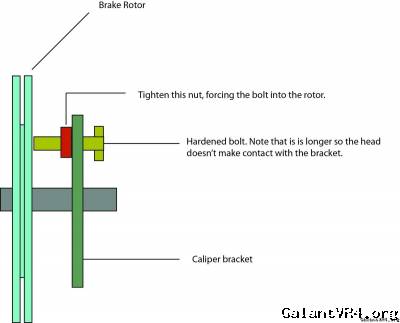

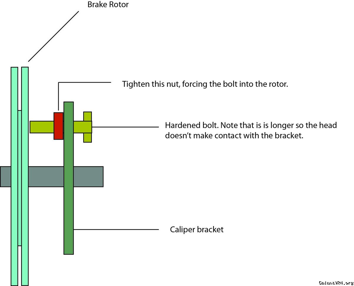

I had the same issue. Called Terry and he had an awesome idea that doesn't involve beating the ever loving crap out of it. You don't want to do that as you can seriously mess up the bearings as afore mentioned.
Get some hardened bolts that will fit through the brake caliper mounting bracket. Make sure it is long enough to go past where the rotor is. Use the bolt and nut in such a way that when you tighten the nut, it will exert force on the rotor. Loosen the bolt, spin the rotor a little and repeat. Do this until the rotor pops off.
I did the same thing and it worked like a dream.

I remember seeing that technique somewhere on these forums before. I even used it to pull the wheel bearings and hub out of a Murano with the castle nut removed but rotor still attached without having to use a puller.
