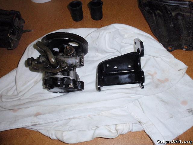

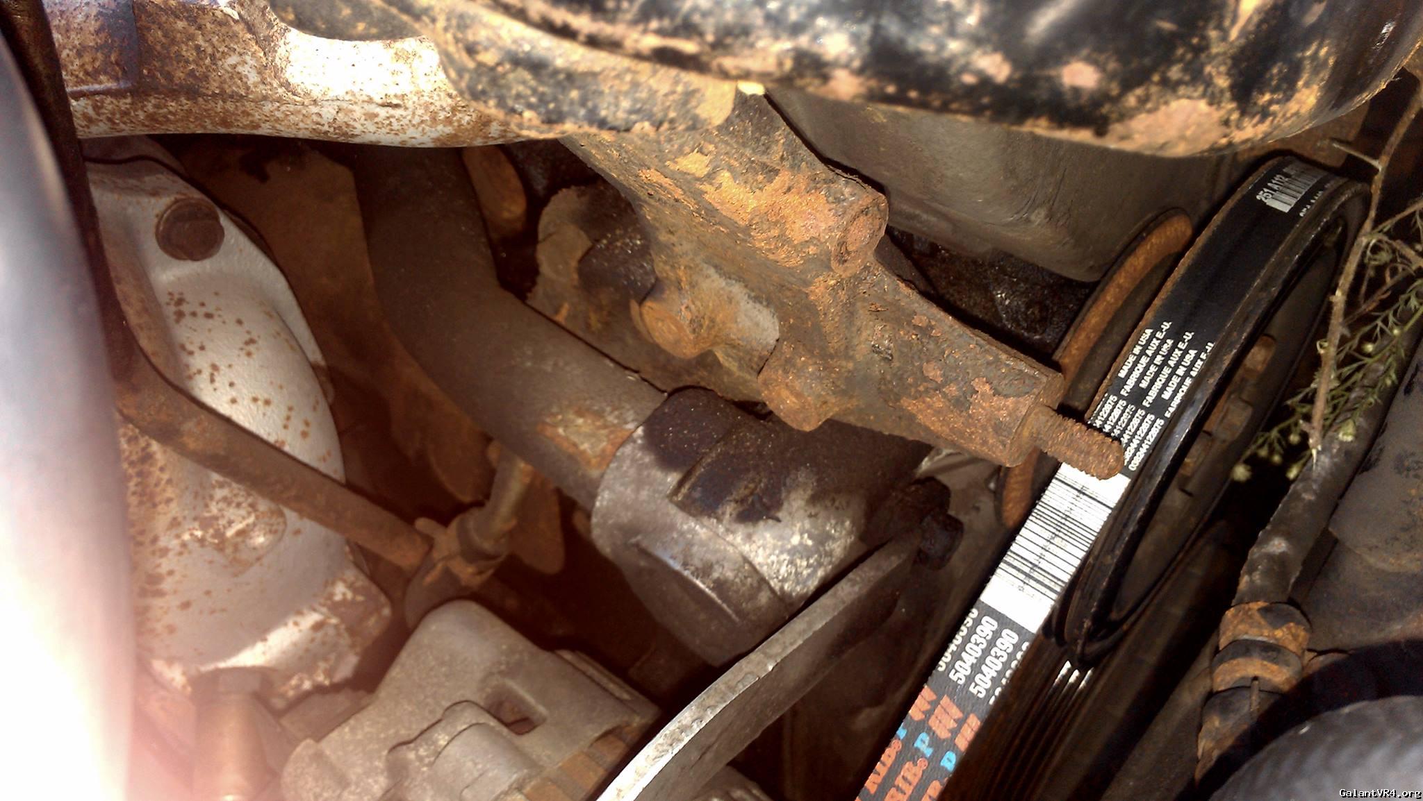

So I got my hands on a power steering pump recently, and want to get p/s back in my car as it came without the pump. I believe all the lines are still in tact on the car. Wondering what I need to reinstall this pump other than belt and fluids...or any other steps i have to do.

You will need one additional bracket. You have the one to the block, but there is a U-shaped steel bracket that goes around the pump. Aside from lines and a reservoir, you should be good.

does that u-shaped bracket hold the pump to the motor? been trying to find an exploded diagram on how the pump bolts up.

^appreciate the offers, but i already sourced a bracket to order from someone on the org. just ordered a gates belt off rockauto for $2 on closeout sale...gotta love those.
