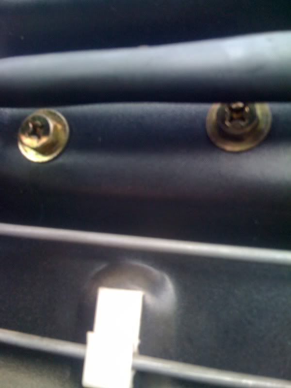

This is the first screw I put in. After working the regulator back in I loosely put this in so that the regulator could flex and move around. I moved the regulator towards the front of the door and than lifted the window. Now I had to apply power and move the window up and down to situate everything.

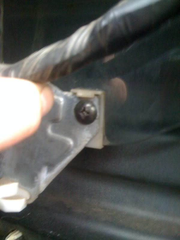

This is the second screw. This one is the most difficult to work with as you have to have the regulator in a certain place to tighten it up. After getting the motor secured and the regulator secured I moved the window down and tightened it up.

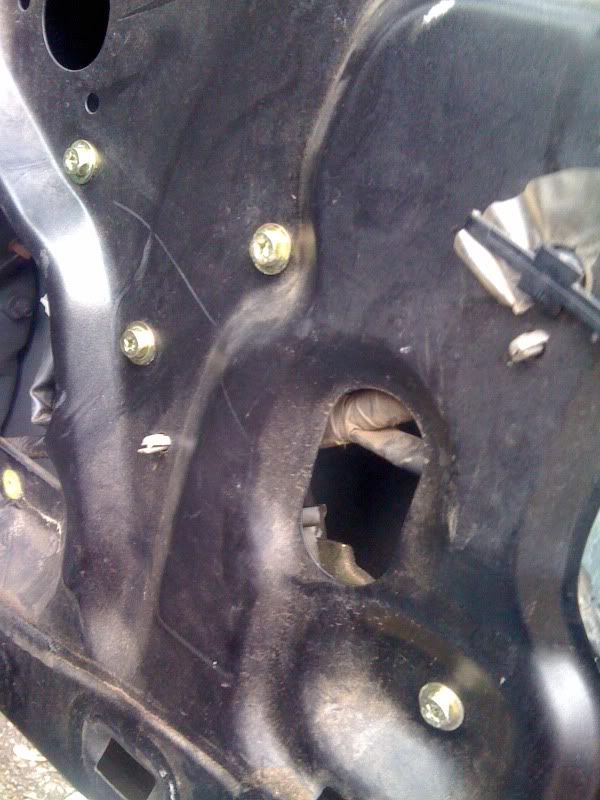

Here are the six bolts you re-secure the regulator with. Keep a check on your cables as the can get binded easily and cause your window to not work. I made sure everything was lined up and working correctly before installing the door cover.
Patience is going to be key with this. If you get frustrated you will get stuck or do something stupid. I hope this helps guys.
