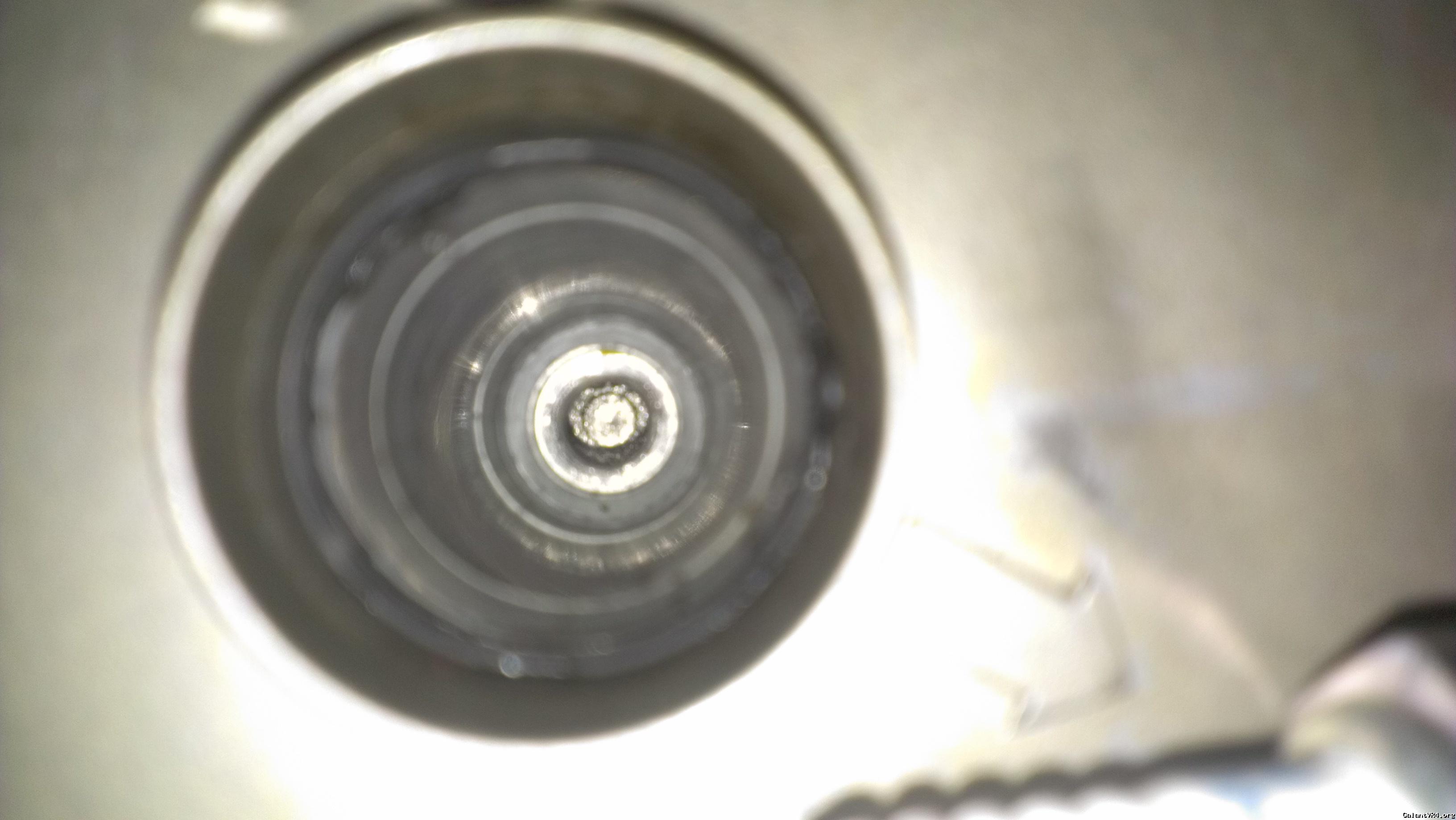

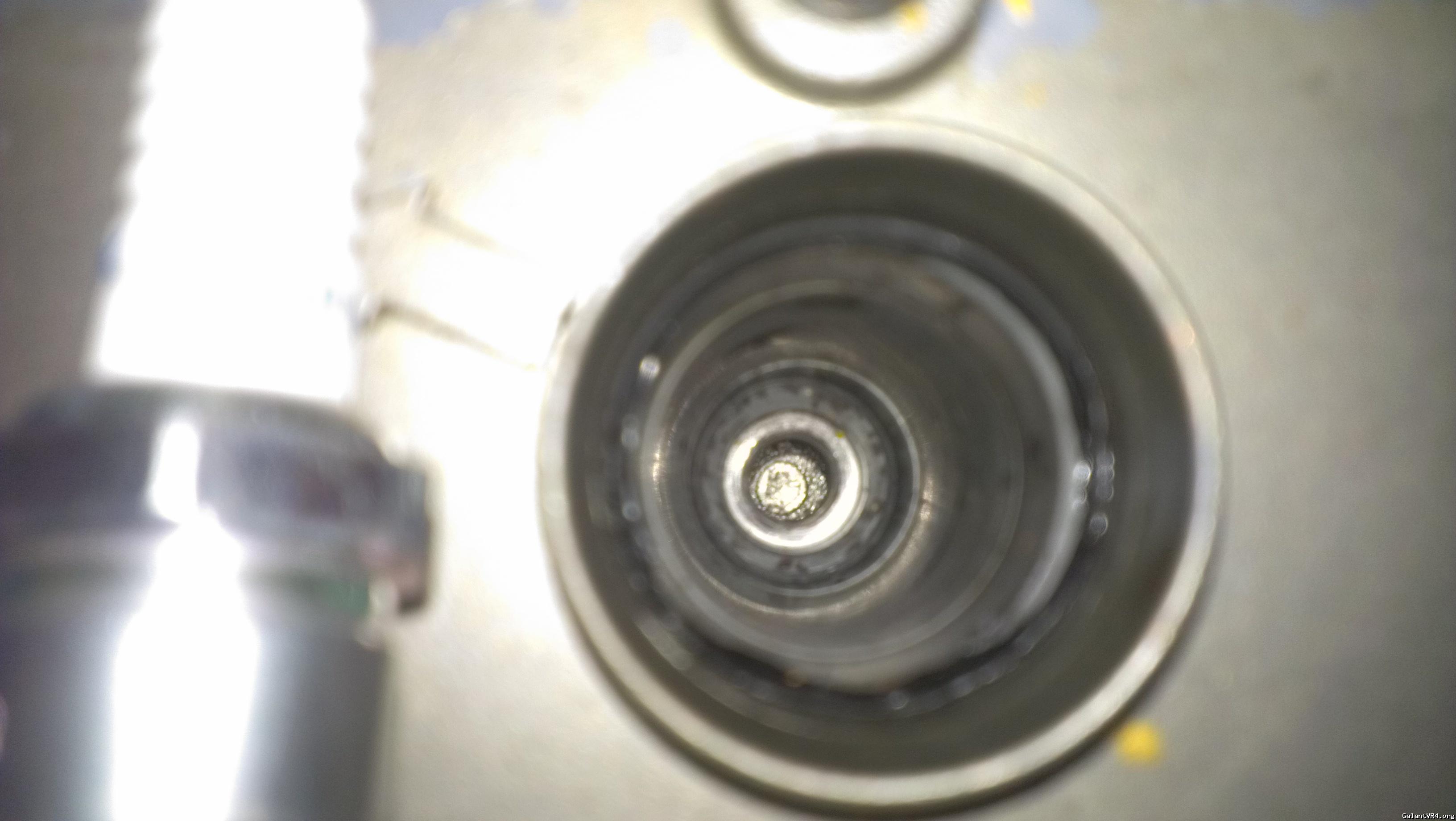

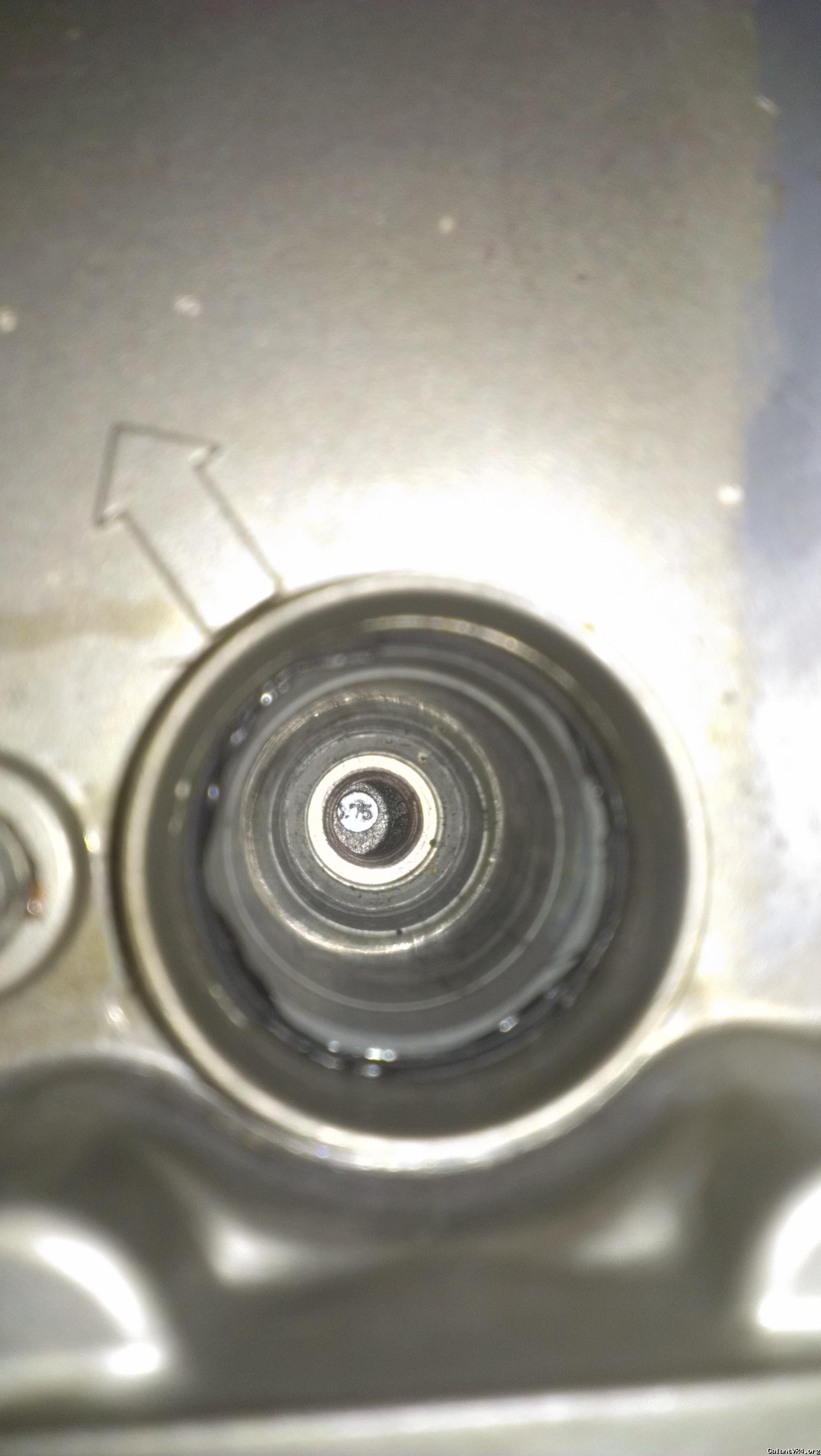

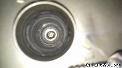

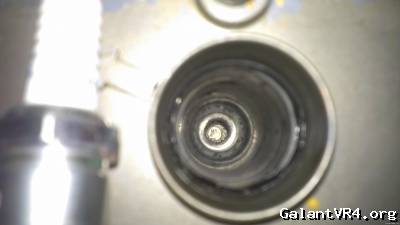

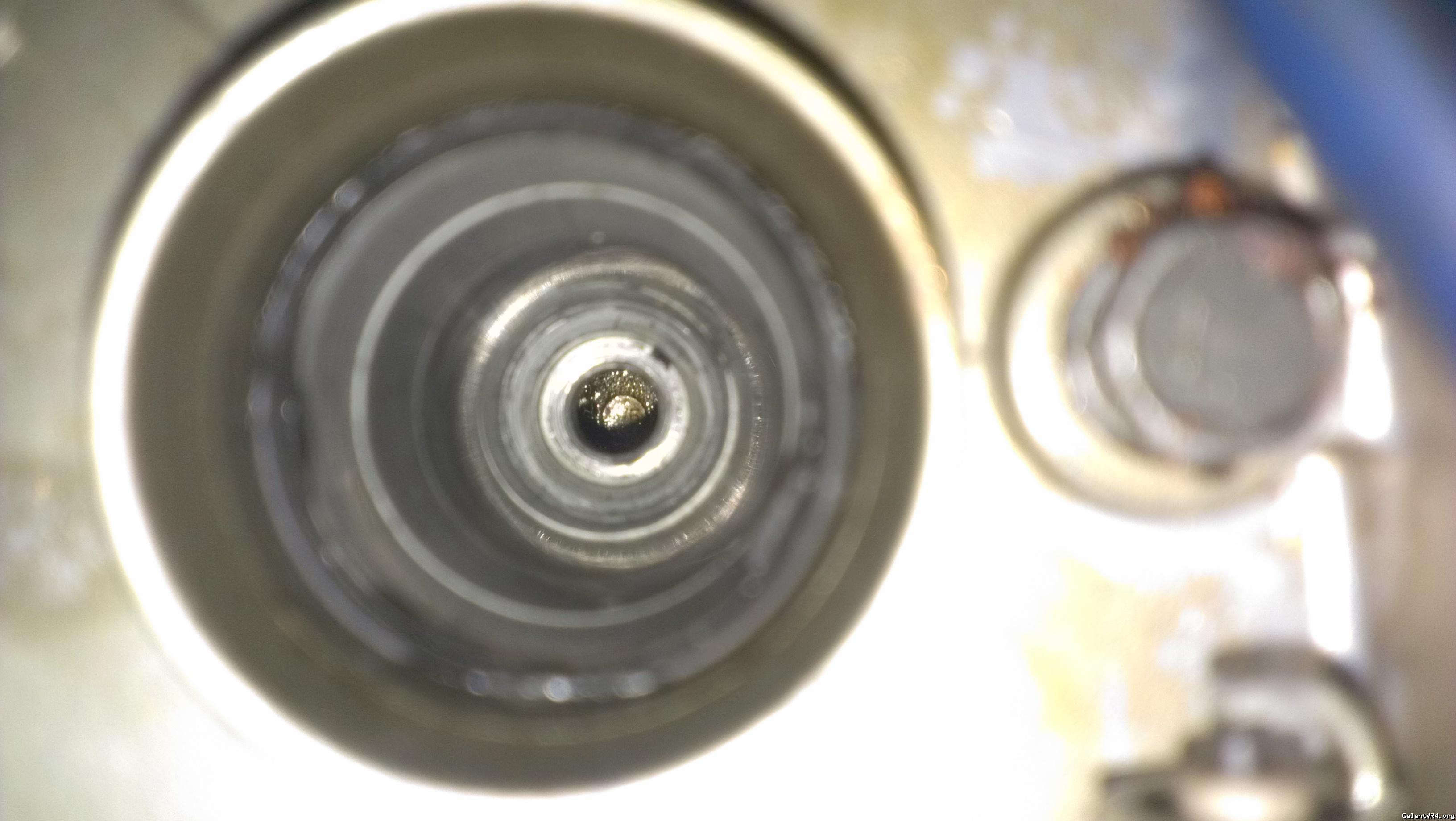

I pulled the EGT probe from cylinder one in the manifold and it had oil on it. I checked in the cylinders and piston 1 looks like it has some oil sitting on top of it in comparison to the rest of them. I don't know if a little bit of oil like that is normal until the rings set or not, as this is my first rebuilt engine.
Cylinder 4
Cylinder 3
Cylinder 2
Cylinder 1
Do you still think I should fill it back up with oil, start it up and check for something spraying oil?

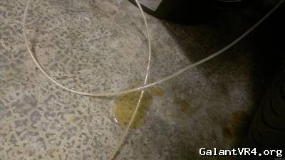

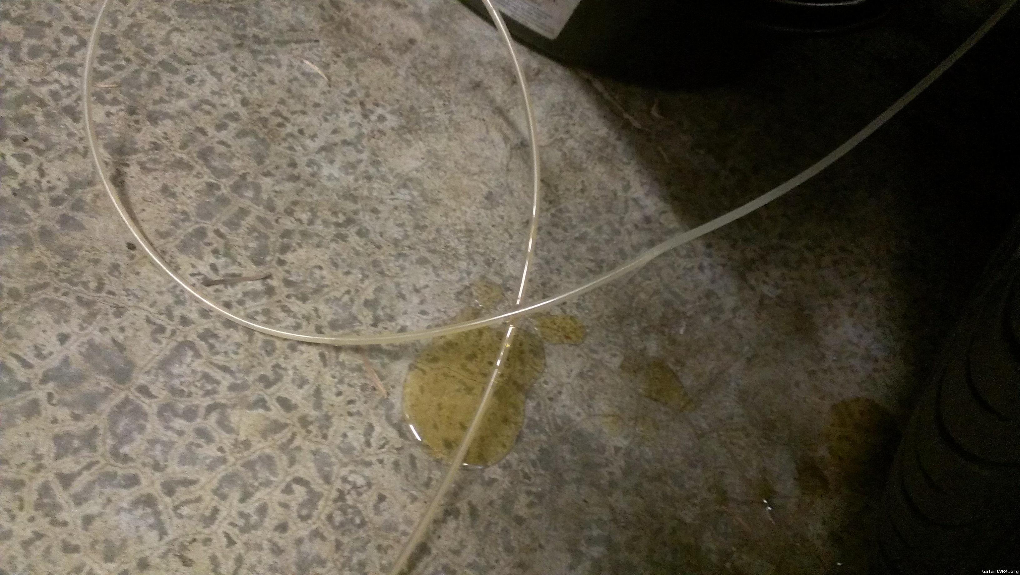

You were dead on sir. I cleaned everything up and pulled my oil pressure gauge out from the engine bay onto the floor and started it up. There was the most glorious oil leak I have ever seen lol. Thank you for your help.

Replace that nylon line for their copper (better) or a braided -3 or -4 hose (best). Or even better, run an electronic gauge.
