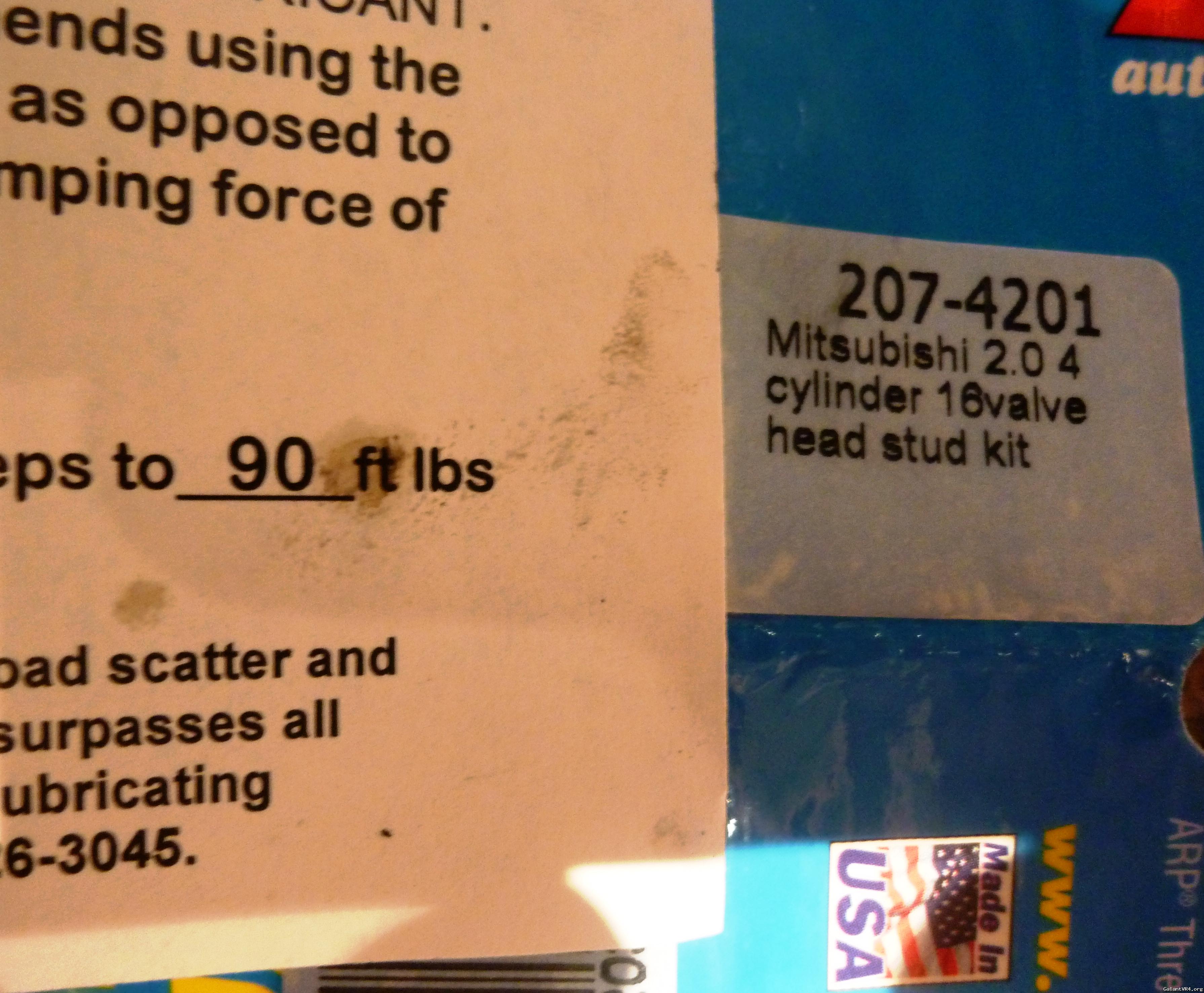

Not to split hairs, but this is what came with the ARP head studs I installed yesterday:
That's with their supplied fastener assembly lube.

Another document I found...
Are they standard ARP head stud bolts?
How do they feel when torquing them up to 90 ft lbs?
I'm just curious because the L19's felt springy at about 110ft lbs.
ARP seem to give loose figures when quoting torque specs though.
GVR-4
Apr 22, 2002
2,610
Asheville, NC USA
Standard as far as I can tell. They didn't feel springy to me.
Maybe the 207-4201 that I have are not torque to yield, and the others are? /ubbthreads/images/graemlins/dunno.gif
