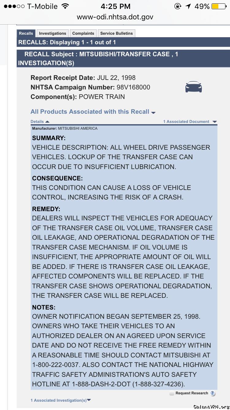

There is a recall on all the early transfer cases. You can call the dealership and ask them to run the vin number.

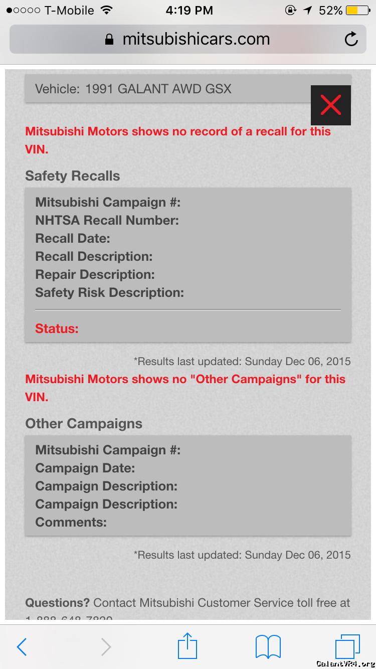

Alright so I called Mitsubishi, and they say the recall was done by one of the owners in 1999. So I guess I have to try to figure it out.

A buddy of mine that used to work for Chrysler told me that this was a lifetime warranty since it was a recall for safety. He got me a few brand new transfer cases over the years for my talon and awd summit wagon.
10,992
That does not technically apply if it is has been performed already. Mitsubishi has pretty consistently refused to do it again if it has been done once.

Mitsubishi refused to do mine when I bought my old Talon circa 2003 since the VIN did not pull up a Mitsubishi. Cocksuckers. /ubbthreads/images/graemlins/mad.gif I went to the Jeep/Eagle dealership and they got it done for me. I took mine in before any failure tho. I hated my local Mitsu dealership. Stan for sure.

Yes they told me it wouldn't be covered since it was already done and not considered a safety hazard anymore. And both of my wheels locked up entering a highway, good thing it happened there and not when I was going 70mph. I guess I have to try and find a transfer case. Been googling but haven't found anything solid. Thanks everyone by the way for the help
