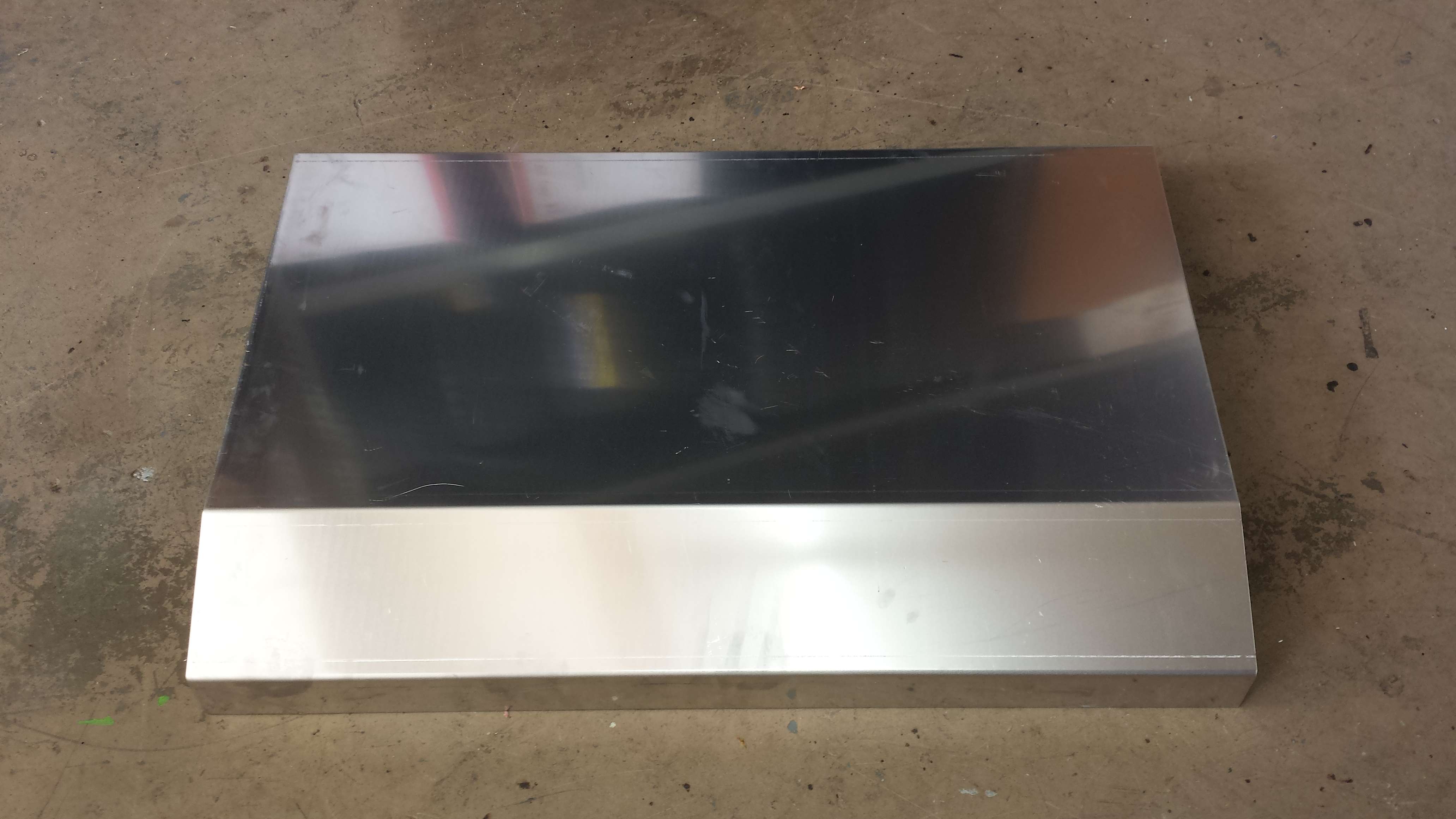

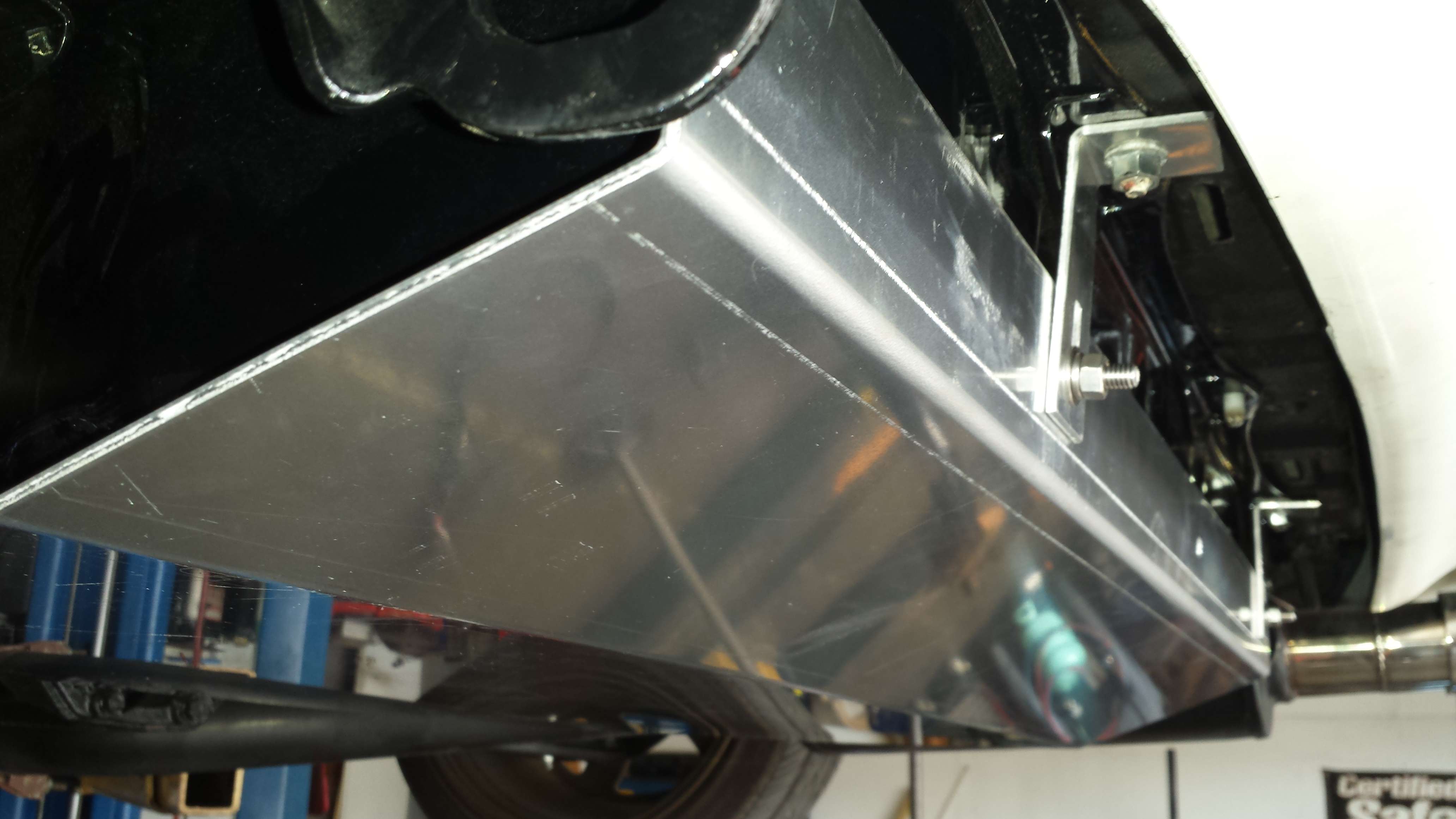

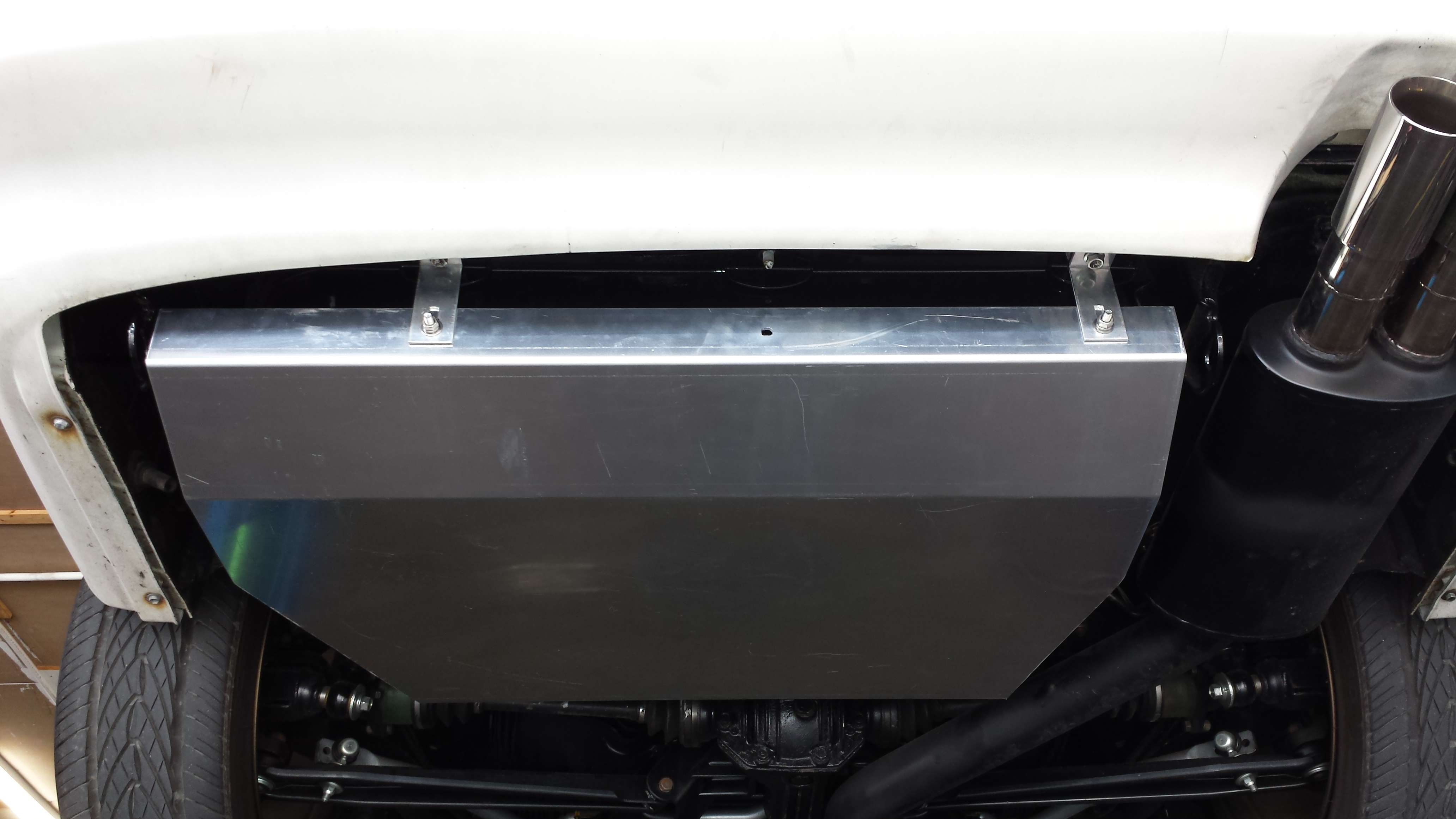

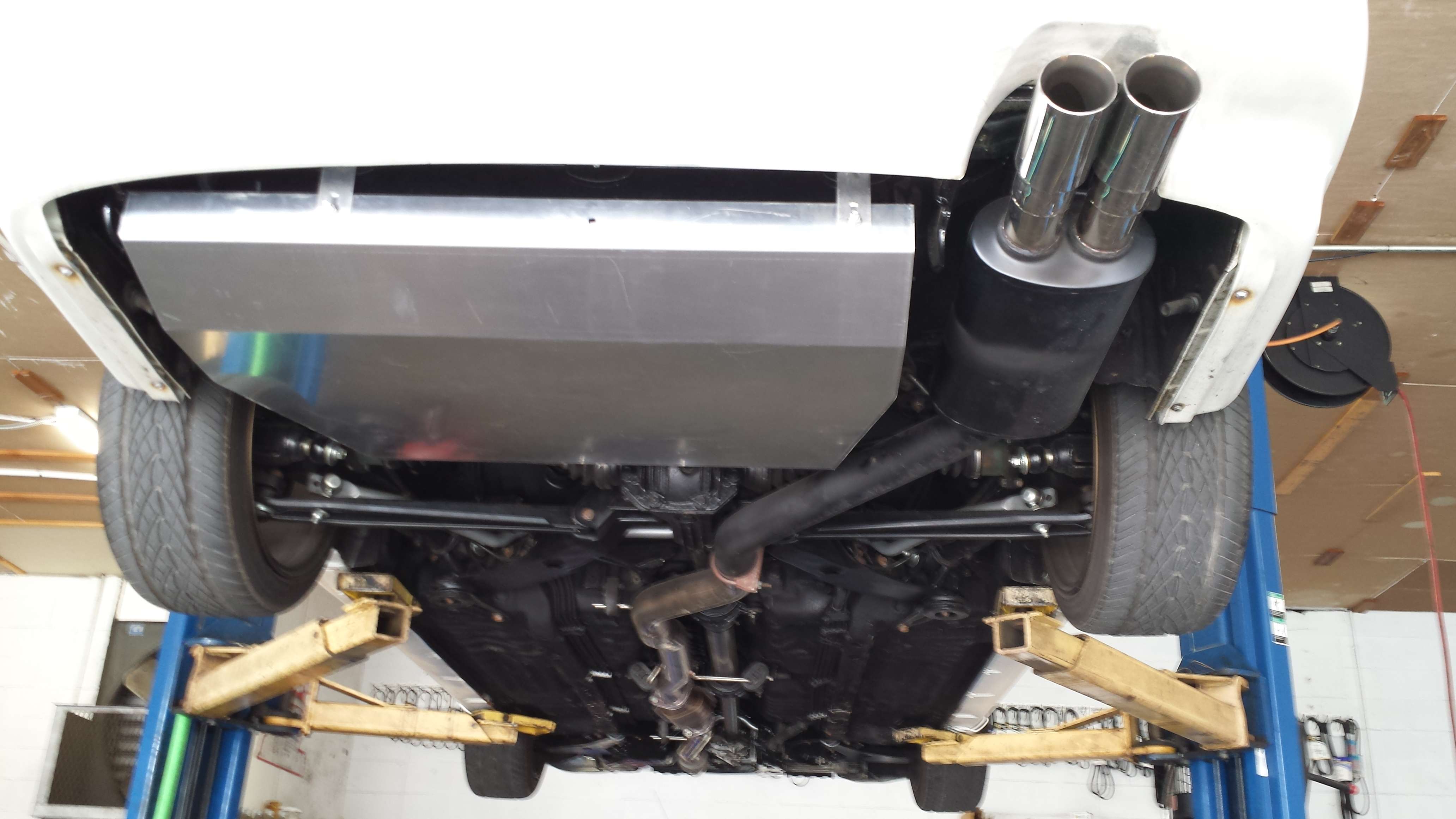

After seeing some pictures of a rear under guard. I decided to fab one up. Since my gas tank had some dents in it, before I restored it. Also since they are no longer available. So here are the pictures. It will be getting powder coated black. Just mounted to test fit. Uses 5 brackets to mount.
Made out of 1/8 aluminium and weight is 10lbs. Used stainless hardware. I will post pictures when finished.

The whole point was to protect the gas tank. Like I said my tank had damage to it when I bought the car. So I wanted to protect it from any other damage. I really like it. I do have some extra metal left over and might make a couple others. So if anyone is interested let me know.

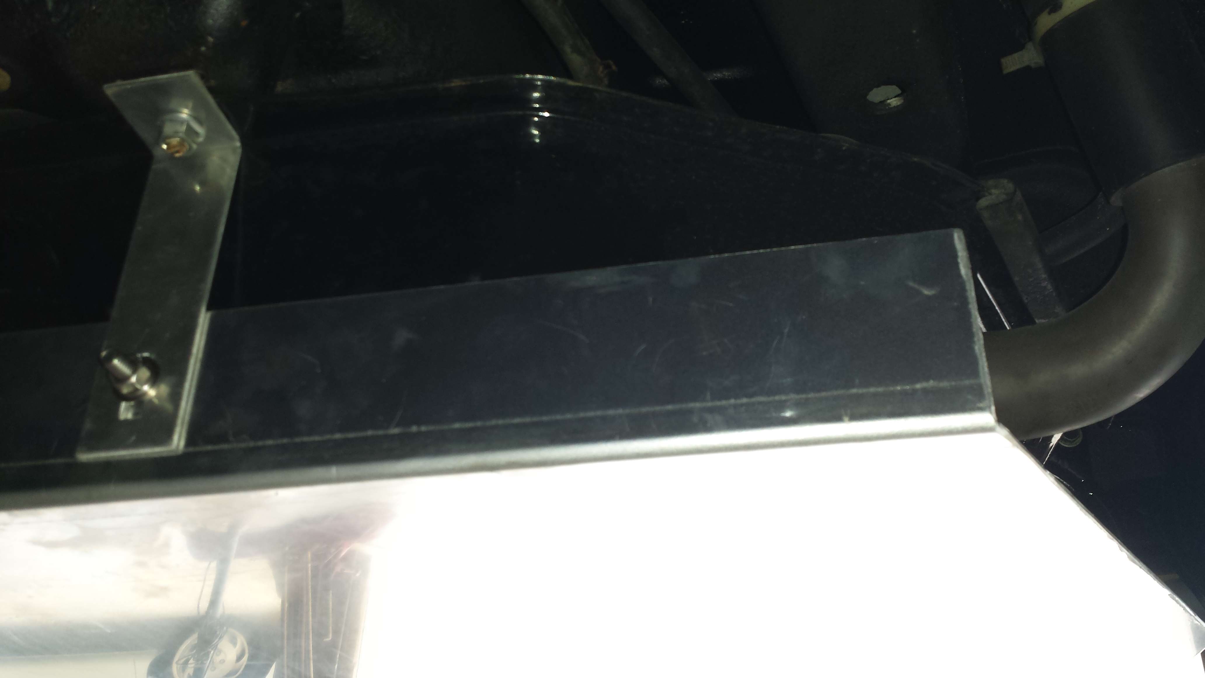

3,473
I think the finish looks great! Did you consider welding the brackets to the guard itself, instead of bolting them? Just wondering if the plate will shift at all if it takes an decent impact, or if it's pretty sturdy bolted to the brackets. I think you did an awesome job though, and I'm looking forward to seeing the finished powder coated product.

Quoting GSTwithPSI:
Thank you. I did use a special bolt that is locked into the guard. So it is very sturdy. 5 brackets hold in place.
