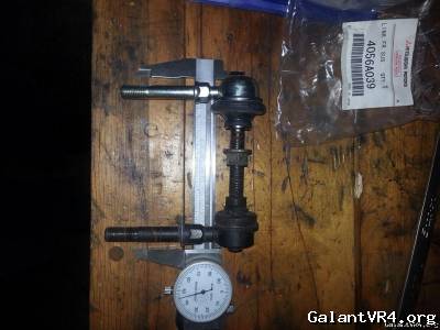

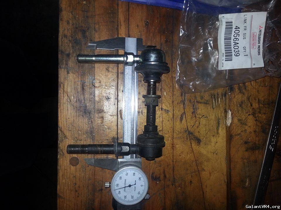

Here's a photo of the difference between "Moog 1g DSM links" and "OEM Galant VR4 links".
Who else has been nailed with this pain in the ass issue? I tried to install the Moog links, and the swaybar was hitting the trailing arm. They simply do not fit. Maybe because the car is lowered? I don't know. I just know that the parts are quite obviously not the same.

Maybe i was somehow unclear.
The lower item is Moog. It's too tall. I bought the pair for like $30, initially. They didn't fit.
The upper one is OEM, which i had to purchase for like $40 each. They fit and function fine and properly.
Aftermarket rear links are a gamble (at best, if ANY are even the right dimensions) and not worth the headache.

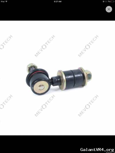

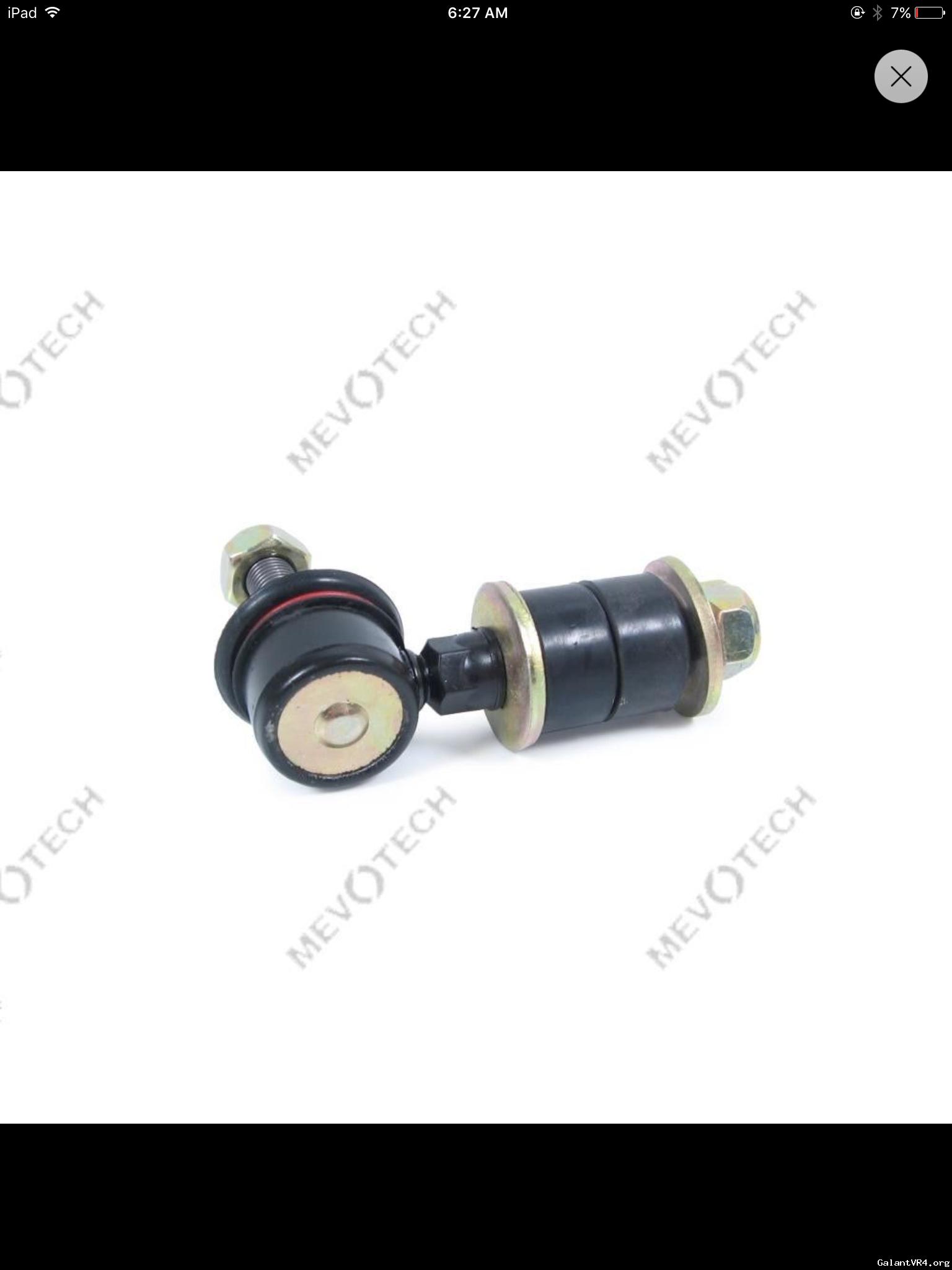

The Mevotech MS80812 looks like it has a shorter stop nut mounted closer to the pillow ball housing, perhaps this will fit better?
Nebraska
Apr 9, 2015
140
Lincoln, NE
^^^^^^installing those this weekend. Just so happens I'm putting my subframe back together, they sized up exactly to OEM besides the old rubber bushings.

Very good to know! Thanks for contributing! Now others will know what to look for that actually fits. /ubbthreads/images/graemlins/worthy.gif
What did the pair of those cost? I'm guessing about $25 for the pair which is far better than $80+ for OEM.
Quoting Gtpdz:
