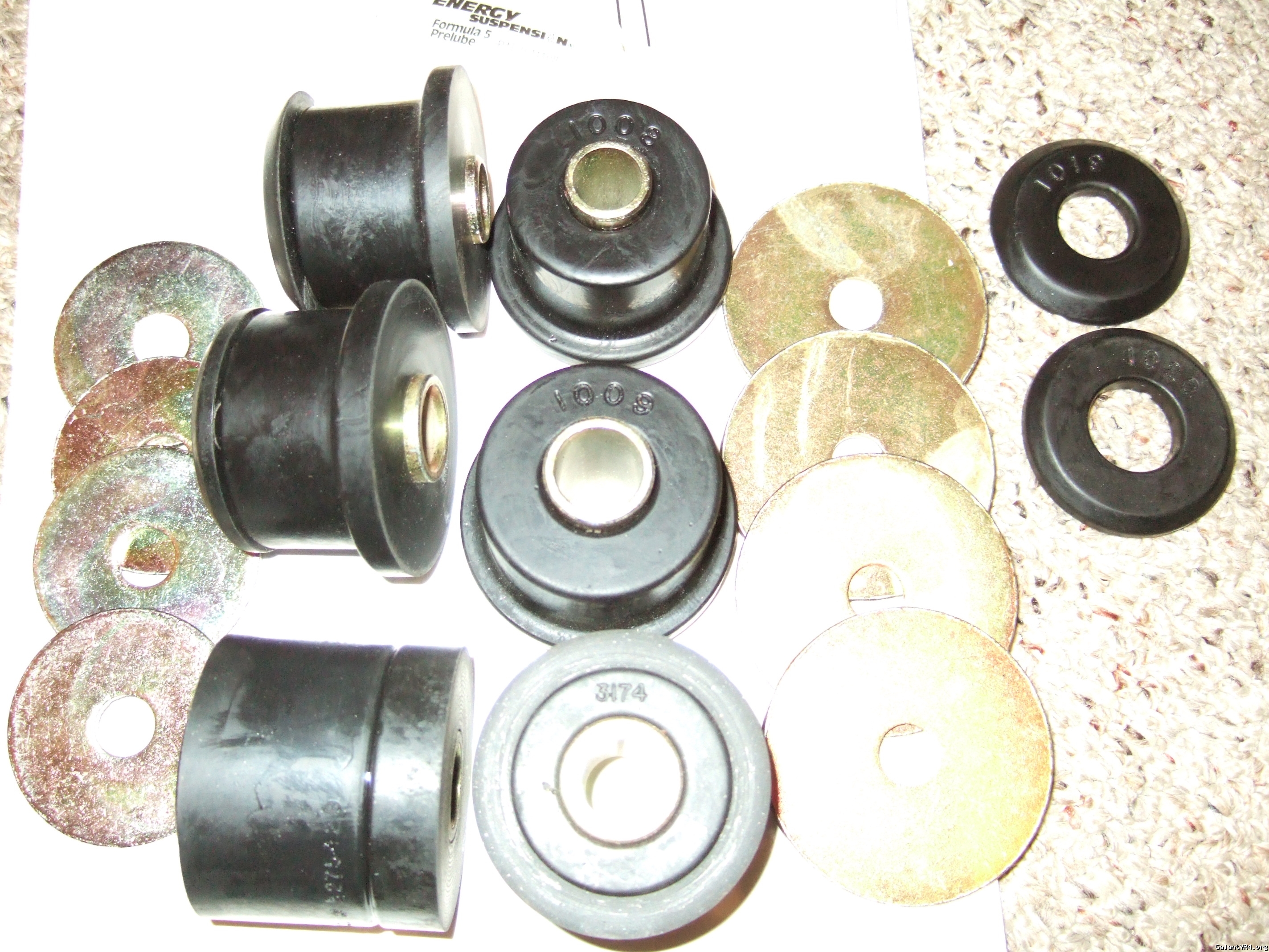

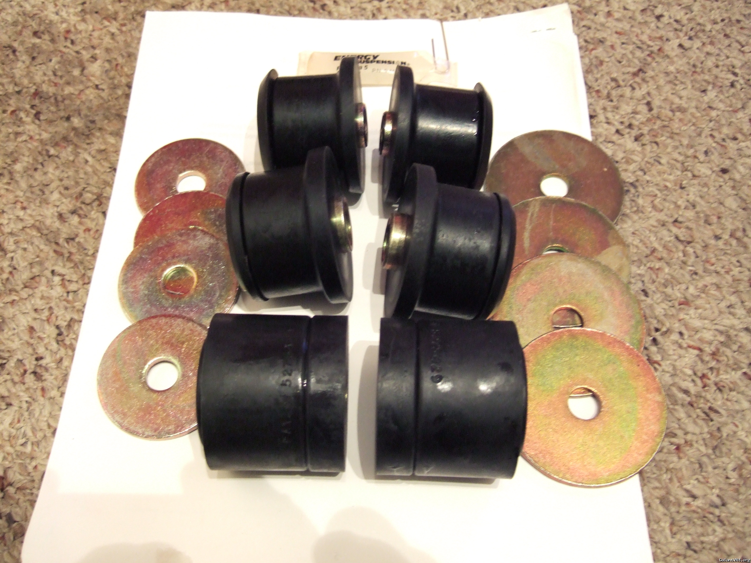

Here's what I've got left:
Energy Suspension bushing numbers read (from top to bottom):
1008
1009
3174
Flat washer-like black pieces on right in second picture read:
1018
1020
Can anyone confirm where these go?
CY - Are there any other numbers on them or do you have the part number that is on that sheet they are laying on? Somethings not matching up.
