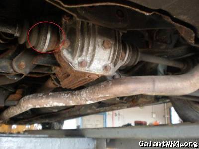

I am having a problem with my driver's side rear axle for my 3 bolt rear.

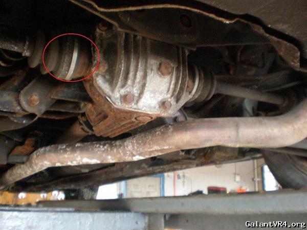

About 2 weeks ago, the clip holding the boot on the axle broke off. (Hijacked pic from someone elses car in this forum attached and circled in red) I secured it with a large tie wrap since I had to go to work.
I then forgot that I had done that. I was driving around and I started getting an intermittent shrill sound from the rear at low speeds like my car was crying.
I found axle grease all over the place.

1. Probably not yet, doesn't flex much.
2. Unbolt axle shaft at wheel side and pull out of the diff. then undo the clamps to get at the inside.
3. You need CV grease. Probably can buy it separately, but I have always gotten it in boot kits. You can get a kit and replace the boot while you are at it. I think I got some from Rock Auto.
4. Have a plug handy to put in right away, even a ball of duct tape or something can work. Jack up the car from the affected side to send the oil the other way.
