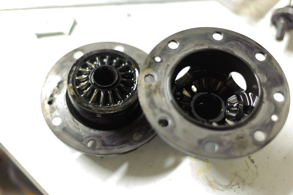

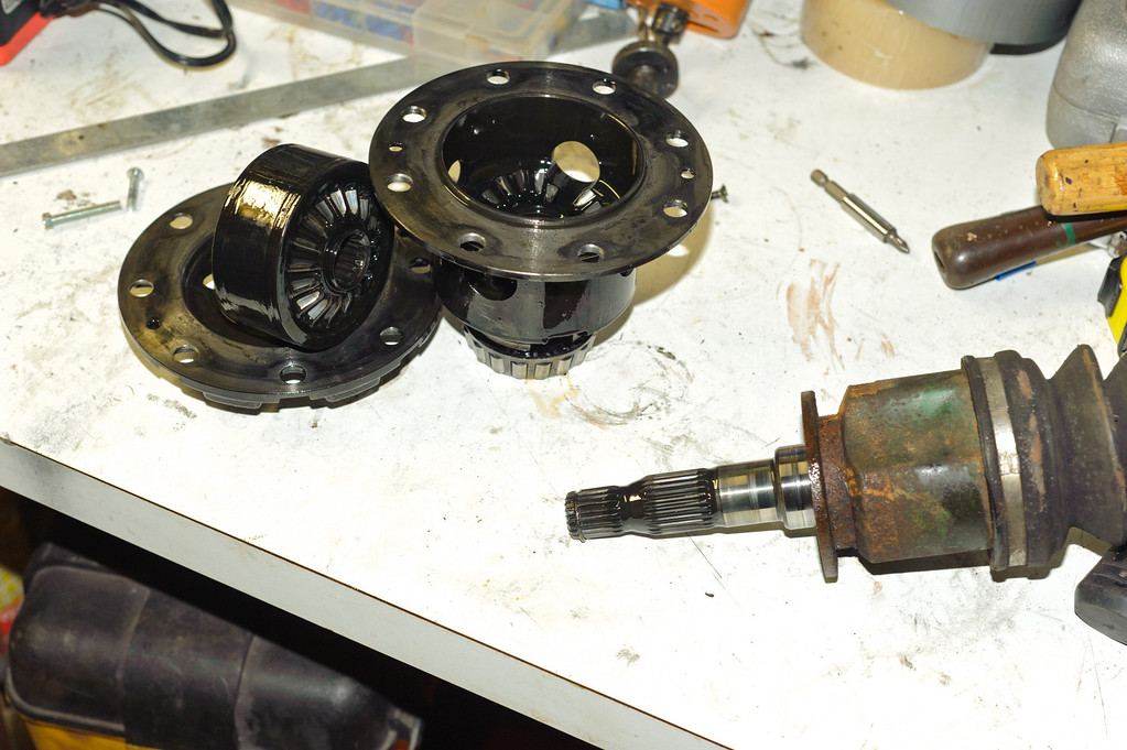

I've never seen or heard of this happening on our cars, but I think my rear diff is shot. I can turn the driver side rear wheel between 1/8th and 1/4 turn before the pass side even engages, and when it does it sounds pretty crappy. If I turn the driveshaft, same thing. WAAY to much turning to engage the wheels. I thought my ring and pinion was all out of whack or falling out so I took the cover off and repeated. All the slack is in the actual differential. The ring gear still has the normal spec play in it from when I set it up a few years ago. I took the diff out, but I'm not even sure what I'm looking for. How the hell does the LSD work in our cars?
Either I'm crazy confused or I have an open 4 bolt rear end.
The housing in my car is the original 1990 3 bolt housing out of Nate's yellow race car. The ring/pinion and diff are out of an EVO 1, the 4 bolt axles are out of some piece of crap automatic that Nate junked like a decade ago.

If both rear wheels are off the ground and you turn one wheel and the other spins opposite direction, its an open diff. Otherwise its some form of lsd.

That's a viscous lsd and it almost looks as if the viscous fluid has come out of the vc sealed unit?
My evo 1 had a mechanical lsd in it as has all of the other ones I have worked on over the years however I am pretty sure Ralliart offered a viscous unit that was a rare factory option if memory serves me correctly.
Hmm, I'll have to clean up that one side spider gear, I could swear I couldn't figure out a way that thing would "slip" but it's definitely big enough to contain the VCU
What makes you think it leaked?

It almost looks like there is a film of black viscous goo coating your internals however it's hard to really tell from the pic either that or you have some seriously dirty gear oil /ubbthreads/images/graemlins/smile.gif

That viscous fluid feels like a real thick grease almost and usually won't just wipe off with a cloth rag either so it should be easy to tell it apart from the gear oil.

Well the spider gears had like .1" of play in the feeler gauge spot, it's supposed to be .03"
I also took this time to tighten up the backlash, I had about .012 and I had enough random shims from other rears that I got it dead nuts on .008
I've never seen a mitsu rear end wear out the diff like that, I don't even think I recall anyone here ever having any sort of issue. Weird.
Well there you go ladies, a clunk noise from your rear could very well be your spider gears about to eject themselves from the carrier.
