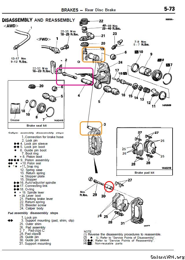

I removed the caliper and inspected the guide pins since that appears to be the source of the movement. The lower slide pin and bolt (pink box) sits in a rubber guide pin boot and seems to be specifically designed to not be tight in its bore because it has a boot between it and the metal it slides through. The upper guide pin (red circle) goes into a hole in the body of the caliper (orange boxes).

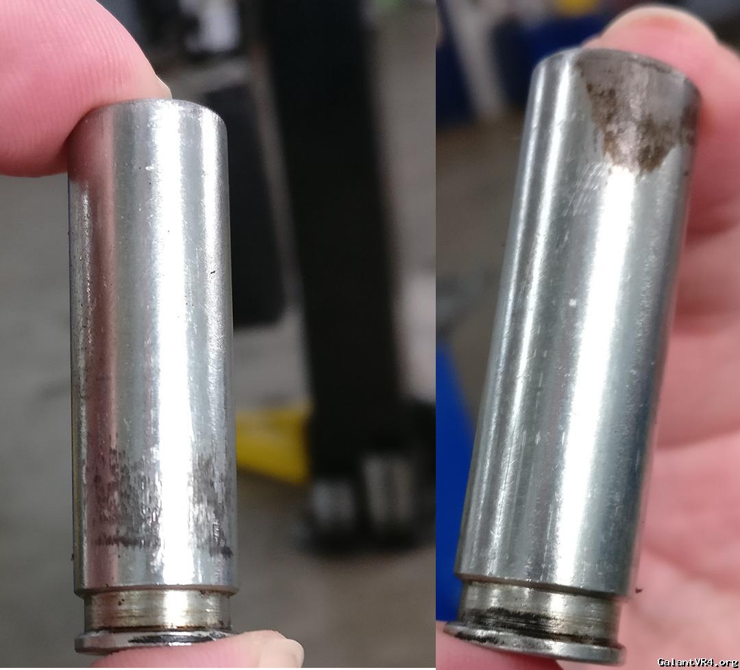

The one I removed from this caliper had wear marks on it from just 60 miles of driving, pictured here:
This appears to be the problem, the upper guide sits loosely in the caliper body's hole, allowing for this movement. Searching around I was able to find some threads on the DSM forums mentioning a similar issue with the rebuilt rear calipers. Some speculated that during the rebuilding process too much material is taken out of the hole by the rebuilders who are wire-wheeling rust out of the hole. Unfortunately the solution for most at that time was to buy a new caliper instead, but that was years ago when you could still get them. In a desperate attempt o use this caliper I first decided to try a few different guide pins, hoping they are different diameters. Measuring with calipers I found that they do vary by brand, ranging from 13.76mm to 13.89mm (worn one was 13.81mm). I tried the biggest one I had with a bunch of fresh grease, but alas, it was only a minor improvement on the range of movement.
