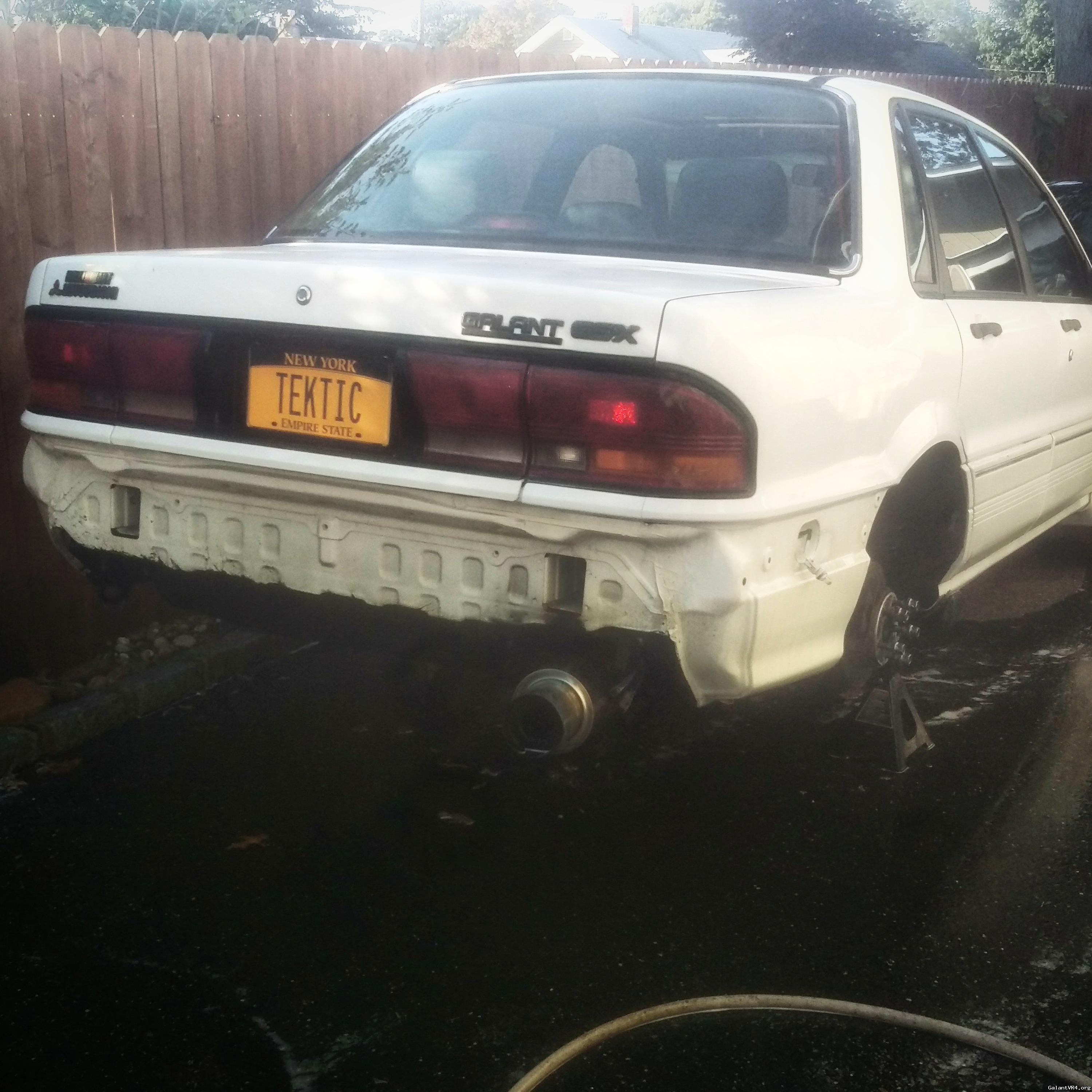

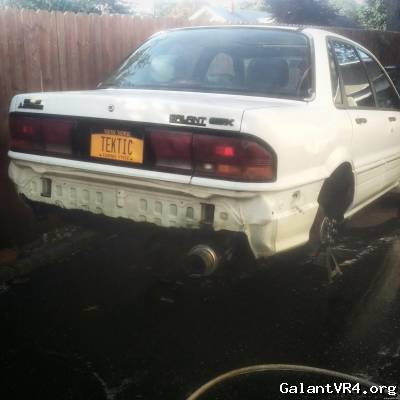

I've seen the aluminum mod, but what have people done to trim down some weight from the stock steel junk? I'm not sure how to attack it. It seems feasible to loose 20lbs and not risk loosing rigidity and support and safety. Please post pictures if you have them. I have my cut off wheel idling!

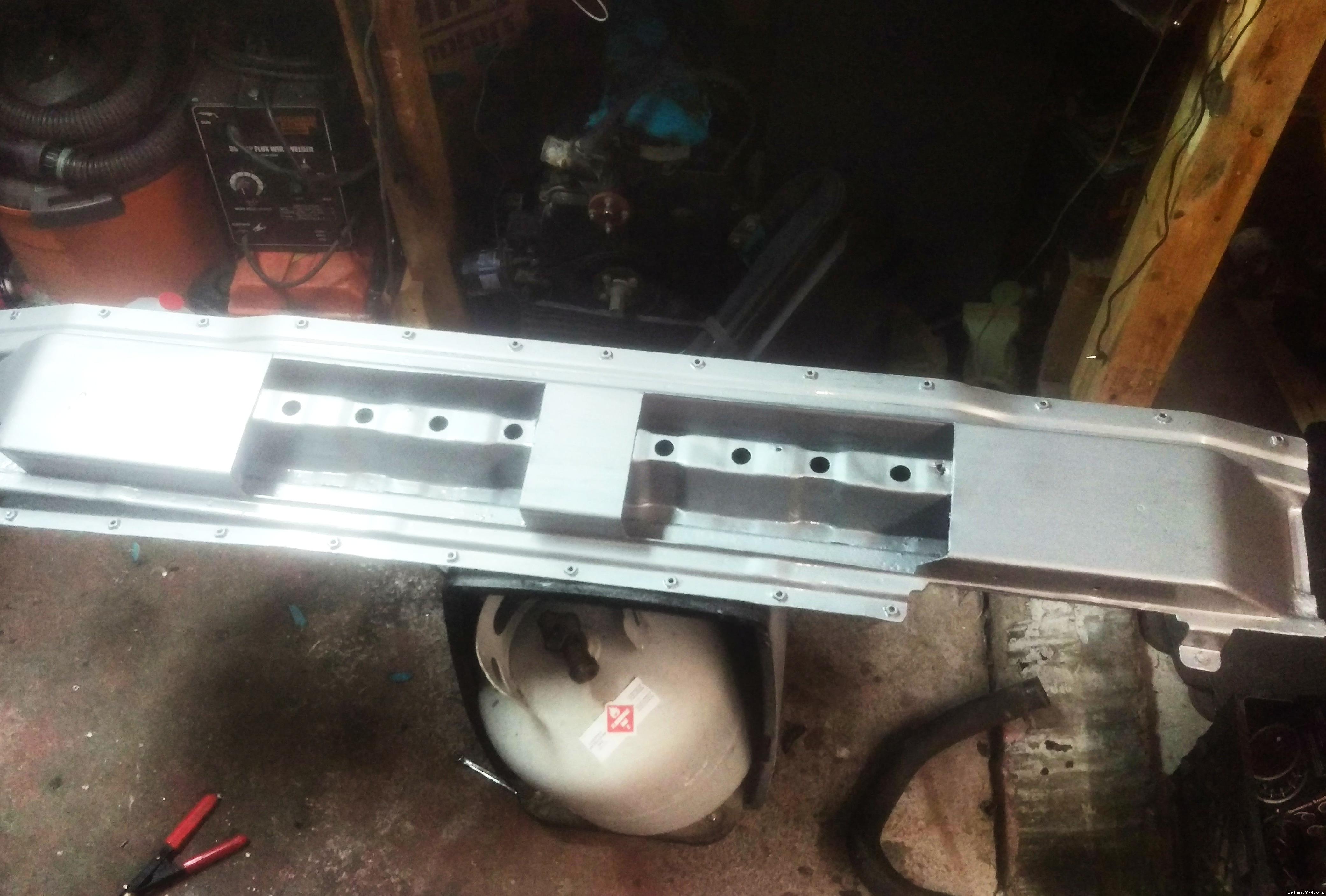

I cut the part that hangs down above the tail pipe off and these two blocks. It turns out the inside was all rotten so I'm coating it with rust bullet after treating it with acid. So its 6-8 lbs lighter and hopefully won't continue to rust. I could of kept cutting I suppose, but it was taking too long.
