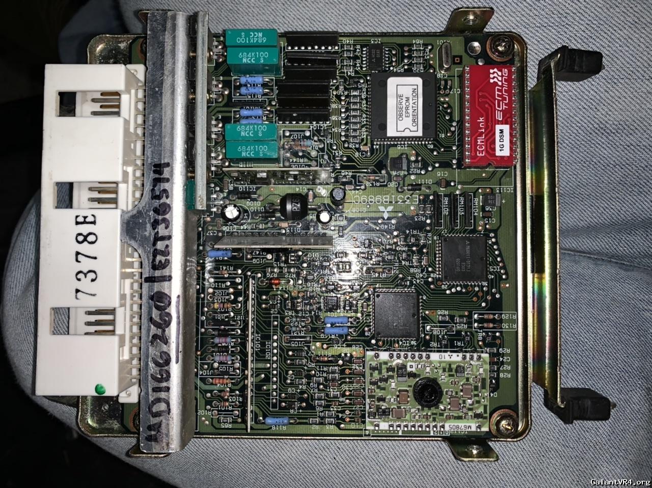

I keep getting random shutdowns with 733. It happens sometimes when in idle, sometimes when driving.. it's very random. When driving, I can feel the car slowing down and no matter how much gas I press, the speed drops on its own until it turns off (or if I put neutral and drop the clutch it goes straight to 0). It starts back up right away, but I want to get to the bottom of this.
This began happening after I switched to an Odyssey battery and was missing my lower intercooler pipe, but ever since then, I replaced that battery with a bigger one I previously had and found the ETS lower intercooler pipe. I would begin to see the battery/brake lights dim on from time to time so I knew my alternator was acting up and got one from Motorcity Reman had it installed Saturday so no more lights on the dash.. but the problem persists. I have also replaced the coolant temp sensor for a new OEM one but still no luck, Is there anything I can check next? /ubbthreads/images/graemlins/banghead.gif

I'd check and make sure the battery ground is clean where it connects. Near the stock air box location. I think the ECU has a ground too. One of the bolts that hold it in.
Check ECU....
It sounds like a connection issue, but with the age of these cars.... They can cause mysteries.

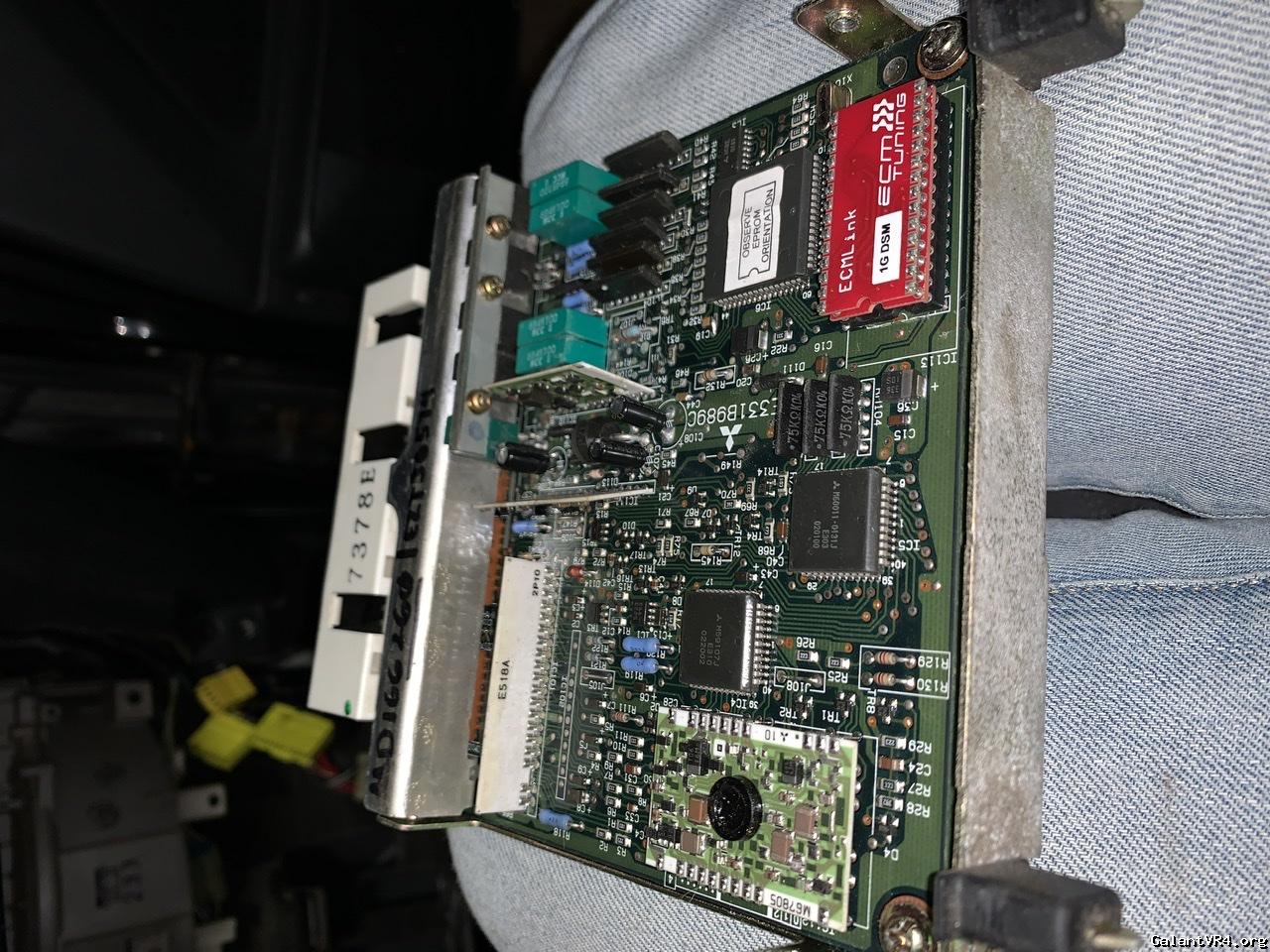

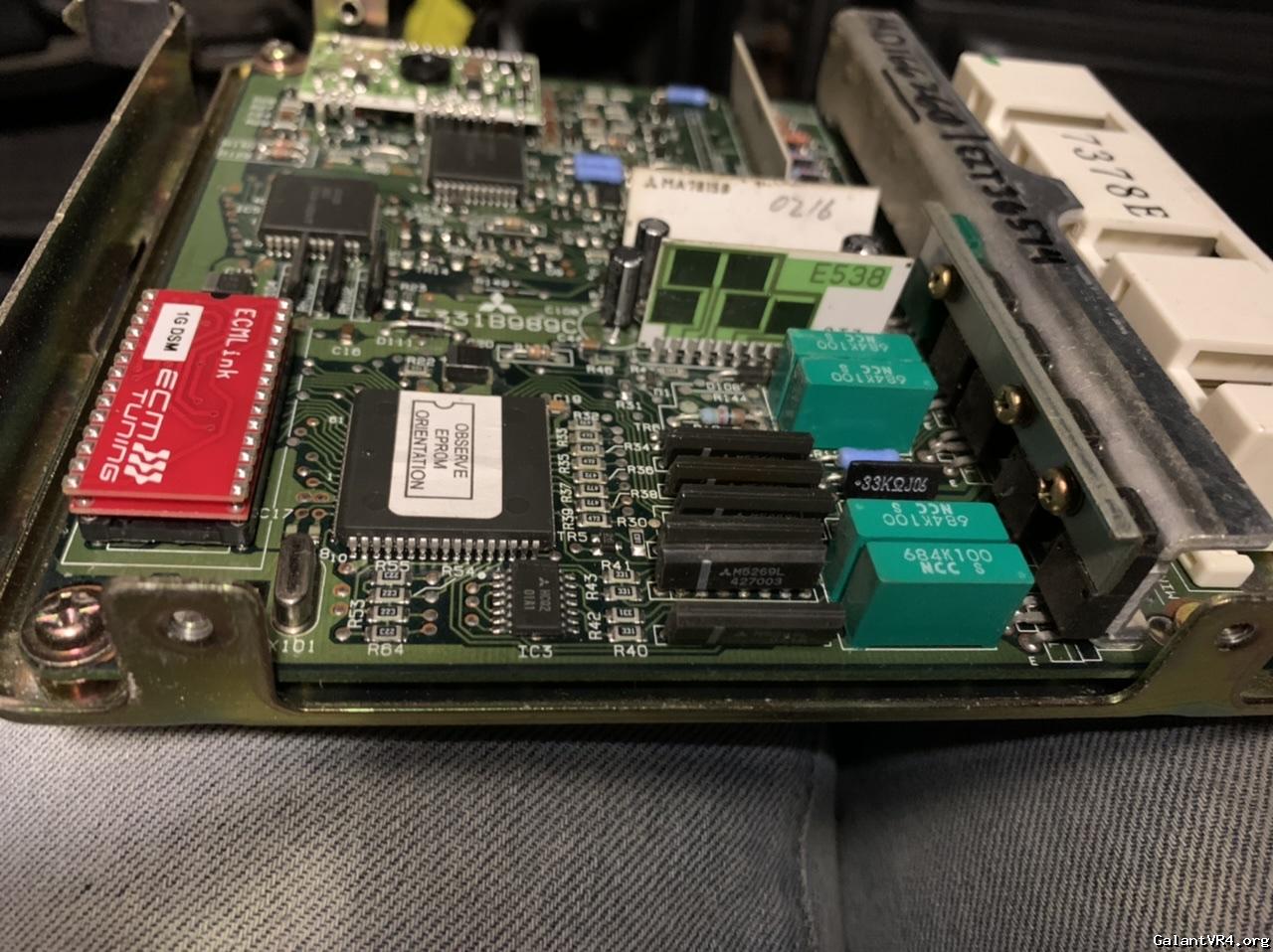

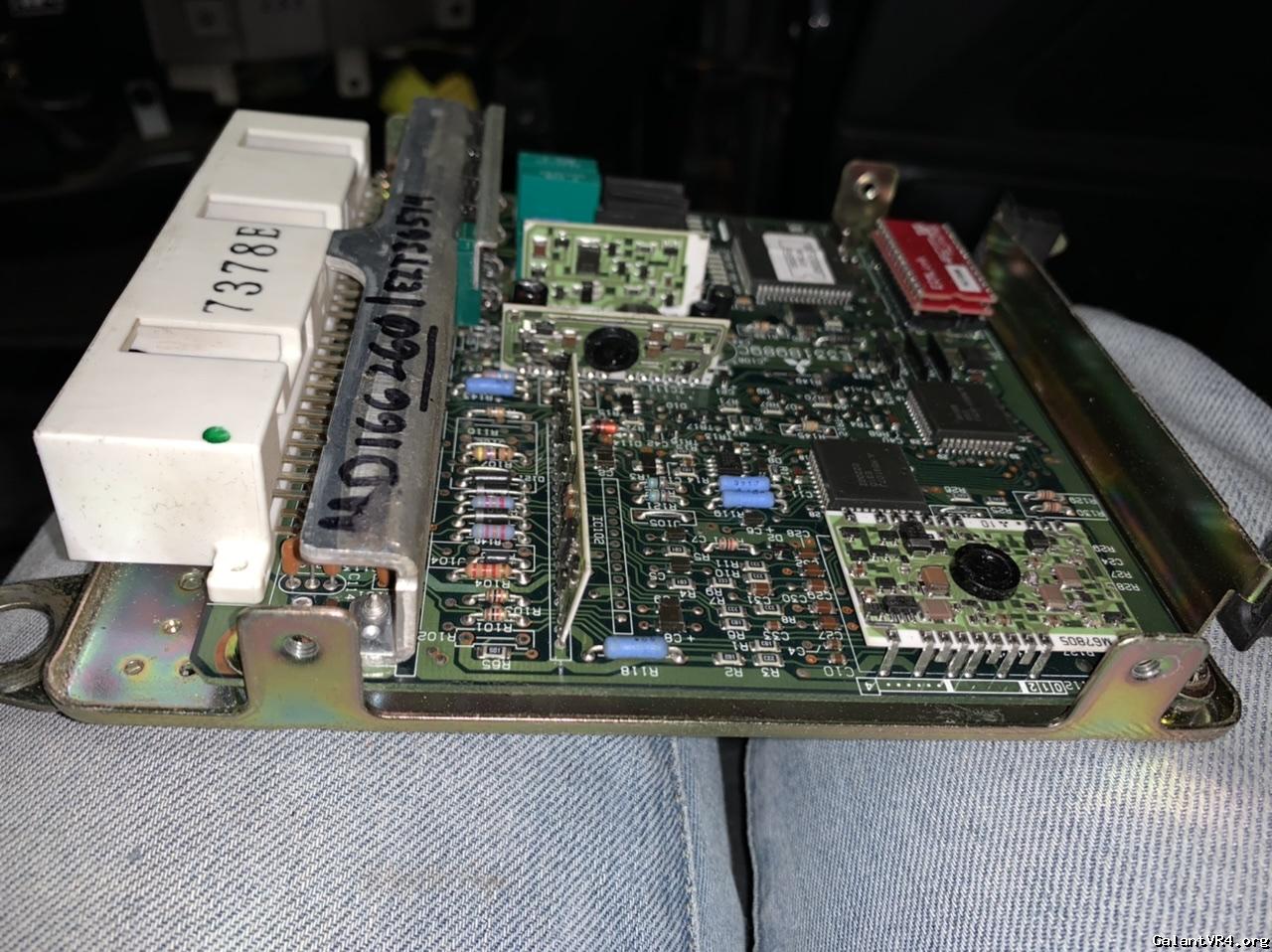

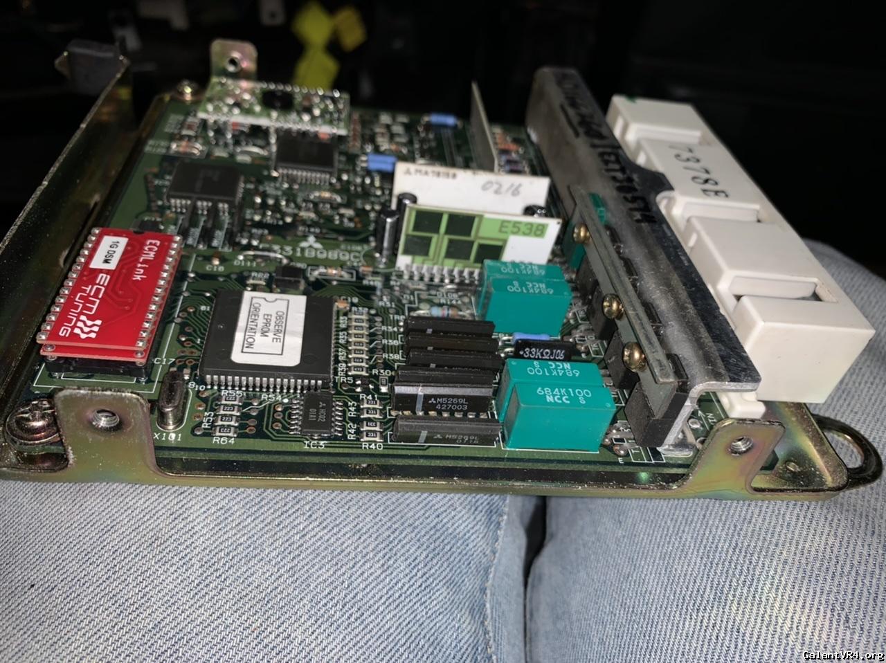

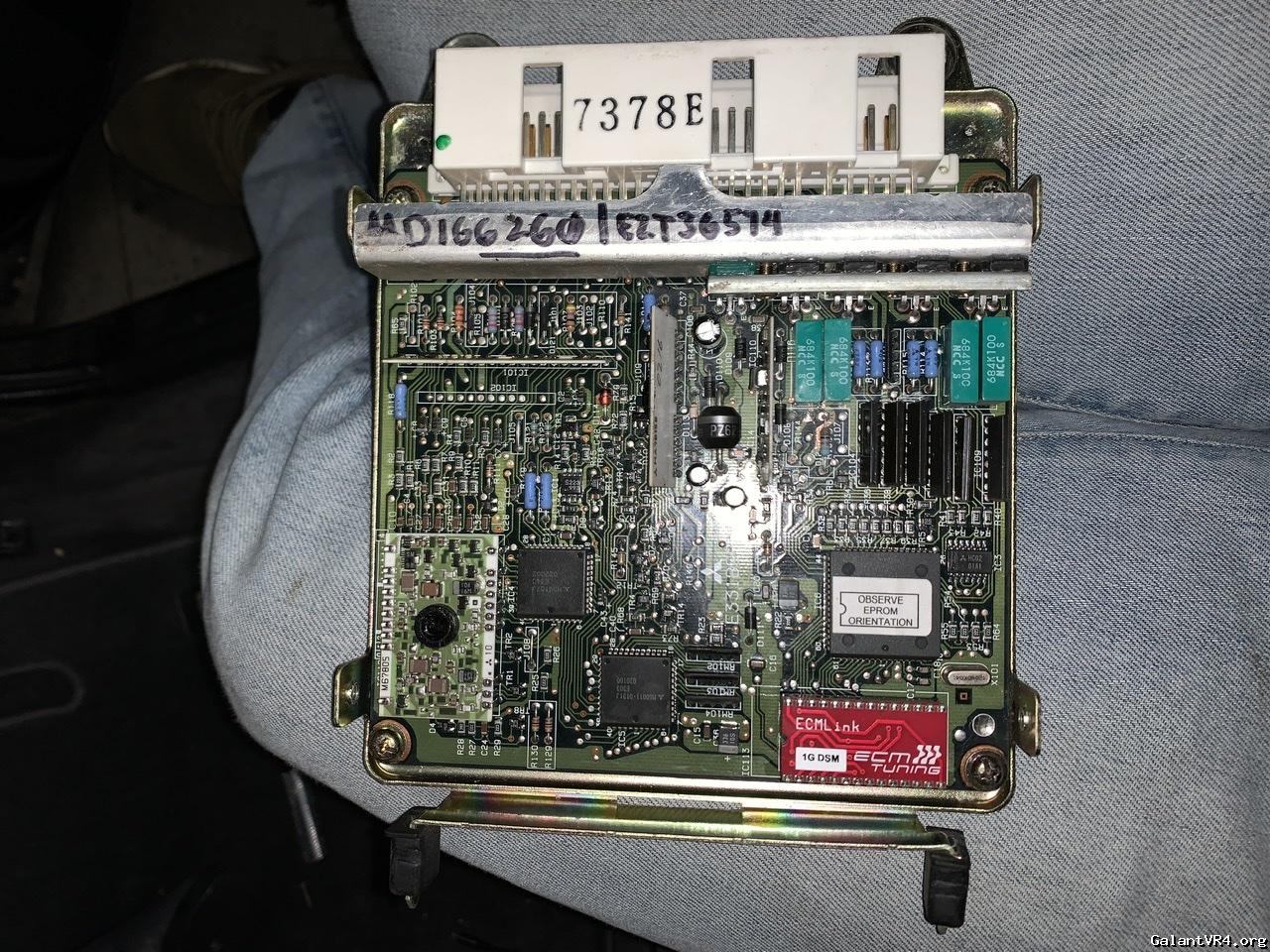

im gonna have to third the idea of pull the ecu, sounds to me like you have a dead ISC motor and it burnt out your 102 or 105 diode, i forget what one it is.

Make that a 4th. My ISC motor leaked into it's plug and took out the diode and the controller on the ECU. ECM Tuning fixed it right up
