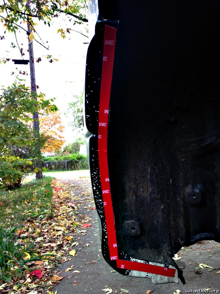

Here's the rear with the 3M, i trimmed the inner edge to clear the muffler on this side and did the same to clear the fuel filler hose on the other:

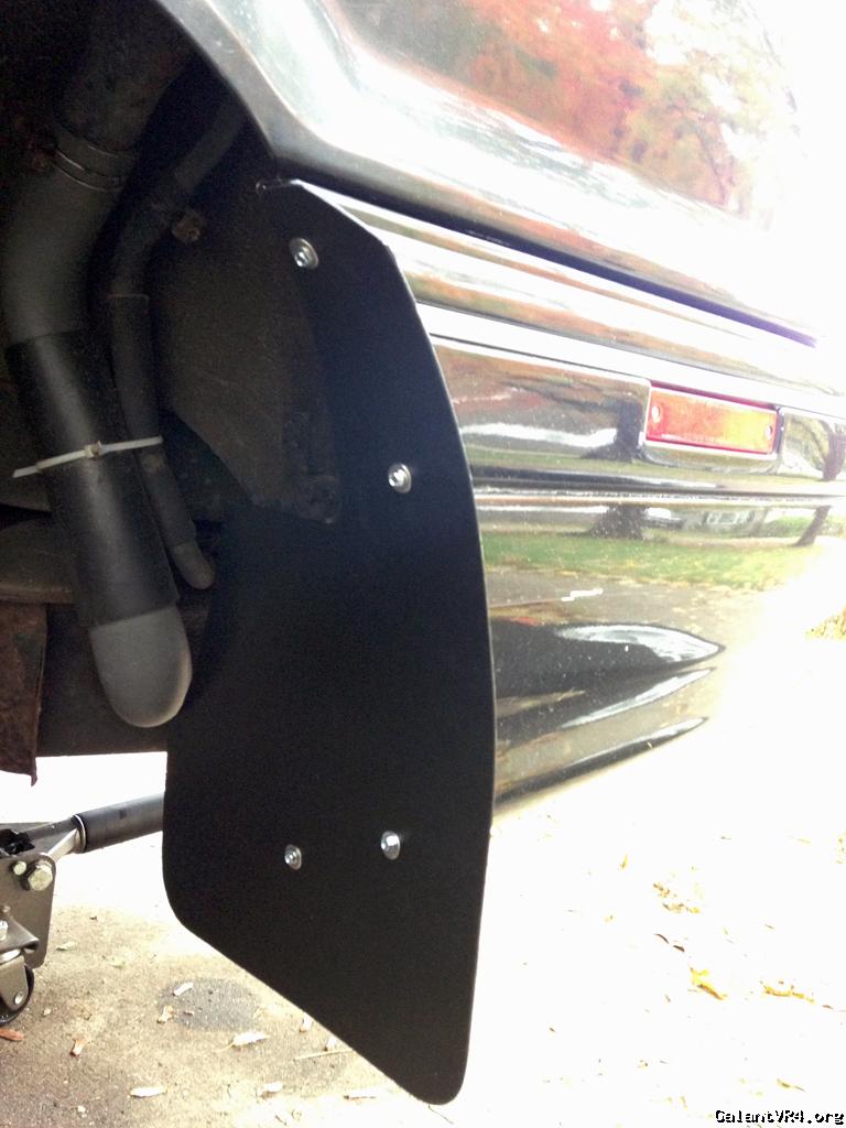

here you see I used 4 self tapping screws on each flap, i wasnt exact about how i spaced them but i kept it all pretty consistent.
I jacked the car up so both sides sat level, then used a level across the bottom of the mud flap, if you dont do this, you'll wind up with funny angles on each corner. this is where the double stick tape really comes in handy, get it level and stick it on, then attach via screws

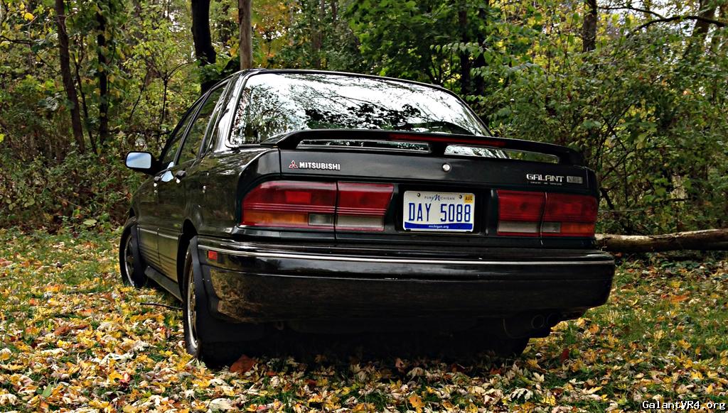

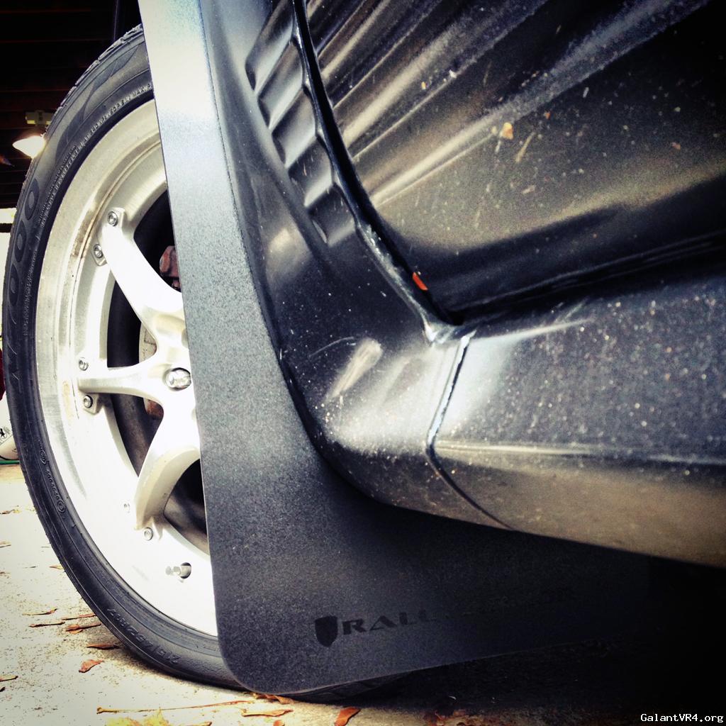

All done and snow tires mounted, ready for the sh*t storm.
