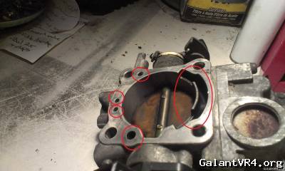

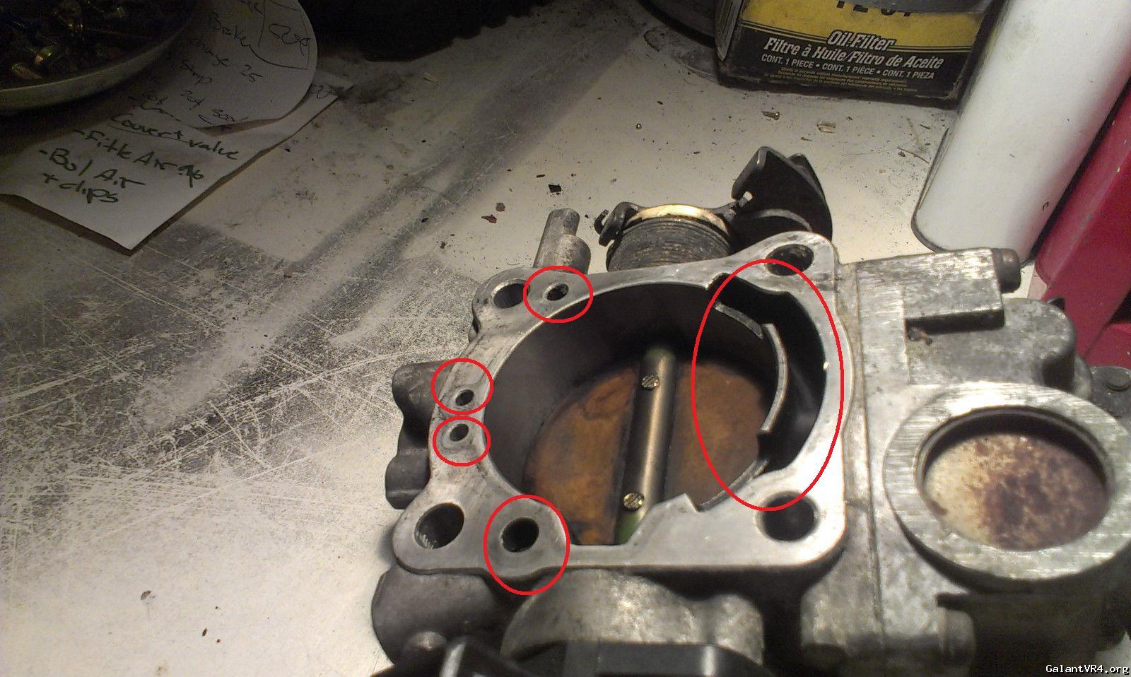

I need to know what all the ports in red circles go to. I was looking for a diagram showing what ports go to what, but no luck. When I mounted my throttle body to the new Magnus manifold, all of these were blocked off by the Magnus manifold flange and gasket (all but the large lower cutout type port). I'm wondering if one of these is needed bypass air at idle?
My real issue is my car wants to stall when the throttle is closed. It idled perfect before the Magnus was installed, so I'm sure the throttle body itself is good. The TPS was calibrated and is good, as is the idle switch. If I bump the throttle open just a bit, the car will idle fine, it just seems like its not getting enough air at idle. I will adjust the biss if I have to, but before I go screwing with it, I want to make sure I'm not missing anything.

The three small ones lead to the nipples on the top of the body, the big half moon on the bottom is for the IAC and FIAV ports, the medium port in the lower part of your pic is the BISS port.

I doubt it, then you would not be able to set your base idle. Is the manifold you have flanged for a 1g TB?

All those ports are blocked with an OEM gasket. The OEM manifold has no holes. I think the holes are there for machining purposes only.
Far counts on the ISC I believe are 0 to around 120, I know I've seen 115 during WOT, so I'd say around that point. 30 is your goal at idle.

No, I don't think anything is leaking. Reason being, this TB worked great before the Magnus install. I actually have the opposite problem of a leaky throttle body. The car just idles way too low. I thought that maybe a port that should be uncovered was covered, not allowing the proper amount of air to bypass the throttle plate at idle. You confirmed all those ports are normally closed up, so it looks like I may just need to make a BISS adjustment.
