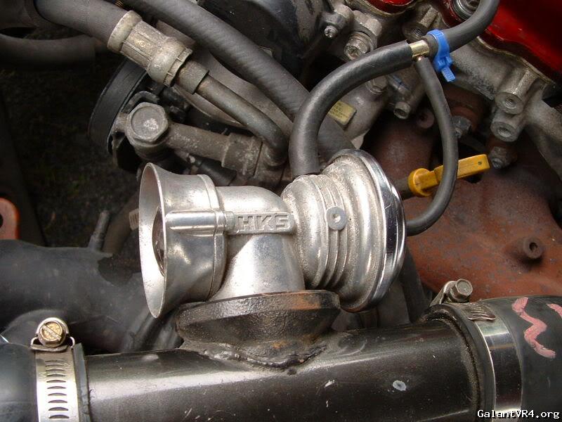

just an fyi, the pic is not of my bov, and i dont have a vacuum line hooked up to the port in the rear- that is busted off. just used the pic for reference purposes in id'ing the HKS bov

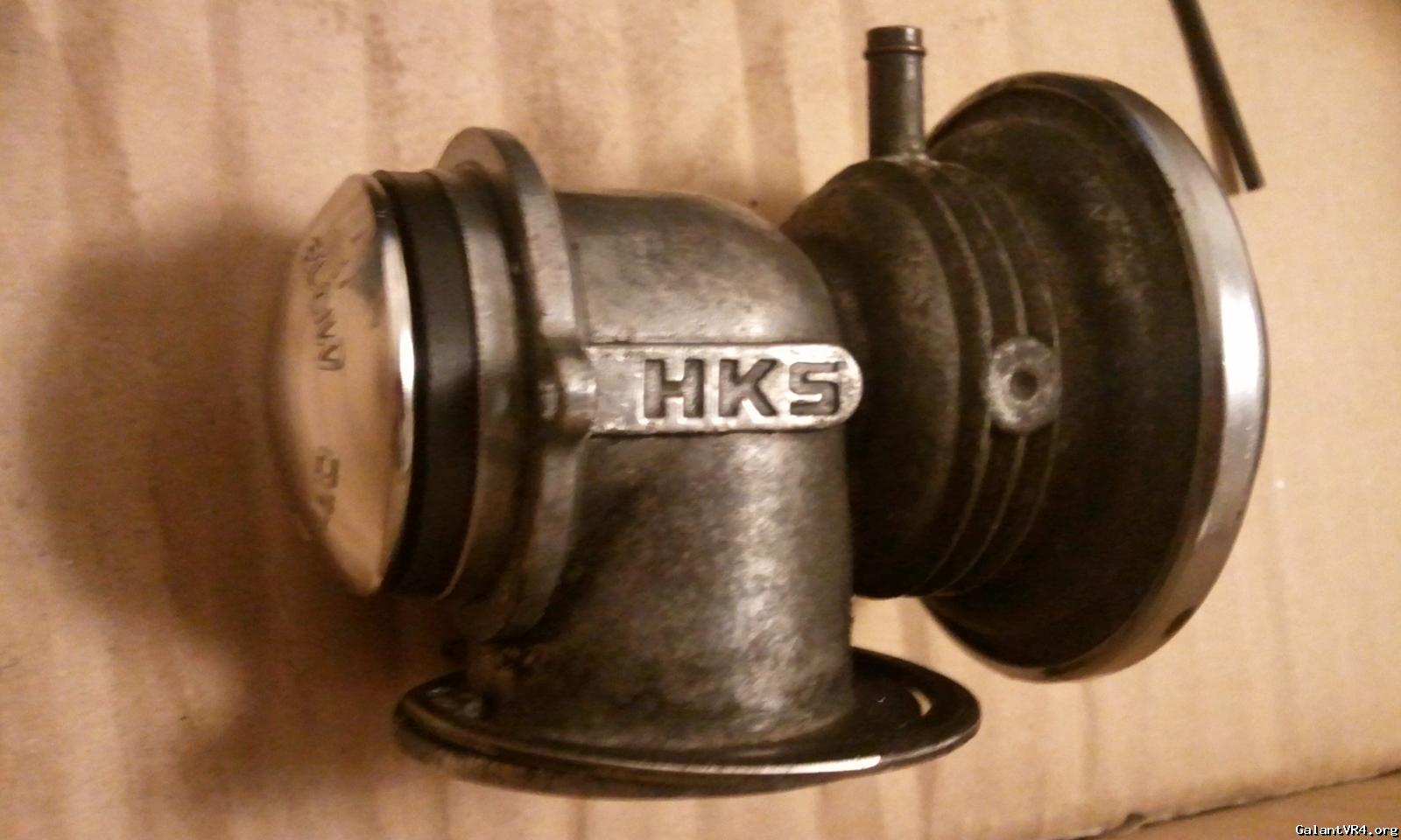

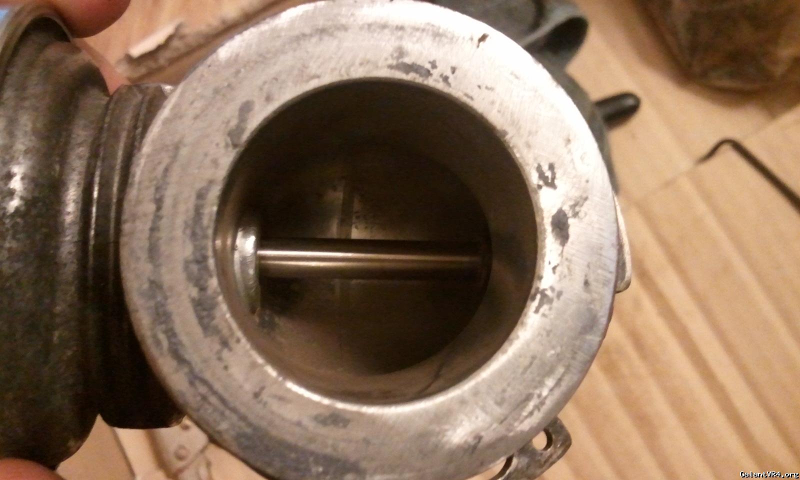

well i took her off, and tried to clean it...not much to clean. it's not one of those that you can take apart and lube up. i hit it carefully w some brake cleaner and wiped her down. what do you guys use to seal it to the pipe so it doesn't leak?
what it looks like with the horn/hood off
is it just time to get a SSQV?

There isn't anything I know of to clean. As long as the diaphram holds vacuum and the piston is spring loaded shut. Is the seal behind the piston cracked anywhere or really hard? It's been a few years since I've had on apart, but it should still be firm rubber IIRC.
