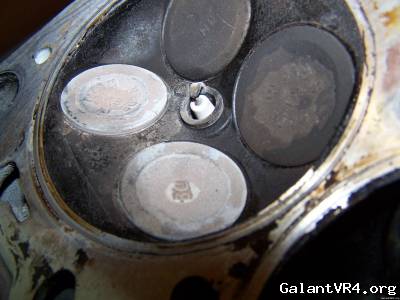

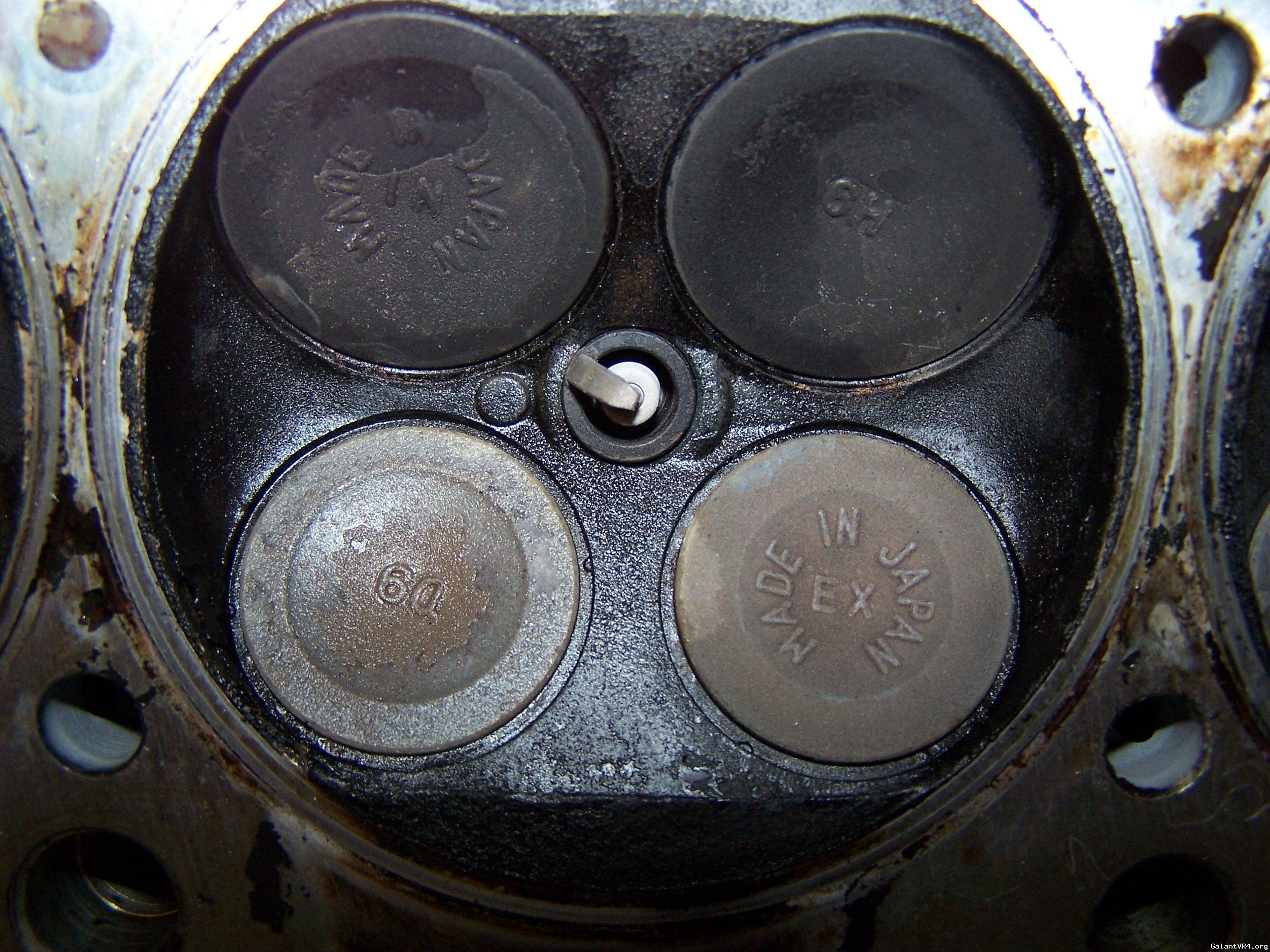

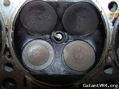

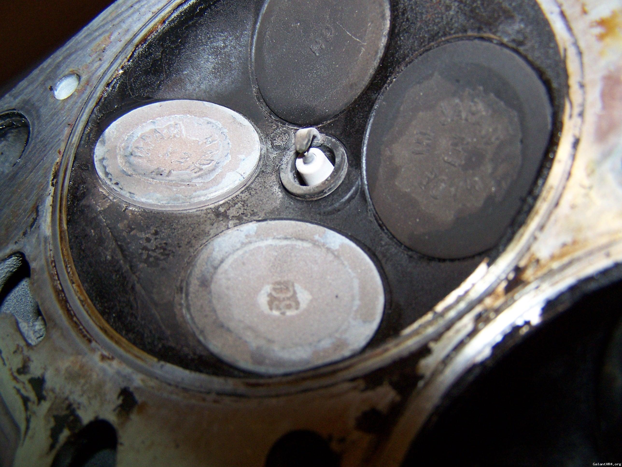

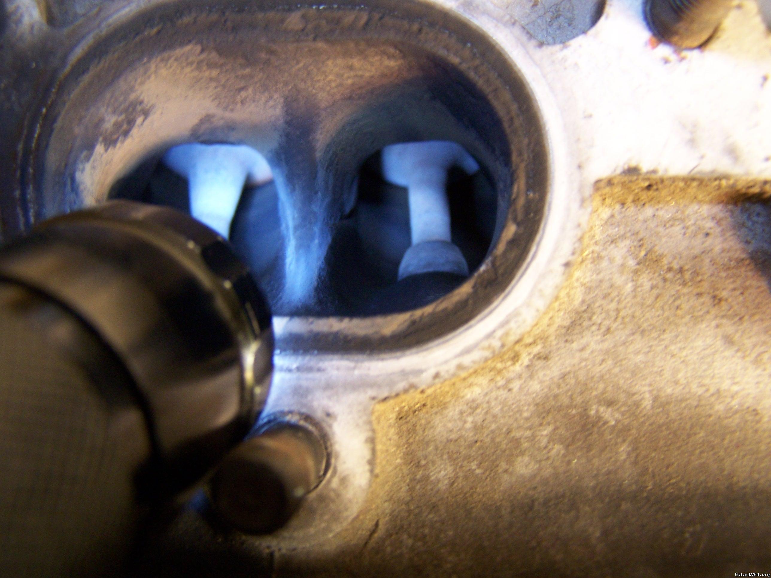

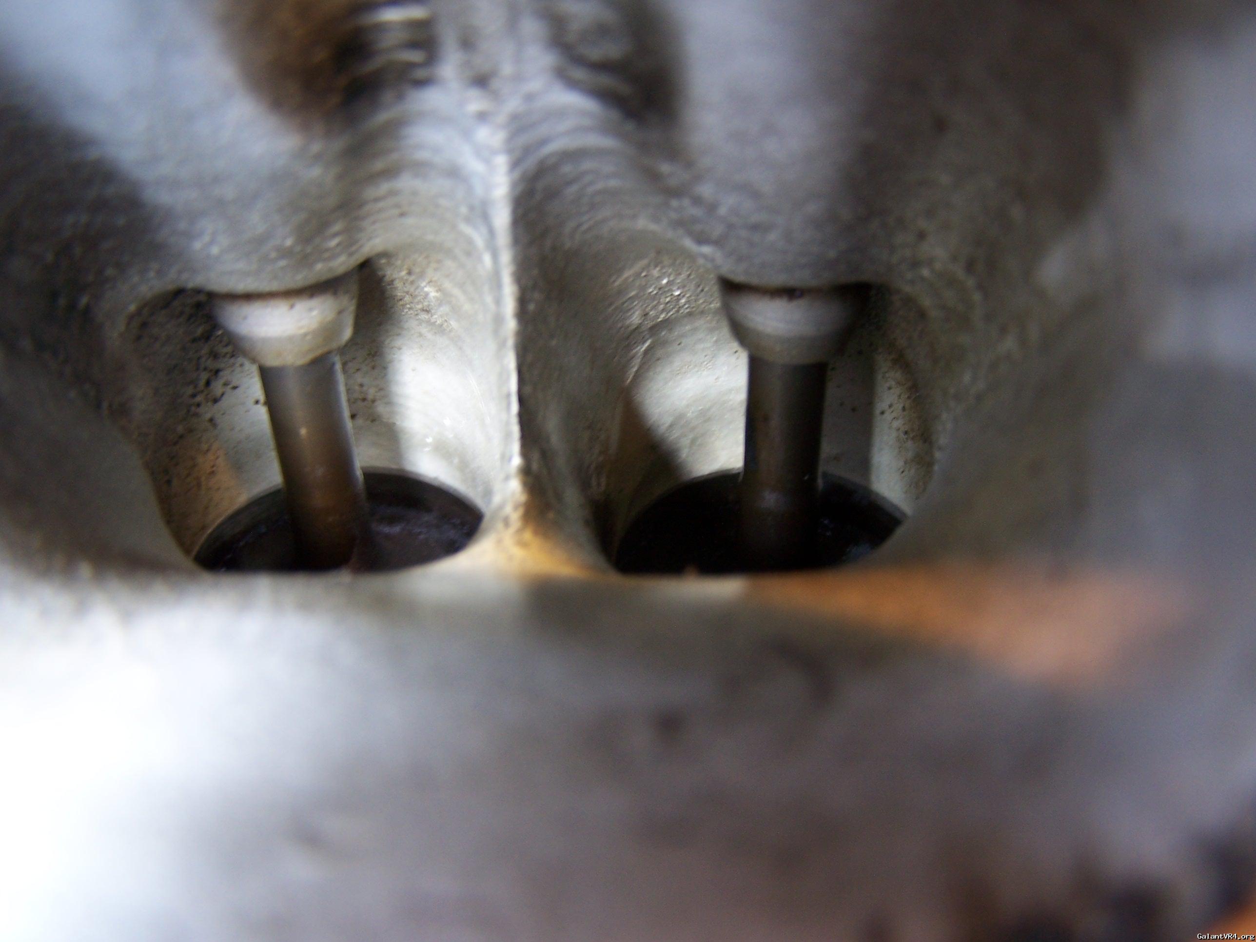

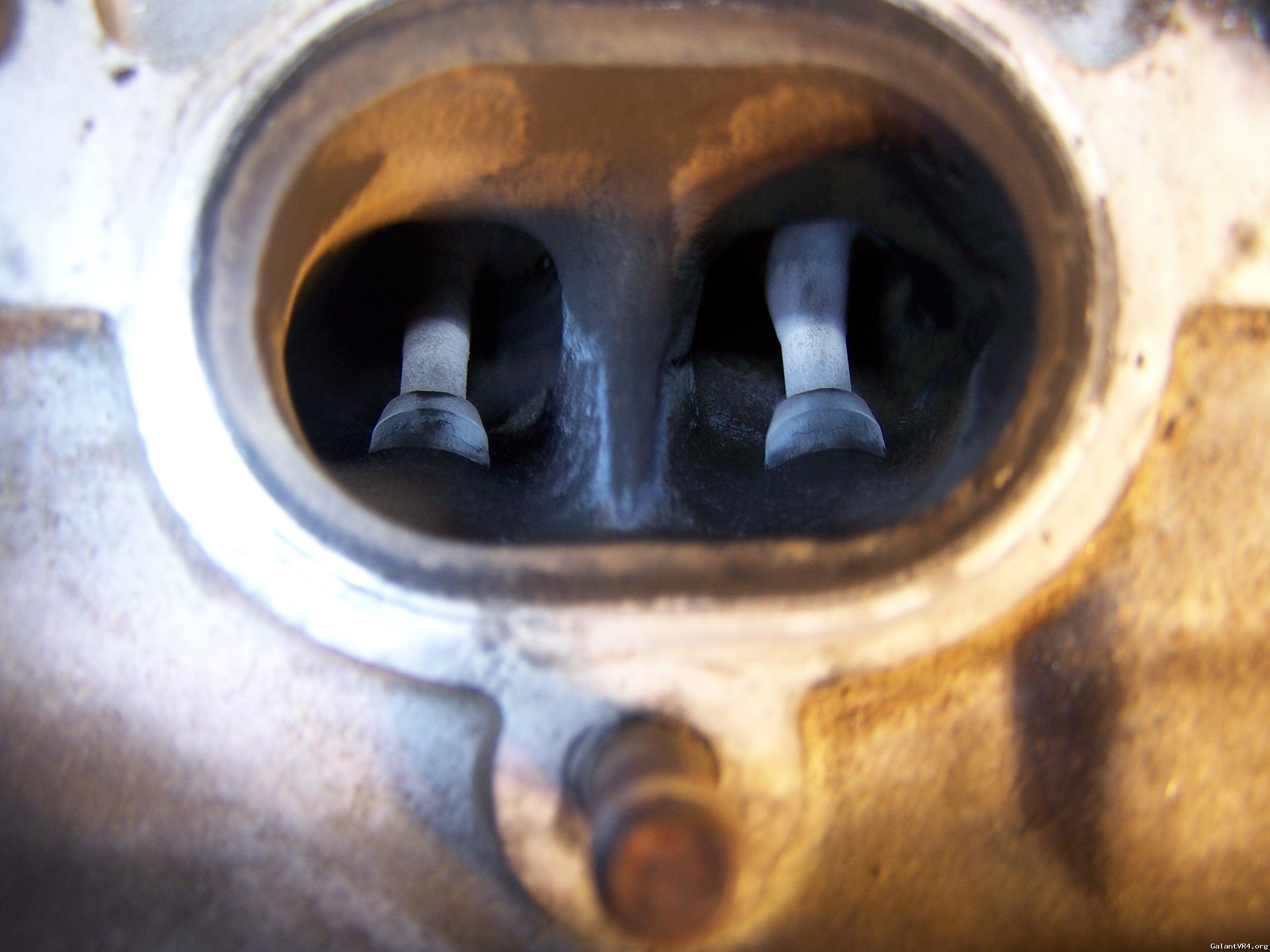

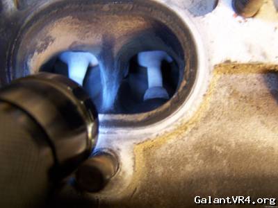

Well ive been having problems with pushing coolant and thought it was the head gasket. After pulling the head for the first time since i bought the car i found a 3 layer mls blown out into the water jackets on cyl 1,2 and 3. Anyways i found it has some porting on the intake side, and also had two different valves. It had some stock valves and some Beck/Arnley valves (found out by looking on rock auto). Anyways im worried having two different valves installed. They look a little different on the stem thickness and how their designed overall. Should i just buy some new valves, just replace the last couple of stock valves (2 intake, 4 exhaust), or just leave them. Im going to have a valve job, valve seals, and guides installed.
In the pics you can see that the valve stem area is wider and a different shape than the stock valves, also the valve face that says made in japan sits higher than the stock valves. You think it effects anything?
here some pics
personally I would replace all the valves, stem seals and if guides are worn then replace them as well. better to do it now while the head is off than to have to pull the head off again in a couple of months because stem seals are leaking or a valve has burnt out.

Yeah im going to get some new valves, i guess ill just have to wait another week to get the head off to the shop. Anyways i noticed that the head looks different than my 1g head. In the combustion chamber there is a protruded cylinder and on my 1g there is not. Also the coolant jacket holes on the 1g have slots on the intake side and on my head they are flush. Is the galant head different?

The valves should be fine even with a poor man's water injection, but the machine shop can check them for you.

I'd ask the experts as well. No sense in replacing parts that can be cleaned up and work like new.
