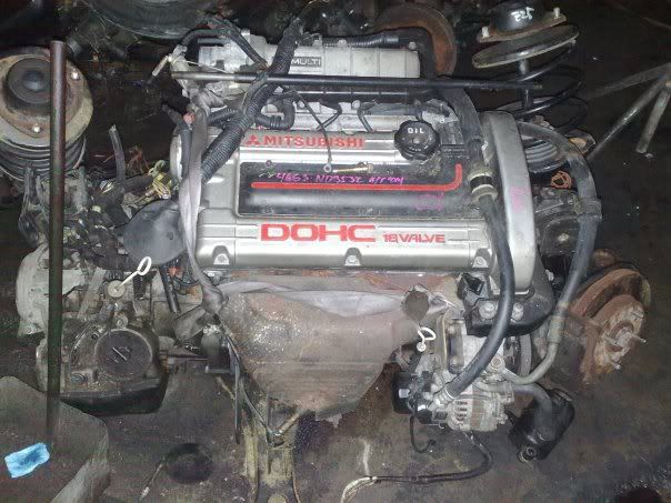

oh ok, sorry about that, I meant prep in a like, of course it wouldn't be a good idea to just mount it and start it up, as mentioned earlier its been sitting around for awhile, although when it was taken from the car as a whole unit, it was just literally lifted from the engine bay and shipped, that's how the Japanese engines land here in Manila. (not my actual engine)
So I was thinking if there was a way I could make sure that all the internals are lubed up properly before
starting up the motor, cause most of the oils would have probably settled by know leaving all the galleries
and what not pretty much dry. I just need to get the car running. I don't really have the time and budget
to open it up and go at it thoroughly, although that would be the best way to do it of course, and I would
gladly do it if only I could.

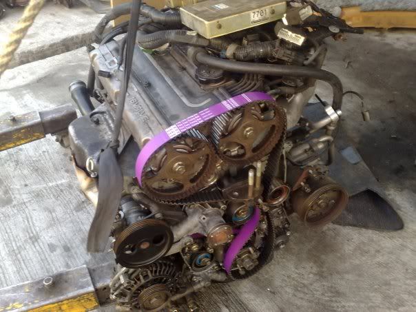

If the motor is sitting out of the car it wouldn't be that difficult to pull the timing cover off and hook an electric drill to the oil pump to prime it.. just be sure you get the balance shaft back in phase before you put the belt on.

From experience with a used motor, you should replace the timing belt. Mine ripped after a few thousand miles on my Used jap motor. first replace the oil, then While you have the timing belt off connect a drill to the oil pump and just let it spin at high RPM for a few minutes just to be sure the oil is being moved around inside. once you have the belt re-installed, before starting let the motor pull the EFI fuse and disconnect your coil plug. Let it crank a few turns before reconnecting everything for startup. Then start it back up, It will most likeley smoke for a while if the valvestem seals are dry but other than that you should be good.
