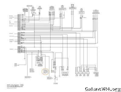

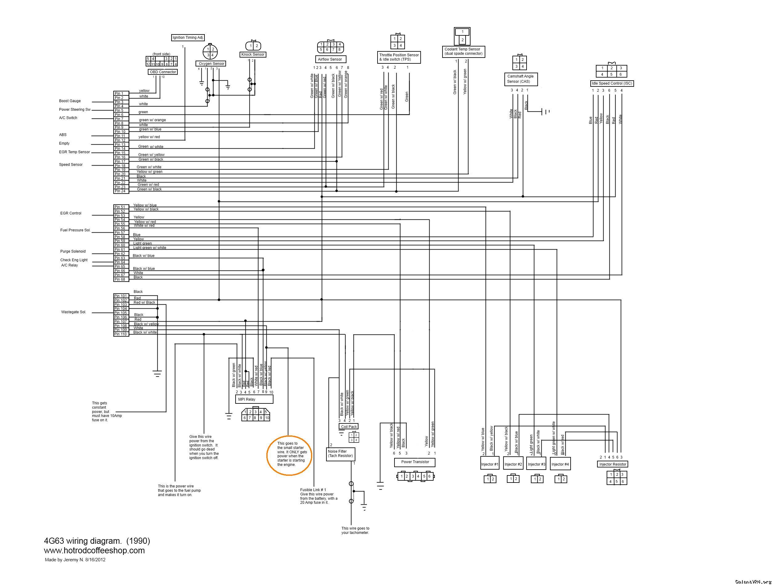

So i had a wire powered that should not be powered while running, apparently while cranking this wire should get power, my guess is that i've been driving it with the ECU thinking it's "cranking" to start! /ubbthreads/images/graemlins/banghead.gif /ubbthreads/images/graemlins/rofl.gif
see the orange circle for the wire i had switched 12v running to, when the car was running this wire was getting 12v and it shouldnt have been, now i get mad timing! /ubbthreads/images/graemlins/devil.gif
